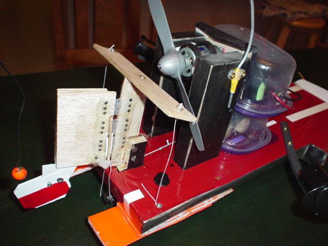

Just received my Donald 4 Seaplane kit.
While waiting for the kit I used the guts (motor, circuit board servos) from an
Aerobird (RTF) to make a air boat for a possible Donald 4 retrieval form shore.
If I land in the center of a lake and lack the power to taxi in...my plan is to
use my trusty marsh boat to circle the plane with tethered flyfishing line (line
floats on water with attached bobbers at 3-4 feet intervals) Then slowly pull
the Donald back to shore. (I may also be able to just push the plane in directly...??)
Anyway, I finished my home-made air-boat and it handles great and has a run time (7.2V NiMH) of around 20-25min. I’ve enclosed a picture of the "Rescue" craft.
PS Notice the "dual tupperware" chambers, one for the NiMH battery and the other for the servo/circuit board. I've never had to "BURP" a R/C
craft before....
--Kevin

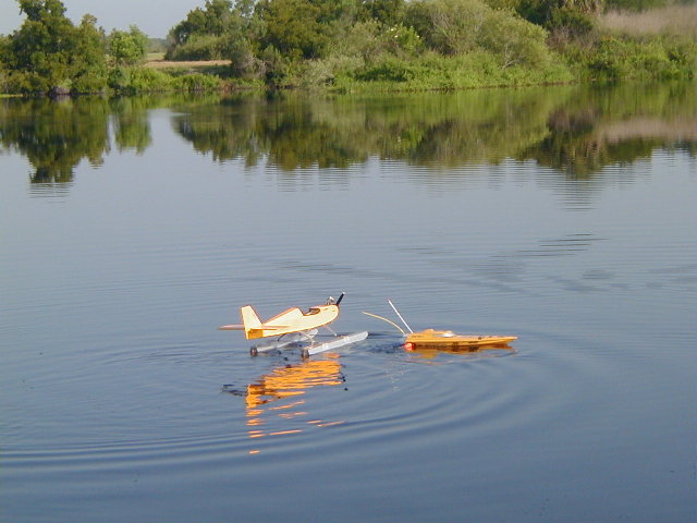

Hi Kevin4,
Your retrieval craft looks promising. We built a couple of flat bottomed barge type hulls from RCM plans back in the early 70s and had a ball putt-putting around the farm pond sitting under an oak tree sipping cool ones while the 30 min epoxy was drying back at the house.
I started to lay out a barge type of hull, but this time instead of air props, I figured maybe an inboard E-Motor with Forward and Reverse control. would be better. Forward would get it out to the plane, and Reverse would allow it to back in between the pontoons. I figured to secure a long stiff wire off the stern with a hook and a one to two inch hook on the end. Back in under the nose until the hook hit the pontoon crossbar. A little more power would cause it to ride up and over coming down behind it. Forward motor would snug it up and then the plane could be towed in. Sounds feasible but I have no experience with inboard E-motors and submerged props. That calls for a little more investigating unless some guys have some rhoughts on usable motors and throttles and such. Maybe Hobby Lobby is a good place to seek help.
Kevin,
Cool job on the boat. I hope it works for you.
R/C Boats "sound" like a good idea but I think Grampaw hit on some of the "challenges" to resolve.
1. you're working at a distance. depth perception is not very accurate, and it's difficult to place the boat relative to the plane.
2. If you hook the plane with the boat, you'll probably be off-center. the boat better have POWERFUL steering capability to be able to drag a crooked airplane in a straight line.
3. If the airplane is other than upright or is damaged, dragging it with the R/C boat can cause additional damage
4. Lost parts get REALLY lost.
We have fooled around with R/C boats for retrieval in the FLFLFL, and relegated them about ninth out of four choices in order of usefulness. They SOUND like a good idea, but making it work is so complicated it's just easier to drain the pond.
In order of percentage of events that the method will work: (my estimate-not scientific data)
1. Man-Carrying boat : 99%
2. Fishing pole to cast over the plane and pull it in: 30-40%
3. Long pole with a big hooked end: 10-15%
4. Radio-Controlled boat: 10% maybe
You can ALWAYS go for a boat-ride and get the plane, unless it's in a tree or "missing", and I have needed the boat to get to the tree.
Sometimes, you can cast out and snag one: we use a large torpedo float and a one-ounce egg weight, (no hook)and we can cast about 75 yards. Airplanes are very "Snaggable", and it is rare that the line slides off once we start to pull the plane (gently).
For the planes that quit while taxiing out or in, or if a deadstick can be landed pretty close, a long pole with a shepherd's crook is handy.
Last time we experimented with the R/C boat, we got the towline wrapped up in the prop and had to go get both the boat AND the plane.

Jim, you touched on some very good points, and the survey is very enlightening. I am the only one in our club at this point that's interested in water flying, but that could change if just one plane gets going, as you probably know.
The retrieval of a stalled plane out on the water is my no. one cencern at present. They do quit in the damdest places, and I don't swim too well above water. The boat was an idea that appeared fair to start with, but once I played it out in my mind I came to same conclusion you mentioned about getting the plane secured in a proper position for towing, especially from any distance away that makes a good visual a bit dicey. If others show any interest, maybe one will have a small boat or dingy we can use. One of those "peddle boats" you use foot power on would work. We have lots of Commercial Crawfish Ponds around this area, but the farmers take a dim view of distrubing those precious creatures. Even a three foot deep body of water about ten foot wide would be great. I have a horse pasture that I may be able to convince the wife and kids...aw stop dreaming GP!
Just so nobody thinks I'm a scroogy ol' grouch, there is ONE technique we have found that works with an R/C boat. I am NOT "Mr. Negative"
Attach the fishing line from a Rod and Reel to the boat. Drive the boat past the plane and make a broad sweeping "U" turn behind the plane.
When the line catches the plane, use the fishing reel to pull it in. THe Boat driver can pull, too, but he should stay far enough from the plane that he still has maneuvering room. If the boat has a problem, it is still retrieved by the fishing reel.
