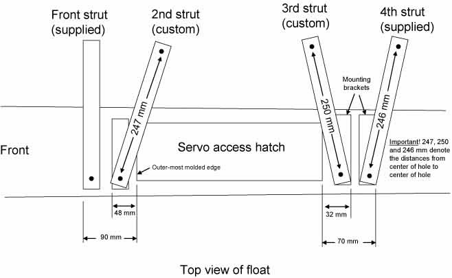

Butlern: Good moorning, I have a Kmp Beaver flying now, it is my first big plane and I like it,
but yes it does need some mods
This is what I did:
1 Got rid of the 2 servos and stock water rudder ( too heavy) and installed a Ernst rudder and a pull pull system using the rudder servo.
The access hatch was eliminated and painted the floats: Water would come in even if I put
silicone on the hatch cover.
2. All hardware, screws, clevis were gone. Bad quality.
3. Inside the fuse where the aluminum tube goes in and the former were reinforced, the firewall was also reinforced.
4. And the most important was to correct the position of the step of the float, originally was 3 inches behind the cg, end up at 1 inch behind the cg, and the wing incidence was 8 degrees so I fix it and made it 2 degrees. Also got rid of that cheap landing gear and struts and made new with some aluminum bars I bought on a web site. By doing so I notice the floats were 18 inches appart and the rule tells you they should be 25 percent of the wingspan, so 24 inches apart, so I dit it that way.
5 The wing strut goes attach to the wing by a regular screw. I put a blind nut in there ( on the wing) and replace the screw. I did this to make the wing and strut stronger, once came off
on flight.

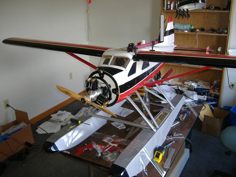

I am just about finished with the Beaver. Thanks to Morromaxx et al for the feedback, and to AKflyer and PaulGC for comments in an earlier thread.
Just one more thing before I put it up in the air... is the CG at 80mm appropriate, or have some of you (akflyer, PaulG-RC) modified this for better flight? Once I set this I'll be ready for wheeled flight, then on to the floats.
As most of you have, I set the wing-float incidence at 2.5 degrees by remaking the float struts from flat-stock aluminum bar. I also placed the step just behind (1.5cm) the CG (at 80mm, hopefully that CG value holds or I'll have to rework the float struts a bit more). Lastly, I remade the wire gear so I could spin a bigger prop (using a ZDZ 40, and I determined that a 20" prop would scrape when the tail lifts on take-off if I used the stock wire gear).
Looking forward to hearing someoneconfirm 80 mm.
Noah

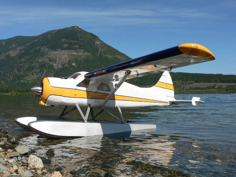

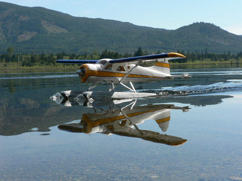

What Morromaxx mentioned are most of the modes you'll need... One mod a fellow I know did was to shorten the float stuts to more of a scale length... What he did was take a 3-view (Beaver on floats) and just scaled up the measurments to get a better looking scale float strut and spredder dimensions... Here's a pic of his..

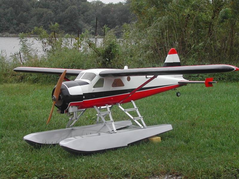

Looks great guys! Here are a few of mine. I've made similar mods as well. Incidence was WAY off. Also going to use a Ernst rudder. Saito 1.7 radial w/ glow charger. Flew fine of the wheels and with flaps was easily 'greased' in. More to follow.

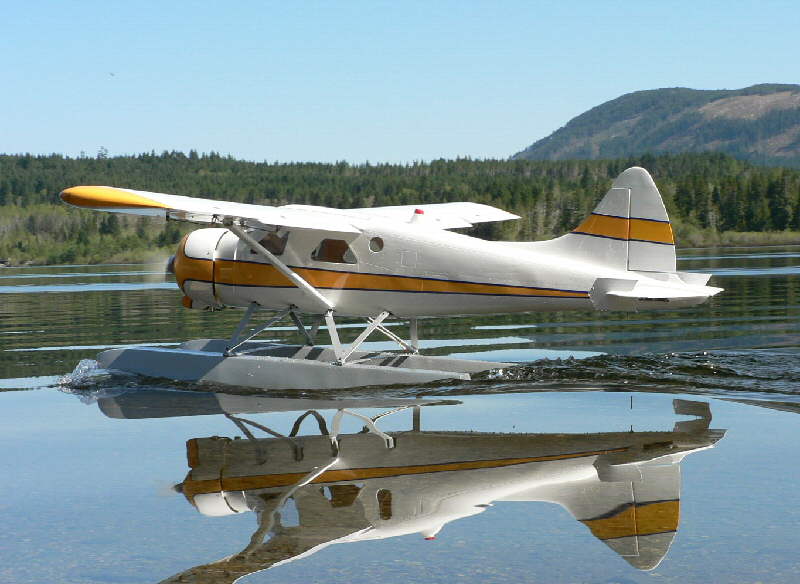

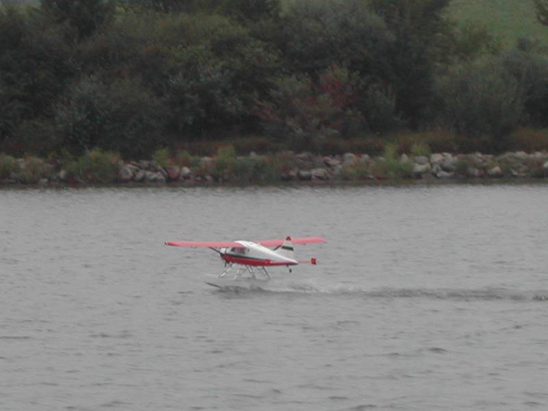

Finally flew from the water yesterday!
Plane was fantastic. Only a few clicks of down and it was flying true. In my nervousness and excitement, I started my first turn after climb-out without rudder and it was very ugly, so for those that have not yet flown with all the added drag and weight of the floats, be sure to steer the plane with rudder! Same really applies to to wheeled flight as well.
Take off "roll" was straight as an arrow and the plane tracked through the water perfectly. I have also re-set the wing (relative to top of float) incidence at +2.5 degrees. To do this I had to cut and drill new struts. Pretty easy to do. I also added steps up to each door, which also helps make the rigging a little more rigid. Used a single Ernst water rudder with (what I believe to be) more scale pull-pull rigging. It may not be visible in the photos, but I used a tiller on the tail wheel, Spyder wire (kevlar), and Proctor pulleys. Pulleys have to go as they don't roll worth a darn. Trying to locate some (small) ball bearing pulleys, so that the action is smoother (water rudder won't easily return to neutral with air rudder is neutralized). Needs more work.
I have the float step located 1.5 inches behind the CG (80mm). Seemed perfect, too. I have no ventral fin, and likely will not add one. Plane was very stable. Was pretty windy and the plane's size and weight handled it beautifully. Finished weight with floats still unknown (guessing about 17 lbs).
Love the plane!
Hope the photos attach.
