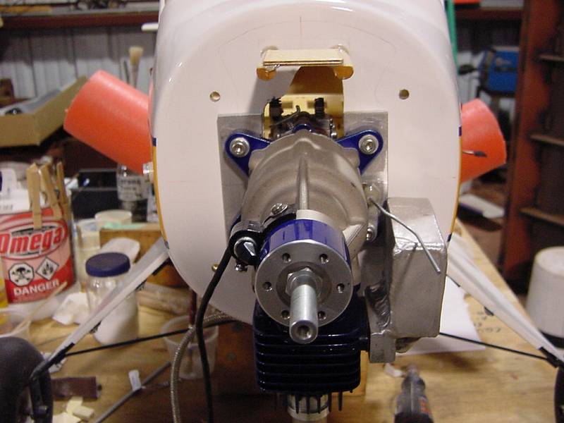

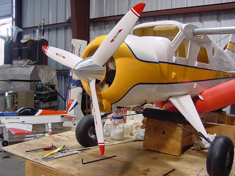

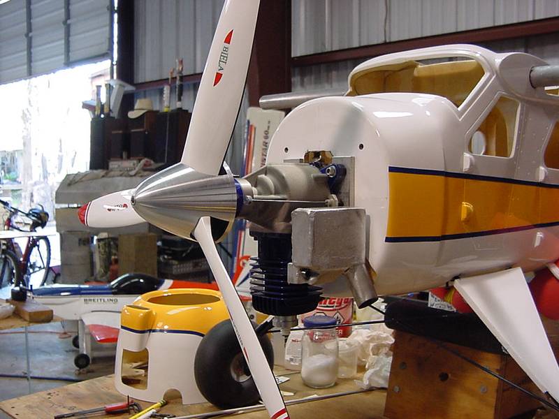

#30
My Feedback: (95)
SSW, Here are some pics to look at.
There is a pic with a G-26 w/ bisson inv. wrap on a G.P. P-6E. If you look close enough you can see where I had to cut out the cowl to clear the muffler.
I also have a shot with a G-26 w/ a G-23 muffler modified on my DR-1 to show the pipe going straight down.
And a few shots of the beaver with a G-26 installed with cowl on and with the piping out the right side of the plane. I haven't soldered it up yet but you can get the idea. I don't yet know if the silver solder will hold up against the exhaust temp so it may have to be brazed together. You can also see the G-23 muffler was modified slighty by a hammer to clear the cowl.
The copper adds about 3-1/4 oz.s of wieght. Again this is an experimental idea.
If noise restriction is not a problem, B&B does have a G-23/26 header pipe that also could be used.
I wish they made 1/2" 90 and 45 degree elbows in aluminum like the copper fittings. One could really go to town making light wieght custom exhaust systems. Coming up with a exhaust system that fits in cowl always seems to be a problem.

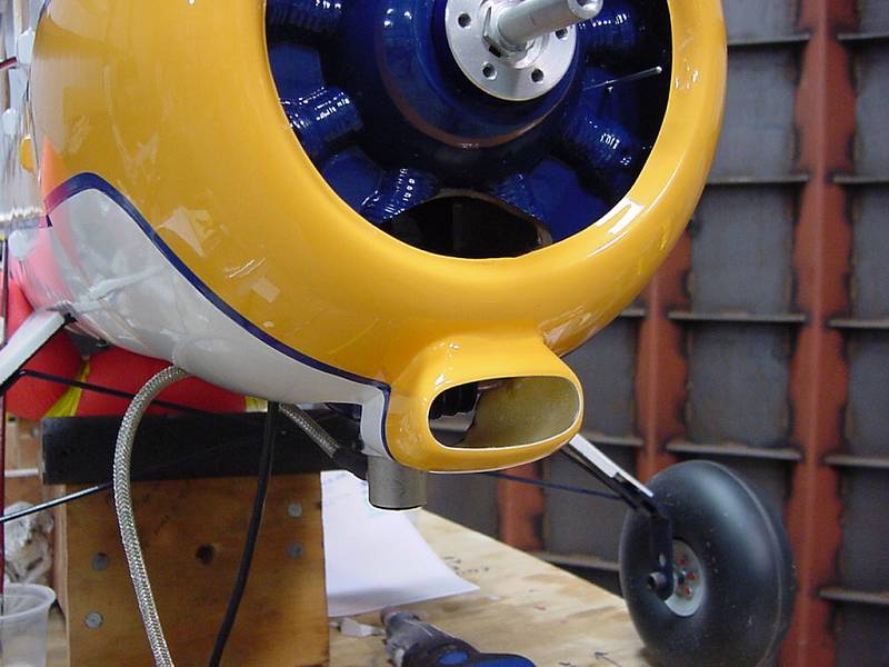

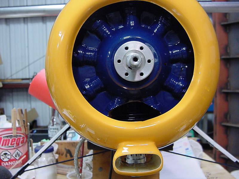

#31
My Feedback: (95)
One thing I forgot to note:
On my beaver, The chin scoop on the bottom of the cowl did not sit perfectly at the 6 o'clock position with the side paint stripes aligned up. (Not a big deal for me as I'm repainting / recovering the plane.)

#33
Joined: Nov 2003
Posts: 394
From: Seattle, WA
If you're using solder on the copper joints, it wont hold up against he exhaust heat. U have to use the copper weld. It is similar to application as solder, but takes about 1200 degrees to melt. Mep gas will work on it.
I have tried the alumaweld rods and it work sometimes. Some failed due to heat and vibration and cracked along the joint

#38
Joined: May 2006
Posts: 489
From: elk grove,
CA
couple of other points....on my kmp beaver....controll horns (plastic 2 screw pinch tupe)totally eliminated.....used carbon fiber horns used on jets...these are hysoled into slots drilled into wing/flap/ele hard points...good for200 mph plus...no ugly backing plates....earnst h20 rudders/proctor pullys work fine....if they bind its due to lower button head screw...too tight....or molding distorted...get new ones...engine....evoulation 26/35 seems to fit cowl best....35 for higher alt lakes.../ft windshield...dont use supplied screws...use any good white/canopy glue...much cleaner install and h20 proof when cured....side windows go in good w/omni/goop into small syringe for tiny non/sloppy bead/1.5-3 float inc to wing inc fine...step position not that critical....1in either side of c/g/servos...digital/mg/65-80 oz fine...im using hitec mgs...very little gearbacklash....good value/im using twin lipos w/regulators....light and c/g good with heavier evo 35/19/10 carbon fiber prop......sinc kp couch
#39
Joined: Feb 2005
Posts: 115
From: , NC
I have still got a long way to go, but this is what I got done so far.
Fabricated muffler for ZDZ 40 rv
fitted cowl
Extended landing gear
Noah, what kind of tempetures are you getting with your ZDZ 40?
Im thinking of baffling mine.
I test run on bench and a 5 second WOT , would put it 300 degrees F.
After yours got broke in, what was your High and Low needles turned out too?
Thanks wade
fitted cowl
Thanks wade
