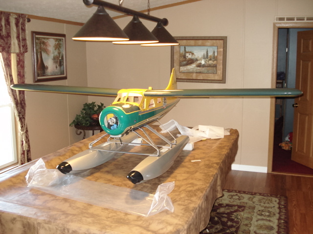

I put her in the air today, got 3 flights in. The Beaver flys great. My first flight was a non event, with 1click down elevator, 1 click left aileron. I checked the stall up high , she mushed staight and forward. I landed without flaps with a lil speed, a pretty wheel landing.
I dialed in some ele-flap mix for the second and third flight. She come in low and slow. The ZDZ runs excellent, I have about 3/4 gallon thru it, and sounds great with my special fabed muffler, I like em loud. I am very satisfied with the plane and engine.
My custom landing gear is solid as a rock, aluminum construction, tig welded. 6" Dubro tires give it plenty of cushion. I did raise both ailerons up just a tad, making turns, banking a lil better.
I am ready to go to the next project Cutiss Hawk and P-47 and bigger Cap232.

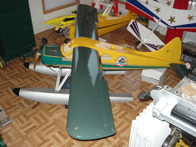

Well, after waiting on a few things and the usual distractions, the Beaver is almost done. I weighed it yesterday with no CG modifications and it was 19 lbs- 2 oz. I was expecting it to be a little heavier with the Sea Commander undercarriage. I will have to add 1lb- 4oz to the float tips (10 oz each float) to pull the CG in to 80mm. Total weight now will be 20 lb- 6 oz. Right where I hoped it would be.

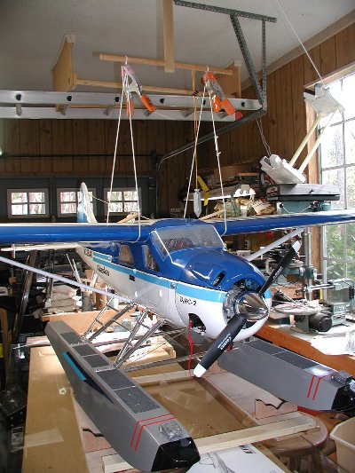

I had to cut out access hatches on the float tips to drop in the weights. I'm working on that more tonight. Will post some more pics.
This picture is my CG machine for big planes. You may note the plane is suspended a few inces above the cradle. Very accurate for finding CG.

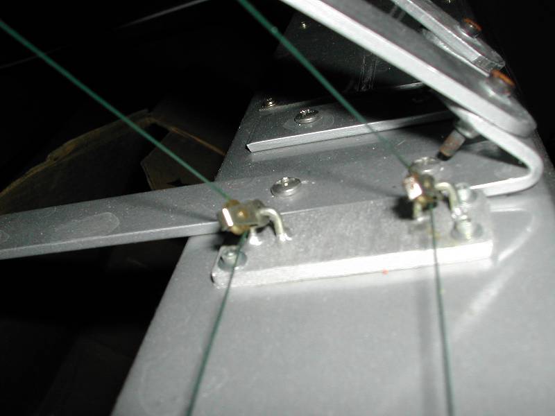

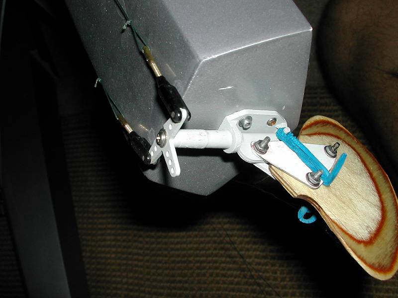

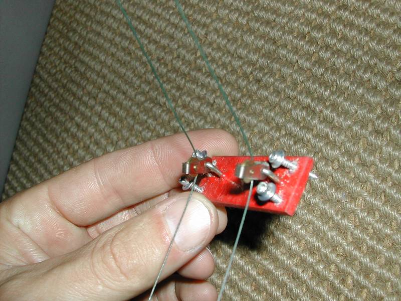

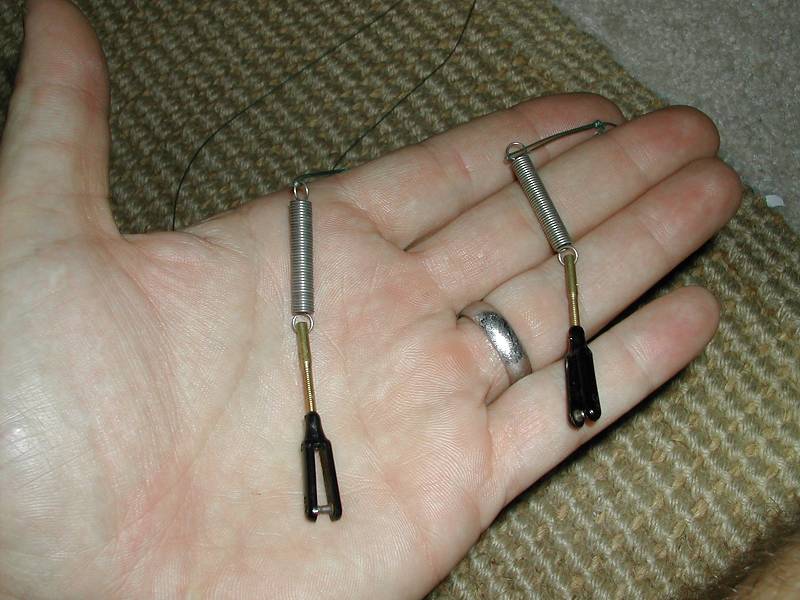

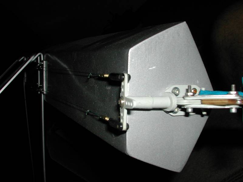

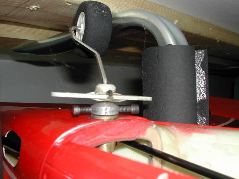

you're right about the rudder set-up... I forgot that I added an extension to the shaft in order to get the control horns above the top of the float, and at the same time, keep the rudder as low in the water as possible. The solution that I came up with prevented me from having to trim the rudder... I got it mounted so the front radius drops below the float. To do this I glued two shafts from two separate Ernst rudders together. I'm sure that you can come up with some surrogate material, rather than buying two as I did. Photo for details (forgive the poor quality). Also note that my rudder is made from plywood... this a consequence of getting into a rush... I broke the original plastic Ernst rudder trying to rapidly get the plane loaded into my car. So, don't worry... the plywood rudder is NOT any special performance-enhancing modification!
Anyway, I ran Kevlar fishing line from the water rudder control horns through pulleys (available from Proctor) mounted to a plywood plate. I simply bent some 2-56 wire in a "U" shape, slid on the pulleys, then CA'd these wires into holes drilled in the plywood plate. The plate was then screwed into the top of the float, just behind strut #4. From there, the lines ran through another set of pulleys (red plate in my hand). This plate is screwed to the bottom of the fuse (ply added inside the fuse for bite). From this plate, the lines crossed over one another and then were finally attached to the tail wheel via a tiller bar that I fasioned from an old dual-sided servo control arm. This took some fiddling to get it seated on the tail wheel wire (and set tightly so it wouldn't slip). Laslty, I used a couple of small-gauge springs to relieve the tension on the kevlar fishing line (also should be visible in the photos).
This set-up has held up well to two rigorous float flying seasons. I have been very pleased with both the look and the performance. By the way, I use only one water rudder. I found that it works just fine with only one rudder. So, in my opinion there is little point in trying to double the work, weight and complexity! You're call, of course.
While you may not have the exact materials lying around your shop, I think that you can substitute where required and set-up your linkage similarly.
Regarding the step and 80mm relationship, If memory serves, I simply put a carpenter's square on top of the float (above the step) and checked that the perpendicular rise of the square pointed to a spot on the bottom of the wing that was 80 mm from the leading edge. I think. I may have to think about that some more. I'm pretty sure that's how I did it. Yeah, that should work. I think. You should think about it, too. I'm almost certain that this was how I set it up. Almost.

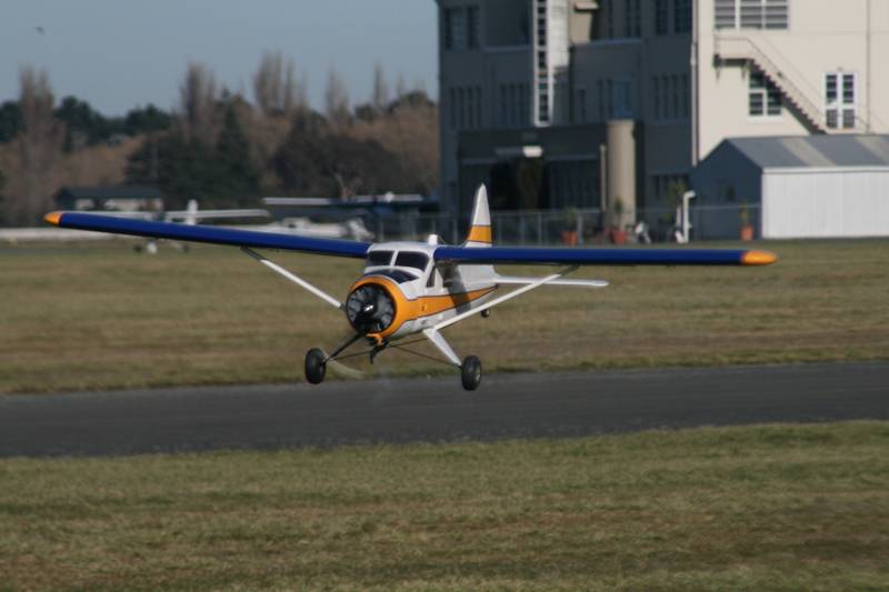

Had another flight on the weekend ( wheeled ) it flew like a pig and I nearly lost it! Guys at the field think I had too much aileron and rudder throws and not enough expo around centre on ailerons too.
I think I had over ridden my computer settings... are well start from scratch again. Probably shouldn't re maiden it off the water though?? Hope weather OK next weekend to set it up before floats on the following weekend.

Right, Paul. You may be better off fine tuning its handling characteristics on the land before you drop her in the water.
When you say "like a pig," do you mean unresponsive and sluggish? With all that throw it should be nimble. I have as much throw as I could get out of all surfaces. I also have about 45% exponential on elevator, 30% on ailerons and rudder. The plane makes much better turns when they are coordinated (aileron + rudder). Get it out there and fly it a lot before you take it to the lake.
Regarding the wire landing gear, I disposed of the stock gear and made my own. I did, however, use the stock gear as a template to get the general shape and angles (particularly where it mounts to the bottom of the fuse. I bought a length of steel wire (music wire), solder and more of the kevlar fishing line. I found that solder was not sufficient to hold the wires together, that's why I wrapped all the joints with the kevlar and then soaked it with CA. Bullet-proof.

Thought the wheeled version for fine tuning would be the case... just was wondering if it actually flew much differently ( more sluggish? ) in the air with the floats?
Last weekend it flew the rudder was very sensitive and I needed way less throw and more expo, ailerons also were the same. Must have been my model selection program error [
I too had all the throws max'd out, the only good one luckily was the elevator. I think more than the 20-30% expo dialed in which would have helped. At the time I also had what I thought was just a little rudder mixed into the ailerons, turned out I had far too much as the Beav nosed down heavily in the turn ( nearly snapping ). Lesson here... is for ME to use my rudder!
Beav had another flight flight that day with rudder mixing off and had some stall tests done up high. Without flaps she smartly dropped the left wing, half flap it was heaps better and full flap ( includes a bit off flaperon like the fullsize ) was great... just sunk without dropping a wing at all. Only thing it did was slight yaw left which I think would be the aileron trim I've got on.
