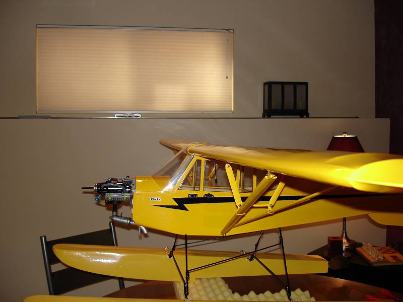

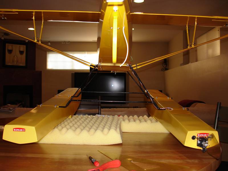

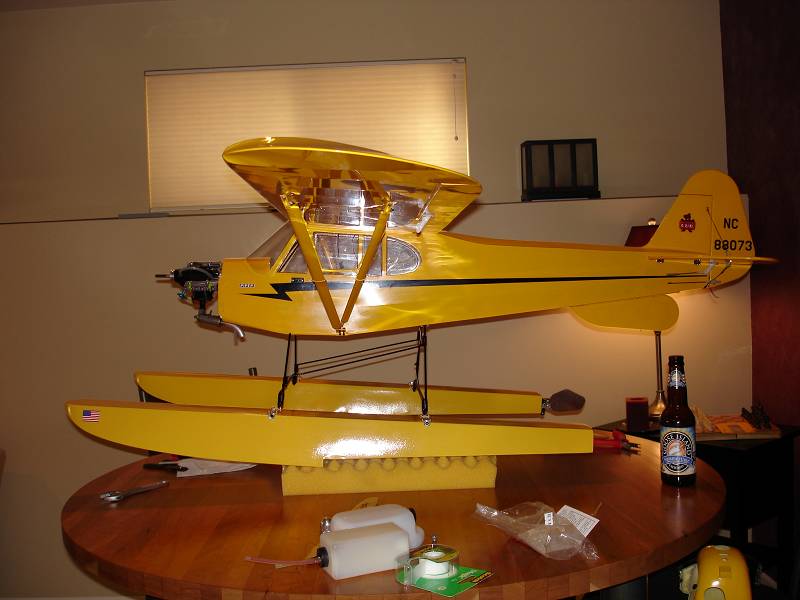

I have an update to my findings:
1) The floats are straight to the fuse - I plummed a line from the CL of the floats to the CL of the fuse down the length of the fuse and it is parallel all the way down. Top of floats are level.
2) The wing looks straight with no warping or loose ultrkote.
3) Ailerons are trim flush and straight with TE of wing
4) Weighed wings and both came in @ 1# 3.8 oz exactly. Connected wings (no fuse) they balanced perfect (didn't balance cord wise)
5) Don't think I can do outside loops with a Piper Cub - at least I didn't try.
6) This was my maiden voyage and I noticed that the plane is very tail heavy. I am placing weights on the float tips to get the CG to suggested spot and I'm picking up the plane under the wing and balancing to get the main wing underside level with the ground. Is this correct?
7) Can a very tail heavy plane cause the rolling problem?
See pictures for details
Thanks for the help and keep any other info coming!

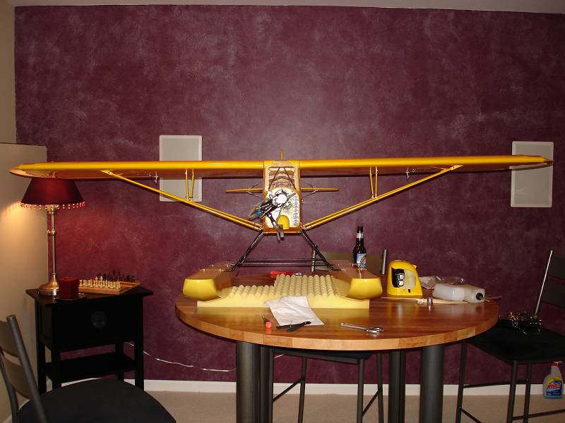

I agree with Duane, I think you have a slight warp in the wing or you may be creating a warp when attaching your struts. Use a level on the bottom of one wing tip, at the last rib, and shim up your floats to get the wing level, then go to the other side and check. Another way is to hold a yard stick under the wing tip and measure from the ends of the stick to the floor (table). Shim the floats till both measurements are the same. Now go to the other wing tip and check the measurements.

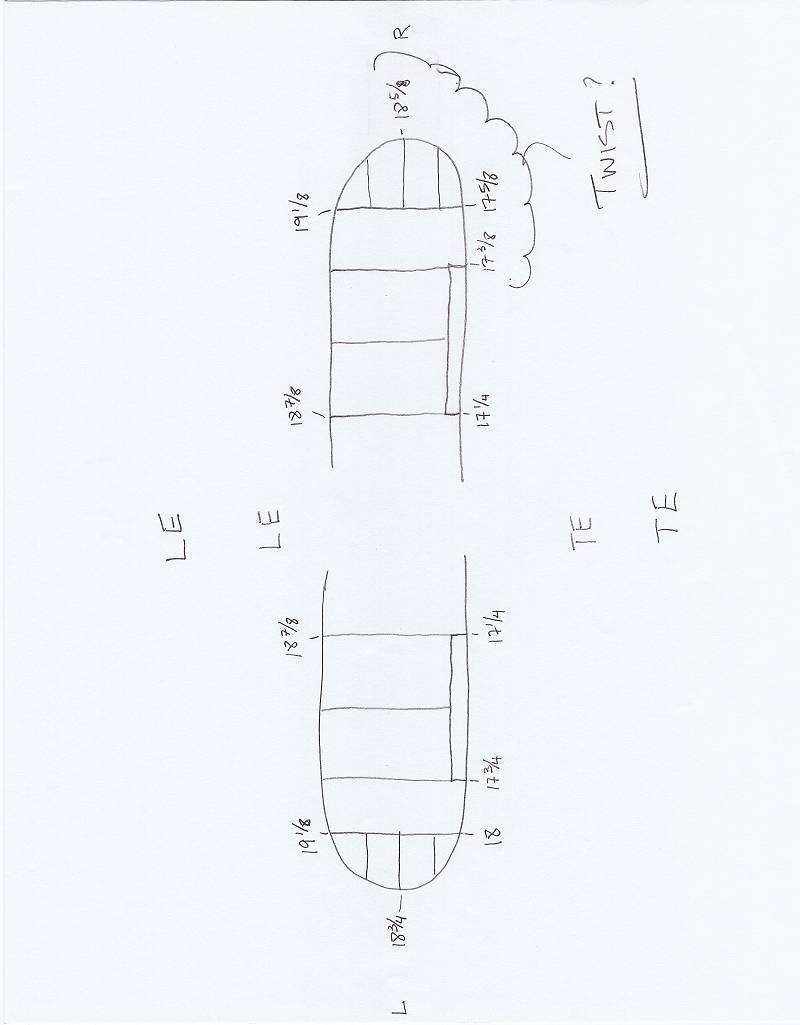

Update -
I shimmed the right float up 1/8" off floor in order to get the wing tips to match height off ground once connected. Attached is the picture of what I have found by taking measurements around both wings from the edge of wing to a level surface.
It seems the right wing may have a twist at the end of about 3/8" - 1/'8" around the end of the wing. I guess this is in the right direction to cause a left roll.
What do you guys think? How do you fix or compensate? This is a ARF and I'm not taking the ultrakote off.....
Thanks!

It looks like you found the problem. I don't know if the right wind TE is twisted down or the left wig TE is twisted up or both. Either way they should measure the same. I think you can get the twist out, but you'll need another person to help. While one person is untwisting the wing, use a heat gun across the wing top and bottom. After cooling re-check your measurements. Hope this helps

Thanks for the help!
I don't know if one is twisted up or the other down but since this is a new plane Horizon Hobby said they would replace the wings at no charge - so I think I'll take them up on it! I guess 3/8" is enough to do cause the problem!!

Looking at your first picture I'd say the beer bottle on the left float is causing your problem. [sm=lol.gif]
Really though, if you look at that first picture it looks like you have a warp in the wing, of course that could just be an illussion from the picture.

Thanks for the advice and you are right about the beer! Actually the first picture does show a bit of the warp - the TE at the end of the right wing is 3/8" lower than the left wing causing the left roll problem. As I said, since this is a new plane Horizon Hobby argeed to replace the wings at no cost! I just hope the new wings are not twisted.

Unless the wing is fully sheeted in front of the spar, you can twist out the warp. Maybe even if it IS sheeted.
Get some beer cold, and ask a buddy to come over. Have him twist the wing in the appropriate direction and you go over the covering with the heat gun until the wrinkles disappear. Do the top and the bottom of the wing. Once you have both wings the same you are good. On a Cub it is not a bad idea to twist a little washout into both wings.( Washout: trailing edge higher at the wingtip) . I agree with previous posts that in the first picture i t appears that your right wing has some wash-in. Since this is a Cub, the V-shaped struts can affect the rigging angles, so check the wings both with the struts arrached and without. You may just be able to correct the problem with the struts.
