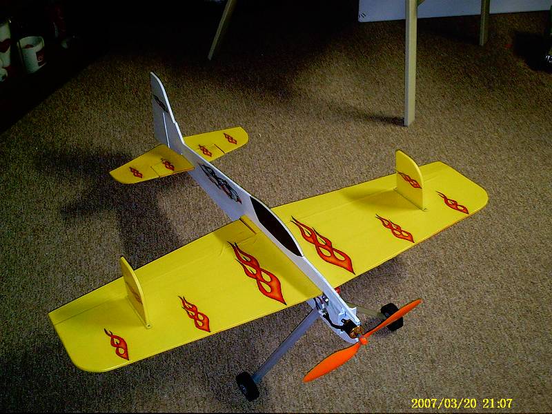

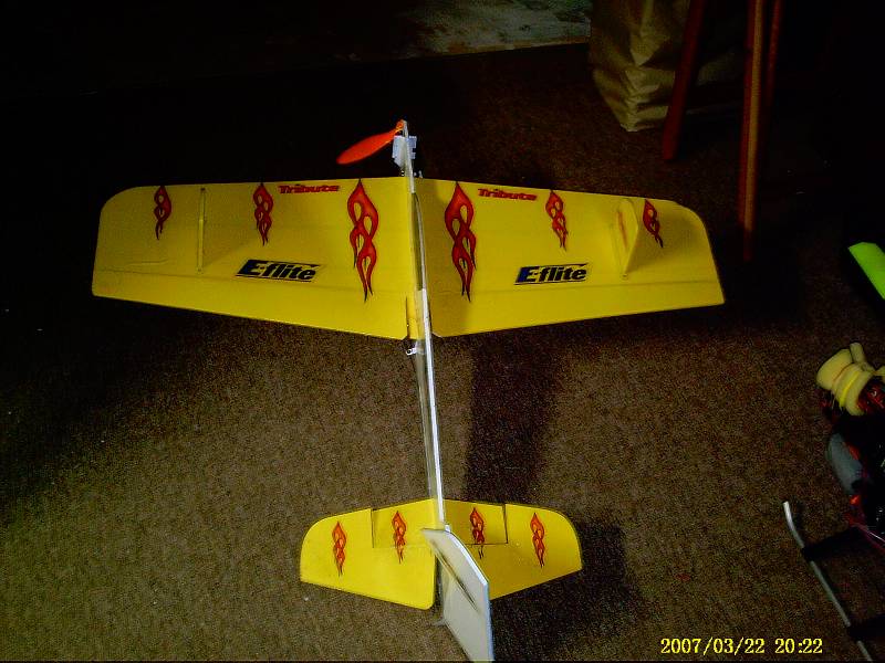

good point. since it is water based. it's soooo easy to work with and clean up . maybe a second coat with spar urethane. used the poly to glass a small foamy, and painted it with krylon fusion afterward. came out pretty good. worked great. tryed to upload a few pix.
thanks for all your advice. i don't have time to make all the mistakes.
