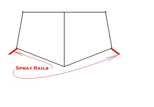

I want to follow up on the spray rails.
When you refer to "edge of the bottom" I presume you mean just above the water line?

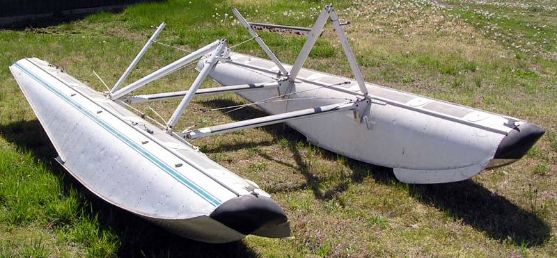

This plane has a molded plastic hull. Molded into the hull is a bumped out "v" ("<" in cross section) which runs from the tail forward, ending just a bit forward of the propeller. Floating, this is just above the water line.
The wing floats have no such feature. They are shaped like, for lack of a better description, a common rowboat. I believe a fair amount of the water is coming off the fuselage side of both floats. It sounds like a spray rail on the inside of each float would be prudent.

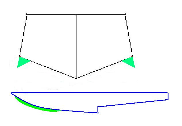

What kind of material, with what shape, do you use for the rails? Perhaps a plastic extrusion, with an obtuse angle cross section?

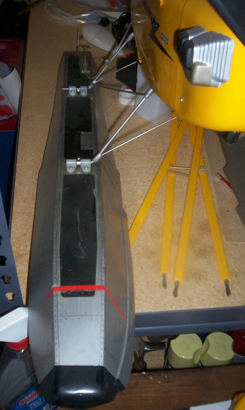

The edge of the bottom is where the bottom meets the side of the fuselage/float. Here is a pictire of the installed spray rails.
Another way to accomplish the same thing is with triangle stock. Either way they are installed near the nose-where the spray squirts out from under the float.

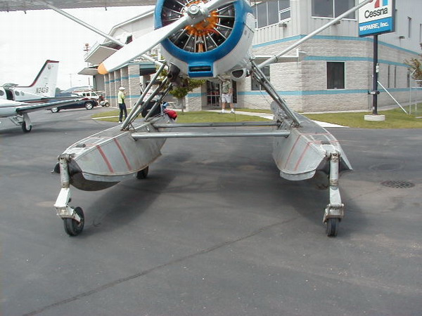

. Here's a pic of a spray rail to go along with Jim's diagram. Your pontoons shouldn't need one, but the main sponson (fuselage) should get them on both sides, from just behind the point of the bow to about 2/3 of the way to the step.

Khodges: Great pics. Thanks a lot. Now I can make them look reasonably "scale".
They must work...is that the carburetor intake at the six o'clock position beneath that radial?
