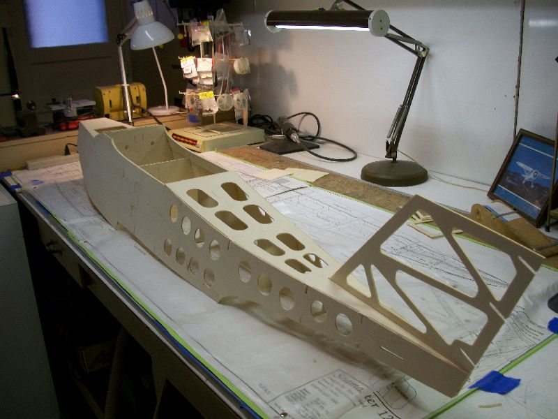

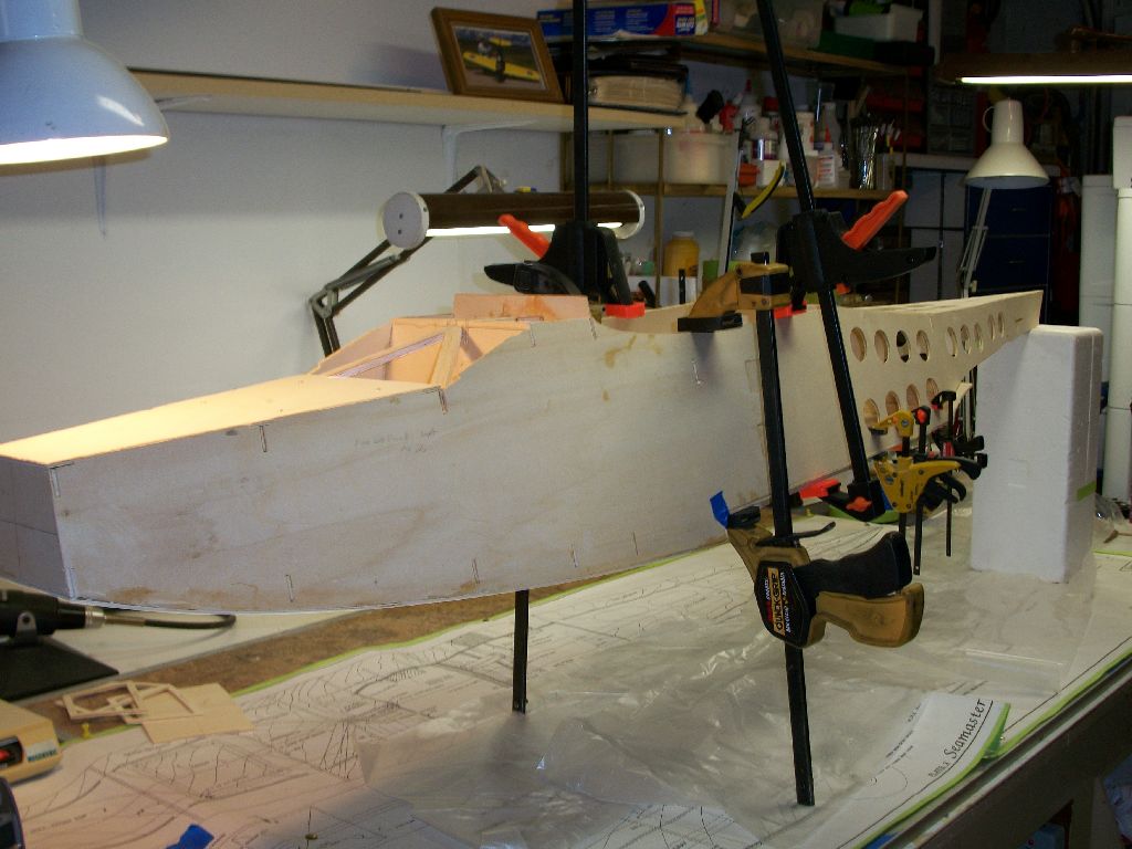

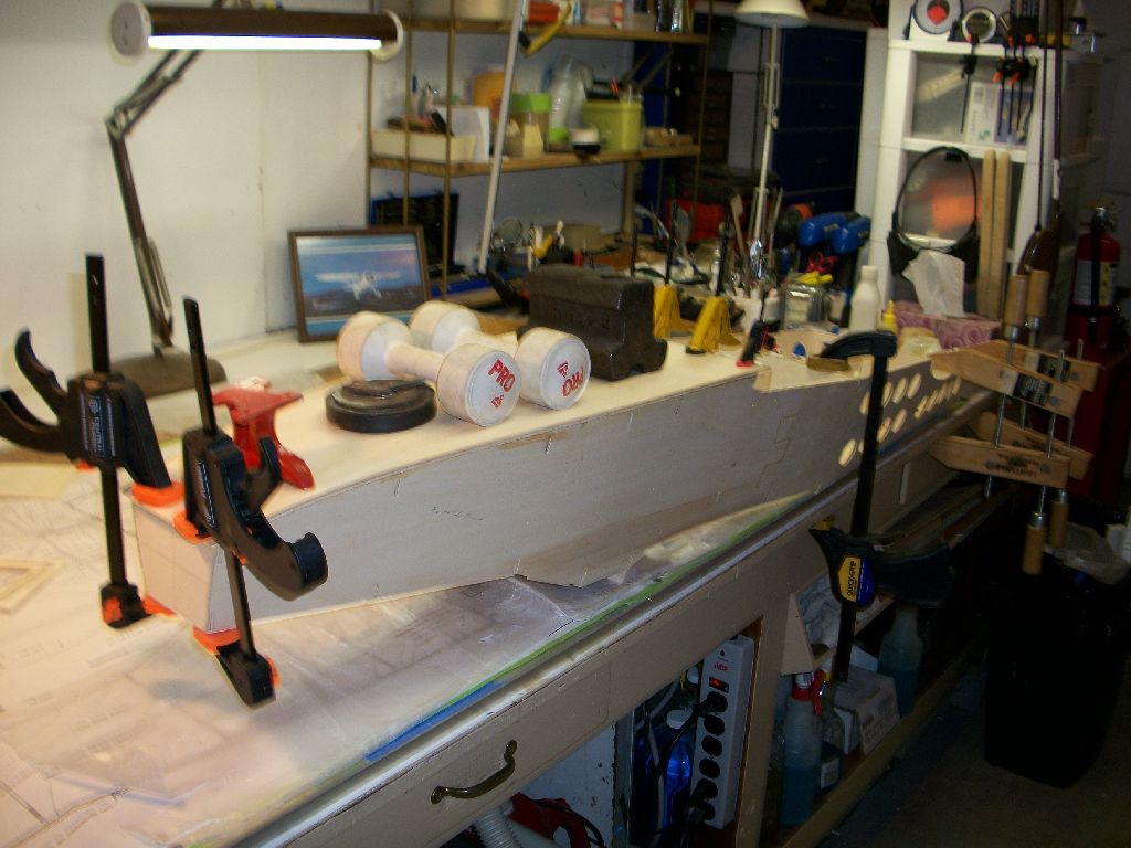

Hey guys,
This is my Seamaster120, I was wondering if there is a full scale plane that the Sea Master is similar too? Mine will be done soon and I will be glassing the bottom of the fuse, covering the sides and top with solartex and painting. I will spray the wing with mimwax to seal then paint as well. I want to put rib lines in it but not sure how it will look.
Shane

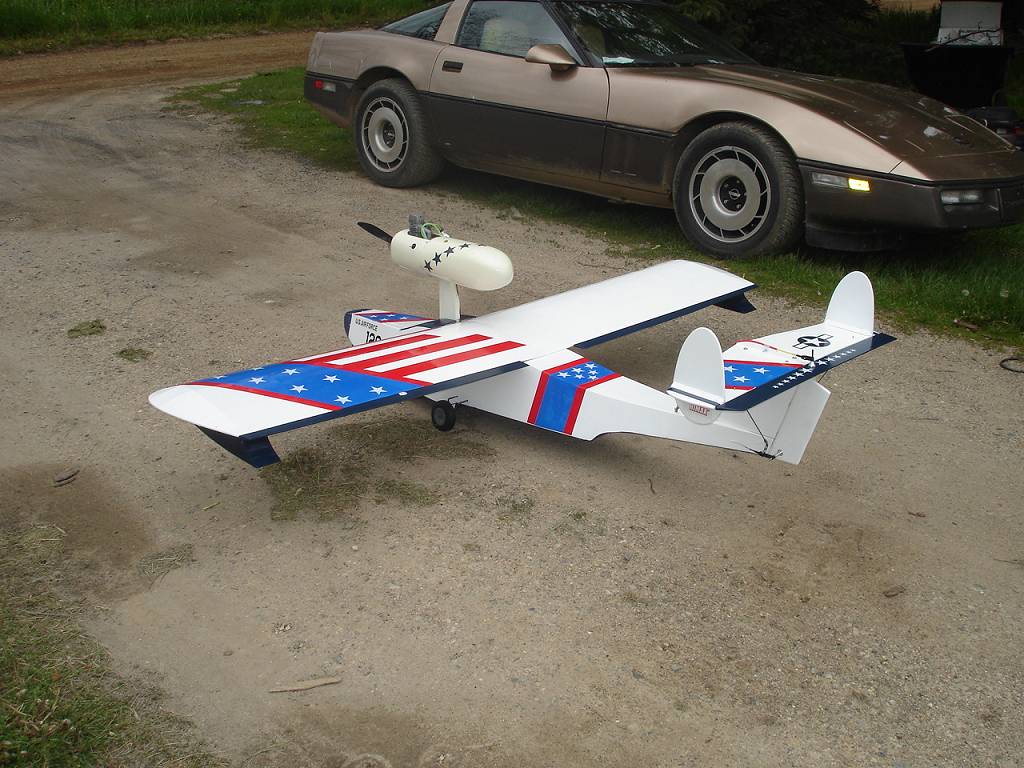

Hey Pit-Viper 1 Here is a pic of my SeaMaster 120. Powered by a magnum 180 4s.

goirish,
what difference did adding the fins to the tail make if any? Did you fly it prior without them to see? I will be using a RCGF20cc gas on here, not sure if it will be enough or not. How does it do with the magnum1.80?
Shane

Had a little adverse yaw. That corrected it. 180 was plenty of power. Not sure about the RCGF 20. I have their 26 on a 1/4 scale clipped wing cub and it is about right for scale like flying. Not sure it would pull it off the water with floats. (Boy that was a dumb statement) I know it wouldn't pull if off without the floats.

I don't think that glassing is absolutely necessary, I am doing it for 2 reasons.
1. This is going to be a test bed for another larger scale job I will be doing on a Spitfire. Since this will be mostly on the bottom it won't really be noticeable, if you know what I mean.
2. I know how I fly, so I have no doubt that there will come a time when I will want to fly it off snow. (maybe even grass) I've watched quite a few vids and I don't see any problems with it's design as far as the bottom of the fuse. The biggest thing I see is the tail section and the adverse yaw effect. Nothing a little sheeting and a good set of wires shouldn't be able to take care of.
Shane
