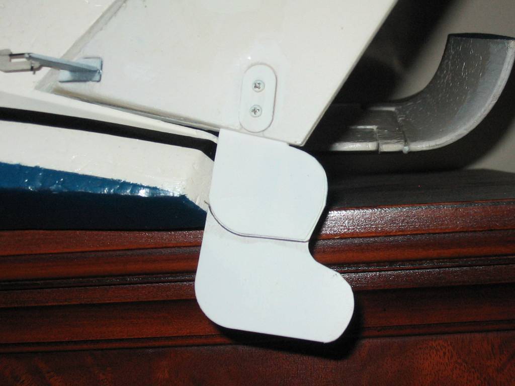

Mine exhibits similar characteristics. Rudder is useless in the air and at slow speed on water. You need throttle and lots of up elevator to get any authority from the water rudder.
Fprget taxing in any wind. or make sure you end up up wind so it gets blown back toward you.
I scabbed a larger, thin plastic sheet onto the existing rudder, problem solved.
(I'll post a pic tonight)
Also trimmed off some of the wingtip sponsons, a very good mod.

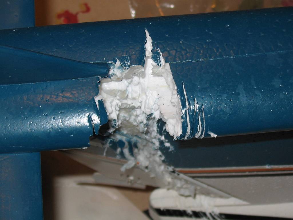

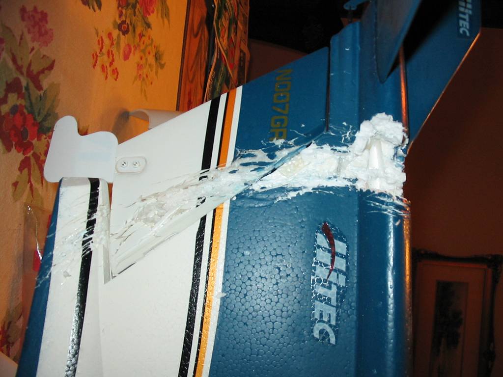

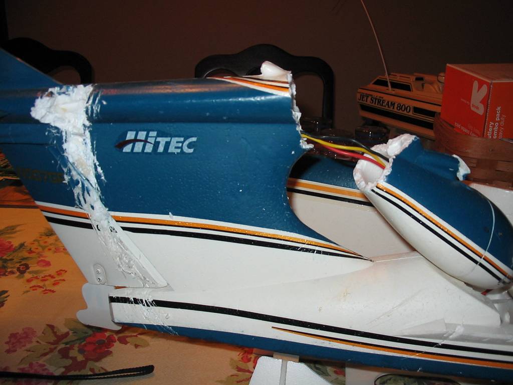

The pictures below tell the story of the hard "landing" that broke the nacelle, then the water
in the hull shorted out the ESC and my propeller proceeded to chew up the plane while
it was floating out of reach. It's all fixed, and flew it again just this last weekend!
