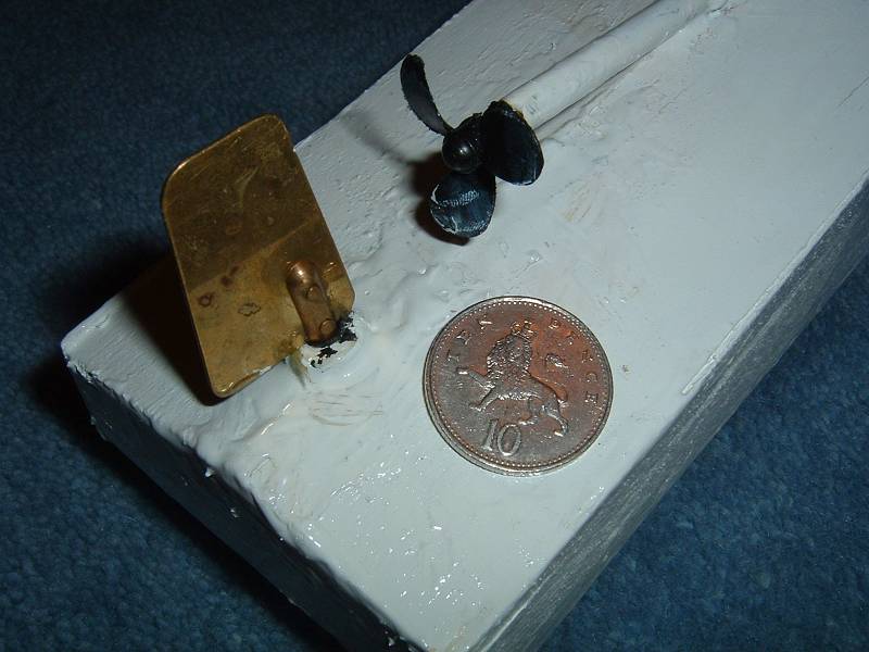

Hi! I make all my boat hulls, and I am going to get a 700 motor and 12-16 2000mah AA batterys for christmas. Which hull should I use? I want them to go really fast. Which prop too? I have 2 good ones.
In this post, pics are attached of my outrigger. The pictures taken in the water are with a 6 cell 1800mah battery pack and a ungeared 540, with the prop shown.

Bother. I forgot to attach the images. so, here they are. the prop is 3 blade, and the same size as a 10p coin

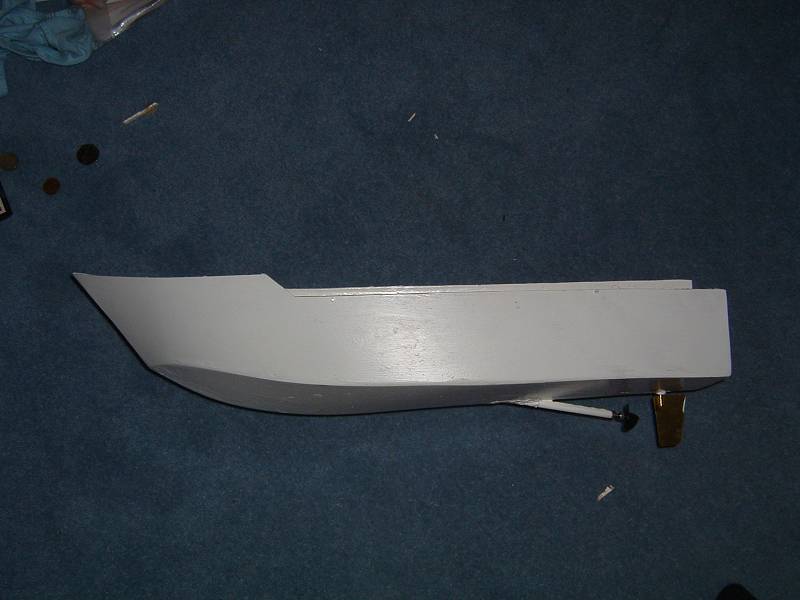

And, here is the other boat. It is big enough (hopefully) to cary as many AA cells as I want. I have used it and it floats high in the water and is very stale. Here are the pics. The prop is 3.5cm in diameter, and has 2 blades.

Don't order those AA batteries! They're not good enough for what you want to do with them. Pick up some GP3300, GP3700, or IB3800's. They're all right around the same price, the 3300's the least expensive.
Onto your rigger: You have it setup for subsurface drive, which won't do. Riggers are hydroplanes, you need a surface drive on there with the rudder off of the back of the hull, not out of the bottom. You gotta let that thing air out! Your prop looks like it's chewed up and is probably very inefficient.
I'm not sure what a good prop would be for a 700 in a rigger.

If you're going to run the 700, you should run at least 12 cells. Just a guess on prop size might be an X645.
You really should have an adjustable strut and offset rudder. Riggers can be tough to set up and much of the adjustments come from strut and rudder angles.

So, would this work?
12+AA cells
700 Motor
Good propeller
The boat in the attached images (60 cm at waterline)
Would this work too?

Like mentioned above, you want Sub C Cells, not AA Cells! The AA's can't handle the current drain of a high performance 700 motor. You would destroy them in a hurry and not get good performance doing so.
Would the 2 set-ups work? Sure they would. Would they really perform? No.
I would focus on the outrigger. Switch it to surface drive with the rear mounted rudder, get the 700BB motor and a speed control that can handle it, get 16 SC (Sub C like the IB3800's) cells and let her rip. This setup has much more potential than the V-hull. The V-hull looks to me like a displacement hull - which will never plane (Meant to go slow like a tug boat).

dudw no matter what you need to stick to one thing(EG the out rigger is the best bet) ok now you need to get a rechargable battery 7.2 volt stick pac at a hobby shop thay go for like 15 bucks or less then get the charger and you will be set then the 700 motor
ok this is what you do take the drive shat so that it is "almost" level with the hull and the prop need to be like 1-2 inches away from the back then get somthing to mount on the back of your boat that is about 1/2 inches away from the prop and mount the rudder then get the servo arm out the back to conect to the rudder
i now this isnt fancy but it seems to me that you are on a buddget so this is the best way for it unless you can find the funds else wear!!!!!
