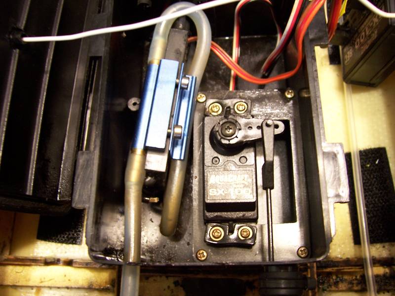

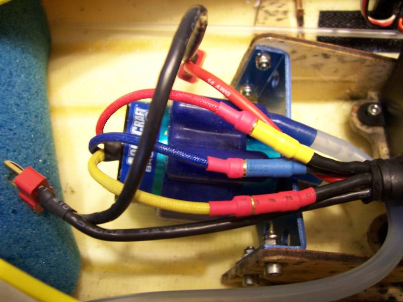

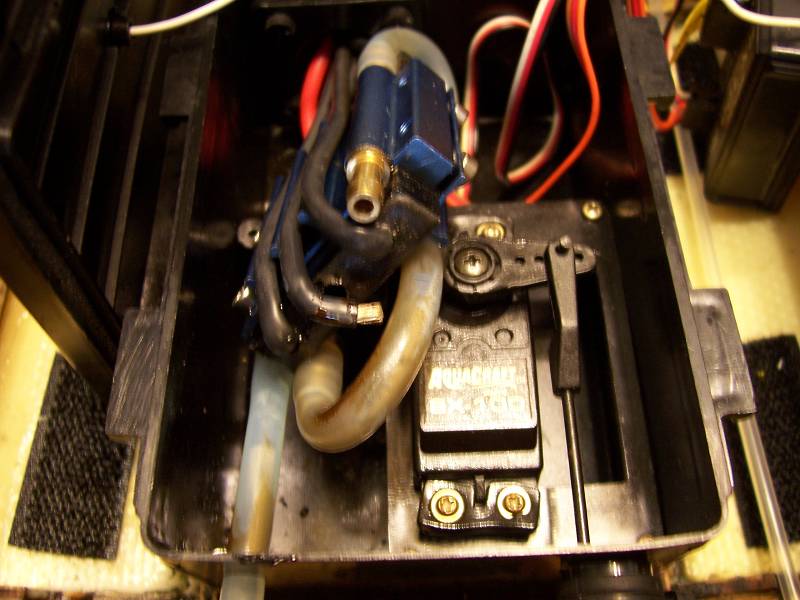

Does anyone have any recommendations for upgrading the ESC & motor that will run about the same as stock or slightly better?
Also are the wires to the motor color coded for a reason?
This boat is one of our fastest stock supervees 33mph with 6 cell 3500s.
The ESC failed on the 5th run.

What prop were you running when this happened? Also, did you have functional water cooling when this happened? The stock water cooling system is not great but if any part of the system gets clogged (your tubing doesn't look right...and it's not because the ESC melted) and you are pushing a big prop...good bye ESC.

My guess is that the wires were not soldered that good in the first place in the esc, we all have seen alot of inconsistencies in the manufacturing. That would deffinetly be a problem. I would definitely search out the warranty on this one. Or it could have been alot of things. Small piece of debris could have clogged the water inlet or something could have gotten on the prop and caused a amp surge.

The SV27 comes with ESC water cooling and other than MsDarla, I have not heard of a single other problem with it.

I noticed the mold, too. Sealing the wood is a definate, but so is storing the boat w/the hatch and radio box open for a day or so before capping everything off to allow it to dry out thoroughly. I wonder is condensation played a part in the death of the esc.
