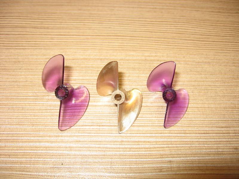

Hello
I'm biulding predator outrigger from the plans I've purchased online.
I allso have ordered a feigao 540S 7T 5070kv 93amp max. 220g 35.8mm x 50mm motor.
First of all now I think this motor is a bit too big or isn't it? I allso don't know what would be the right choice of prop esc and lipos or nimh to choose.
I'll just say that i thuoght of picking a x438prop and 2x 1700mah 20-30C lipos (in parralel)
p.s. motor and esc will be watercooled.. overall rigger lenght about 55cm (21.6")
thanx.

Hello. I am very familiar with the predator.
ok your motor will be OK. but just OK. usually that rigger will have a L motor.
the KV will be fine because it is a 6 cell boat.
are you new to this hobby ?
and a X438 will be WAY to big
try a X430 or X432 at most !!!
oh atlast!
but it would weight 280grams! aint' that too mutch?
I think this motor is capable of quite big power, but if u say so
ok I'll go for these.

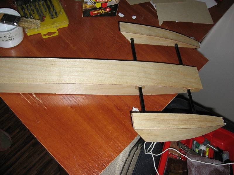

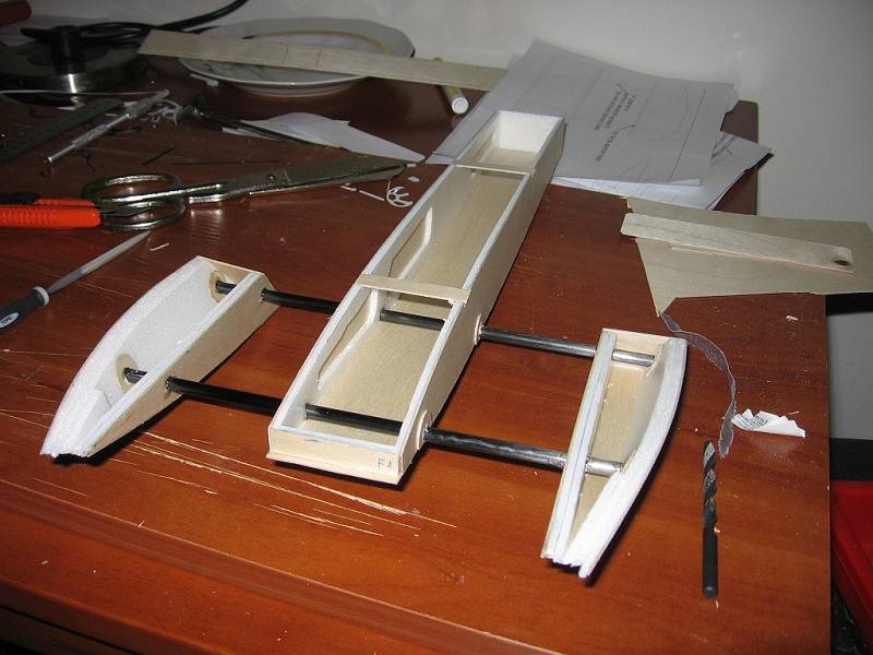

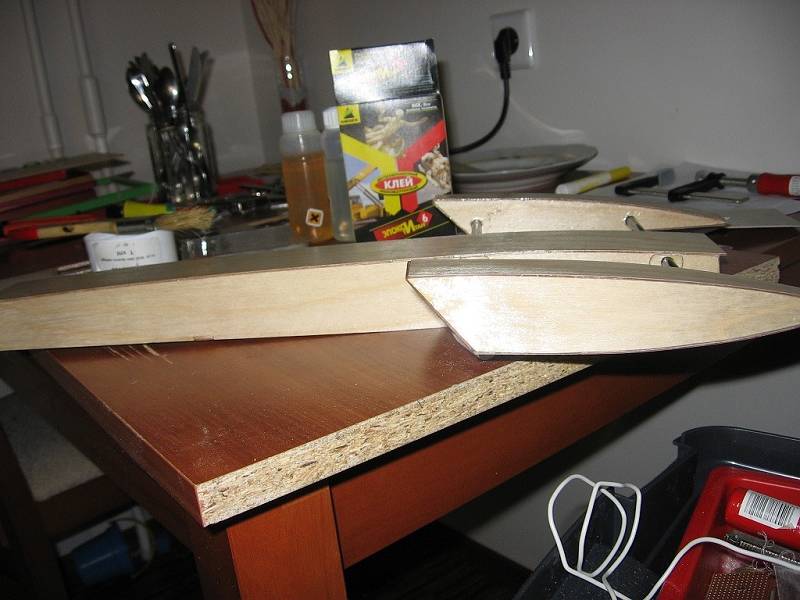

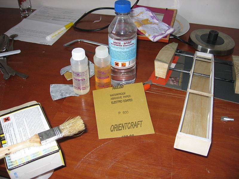

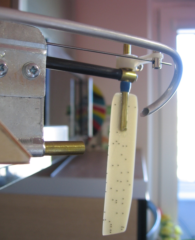

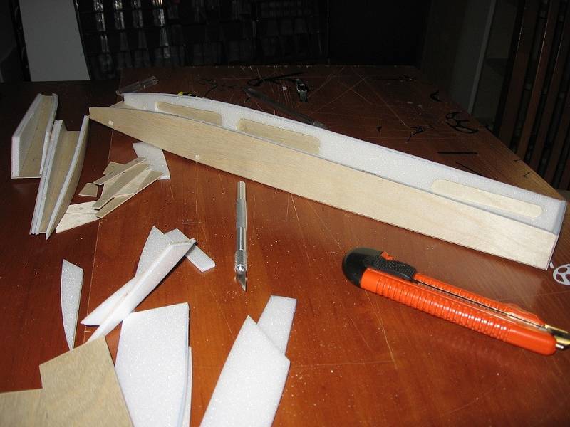

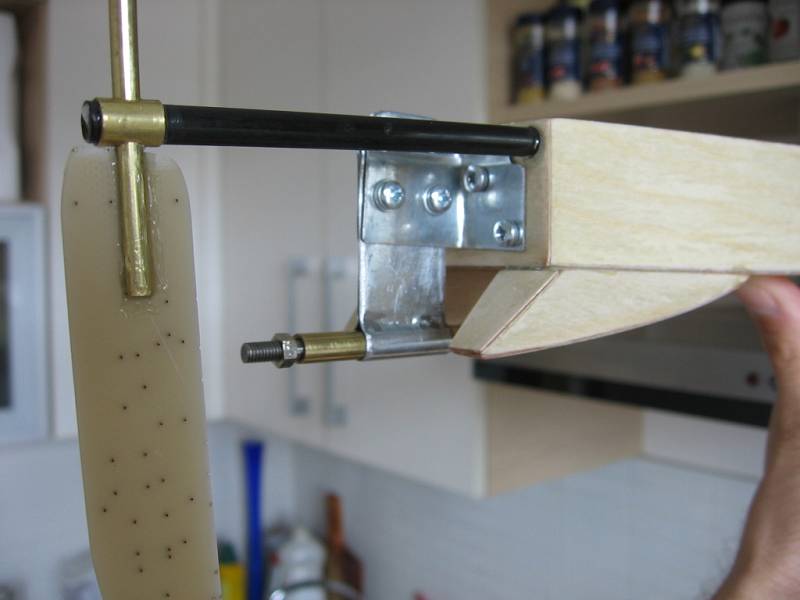

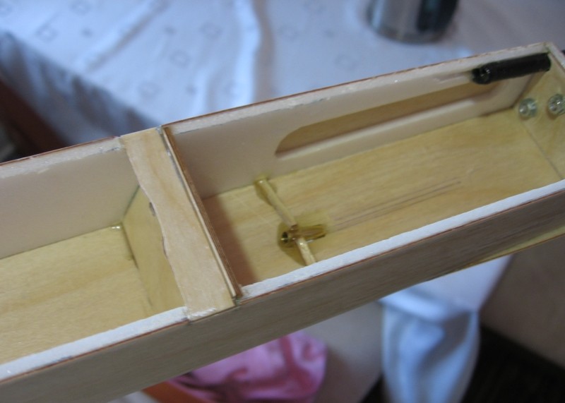

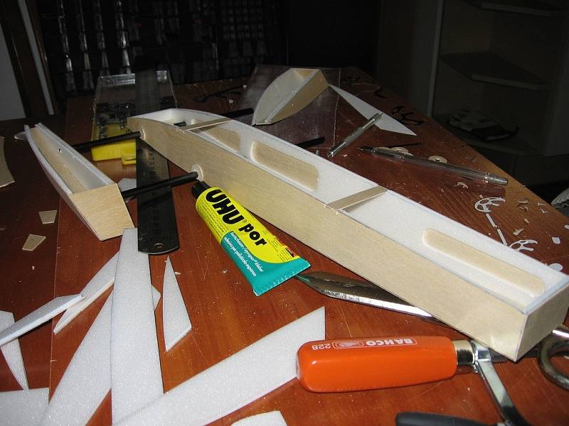

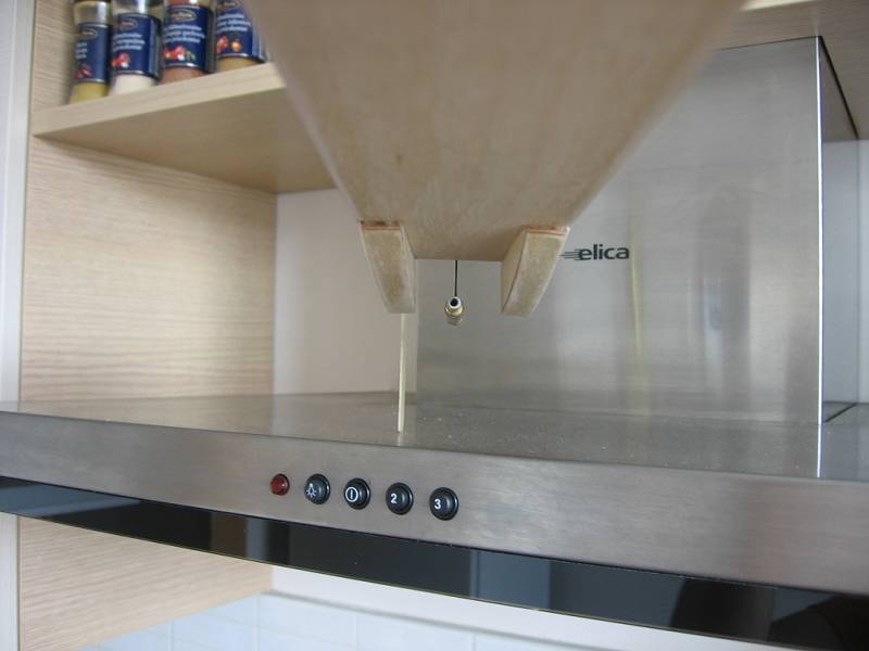

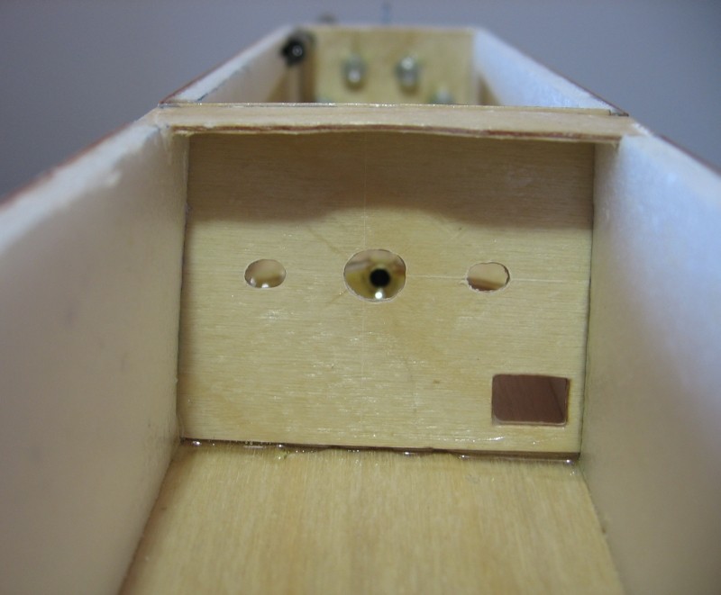

some fotos. constructive critics are wellcome
For waterproofing I used thinned epoxy (10h); thinned with white spirit it is ok, but u have to work quickly. I was sirprised how smooth the surface was after sanding with wet sandpaper [8D] .. 1 or 2 coats to go top parts waiting for hardvare to install.

Old 02-20-2007 | 08:15 AM
CadillacDTS2001's Avatar
Joined: Oct 2005
Posts: 6,449
From: Tottenham/Orillia, ON, CANADA
Default RE: Predator outrigger [project]
good stuff.
i was going to ask where your foam inserts are for the sponsons. then i remembered you got the plans.
Also the foam in the tub will pose a problem. It is not going to have much effect on the strength. so i would suggest you remove it. Heat of the motor and esc and batteries could melt that and be a fire hazard.

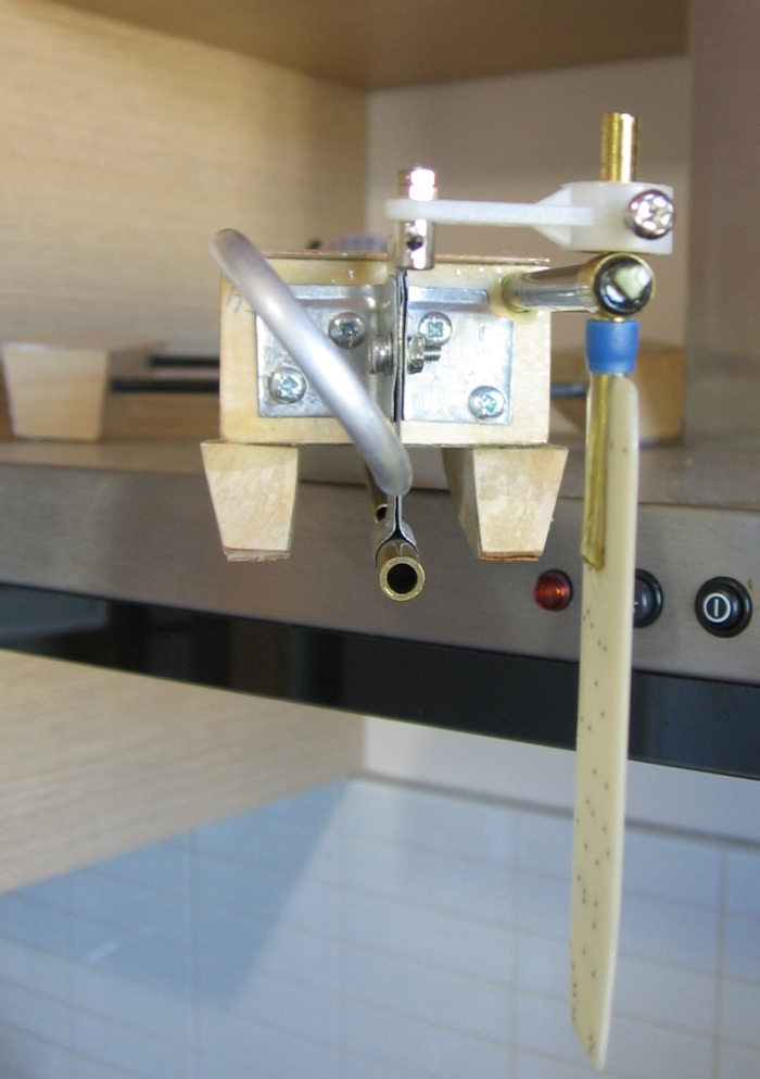

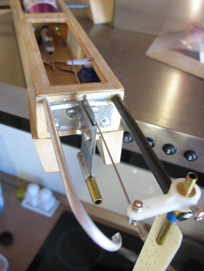

Old 05-04-2007 | 11:22 AM
Fiend's Avatar
Joined: Sep 2003
Posts: 140
From: Vilnius, EuropeVilniaus, LITHUANIA

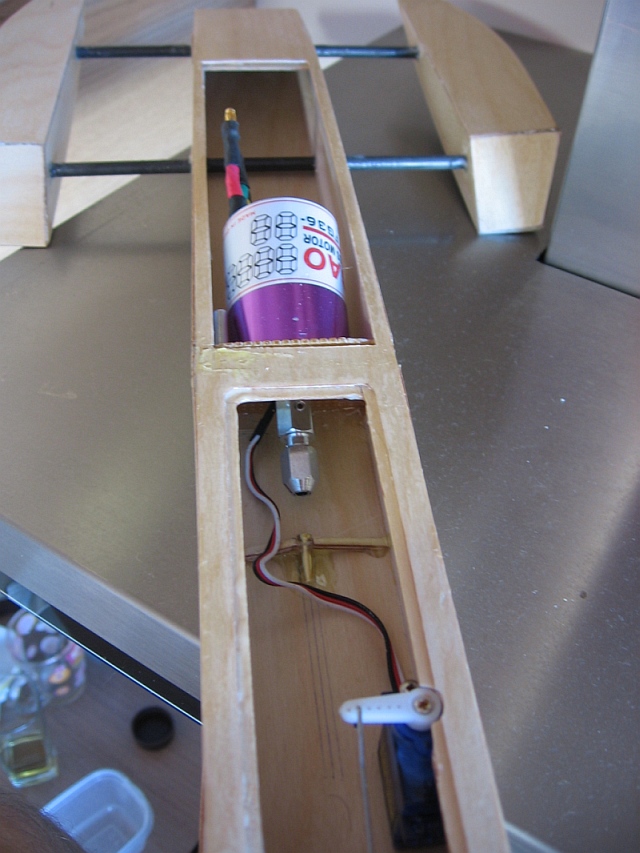

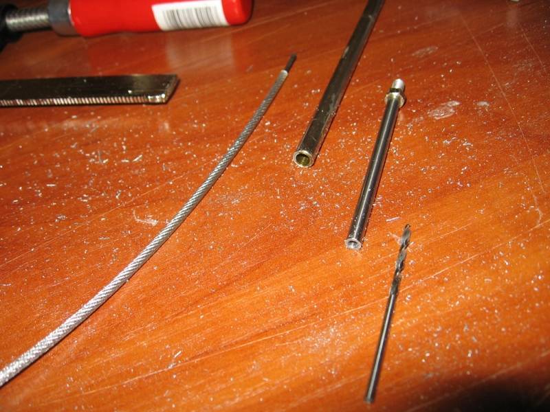

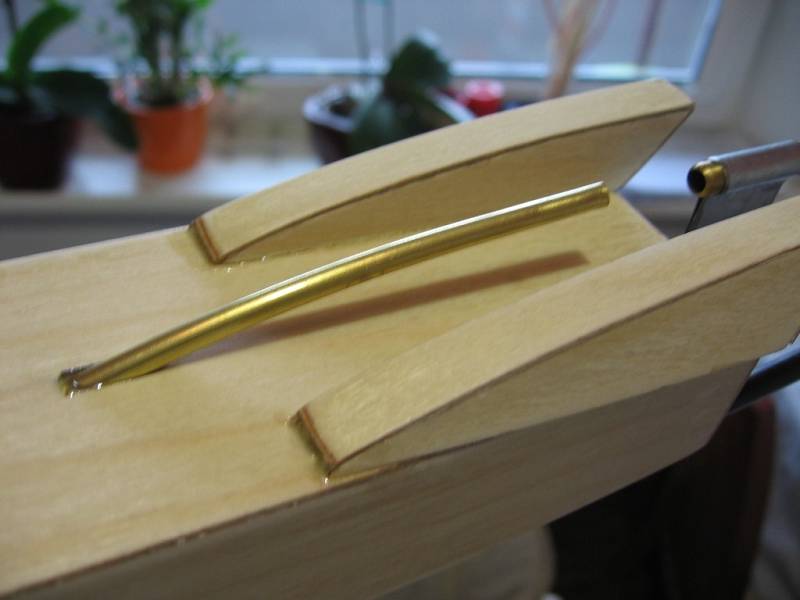

Ok, moving on a bit Still waiting for my feigao motor from UH [&o] [:@] . . .
As there was a problem with hardware shipping from offshore electrics [] so I decided to make shaft & strut (adjustable), rudder & bracket, flex shaft I bought only coupler for flex shaft and ofcourse props.. Idea about rudder bracker came from this forum (I think) It is made from carbon tube as the sponsor toubes... rudder from rudder from corcuit board (can't remember the name of that plactic )
One thing worries me... I made no special bearings (bushings) for the shaft in strut.. it is only a copper tube and a shaft is a stainless steel.. what problems I could face?
thanx.

the only advice i can give you is that you dont want to turn your cable the opposite way that it is twisted!!! currently the cable is the wrong lay for the props you have. also, if you run that cable, it will greatly reduce your number of prop choices!!

ORIGINAL: Fiend
thanx.
Keep the shaft well lubricated, or the two metals will wear eachother out very quick!

Old 05-14-2007 | 03:50 PM
Joined: Oct 2005
Posts: 6,449
ORIGINAL: mahogany dreams
of you have ever seen a flex shaft you would know it does not have any particular direction.
take it apart and you will see each layer is wound a different way. just because you see it going right does not mean it can not turn left. . or vica versa. I run it that way on my Lehner powered N2 and P offshore boat. i do not have a problem with them at all.

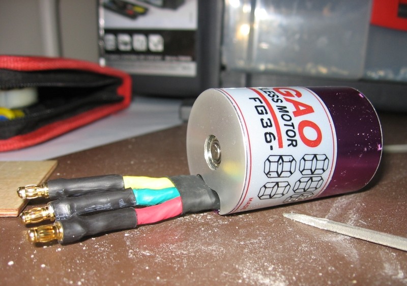

So.. after long months of waiting I received my motor atlast
so thoughts about the motor (feigao 540s 5070kv) is it normal for that kind of motor to heat qoite quickly eaven running freely without any load.. ??
thanx..
