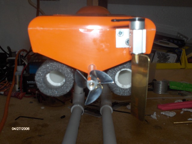

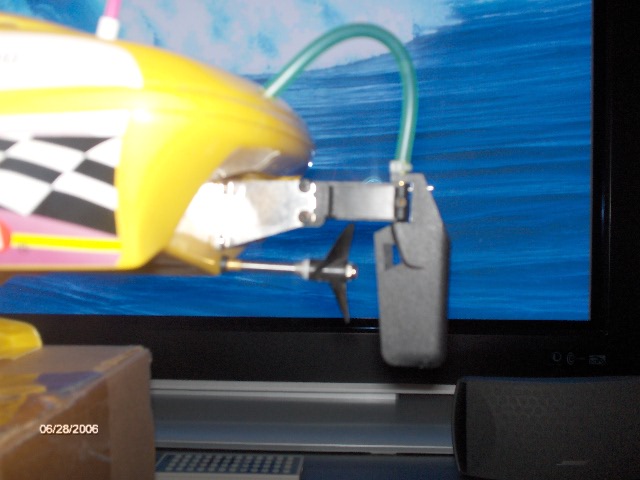

so if i do a brushless motor upgrade on the sw26 how would i make it into a strait drive with a separate rudder??? And is it hard or not to bad?
Old 04-02-2007 | 08:35 PM
Wheelnut's Avatar
My Feedback: (81)
Joined: Oct 2003
Posts: 7,920
From: Annandale, VA
Default RE: Should i get the shockwave26?
SHould be very easy. One way would be to just get a straight shaft that is a little longer than the one thats on there now and put the prop on the end of it. Get a rudder and mount it off to the side or right behind the prop. Reroute the servo connecting rod and your done. Besides the tweaking of course. Here is a pic of an offset rudder. I will look for an inline rudder.

Here is the inline. Sorry its from the side.

ok so it looks as if i would have to mount it behind it also what is the tube the goes up into the boat on the sw26?

ORIGINAL: mxracer154
You could be talking about the antenna tube or the water tube for the cooling system.
Why do you have to mount the rudder behind the prop? Could you give us a pic of the rear (transom) of the boat?

I believe that in most cases rudders are on the right (when not directly behind the prop) because they are more effective there for right turns typical in clockwise racing). If I was going to build a boat I'd try putting it right behind the prop. But off to the right from the back works fine. Supervee is proof. You may want to do some research on how far off to the side you go before drilling any holes.

yea i think i would mount it behind the motor as i would use the boat up at the cabin and to just drive around and have fun...yea i must be thinking about the water cooling tube the one that comes up from the rudder and into the boat so that must be were the water comes from for the water cooling then comes out on the left side of the boat as i see water shooting out from the left of the boat in some pics?? Correct me if im wrong please... I am a noobie and am looking for boats and the sw26 seems like a good starter boat!

Thats why I liked my aquajet, because the rudder was right behind the prop and it turned great both ways. I also like that cool sound that the prop made because it was so close to the prop. It sounded a little like a nitro boat.

Ive made my decesion and im gonna get the shockwave 26! I will probably put in a brushless motor later on any ideas on a good motor? And also how would i go about mounting the rudder behind the prop? Pics would be great if possible! Thanks

Just get the boat for now and have some fun. Then you can post some close up pics for us to better help you. You could probably get a rudder with a long stand off mount like the one on the aquajet. The mount just mounts to the transom just above where the shaft comes out.
Just like my picture in post #10
