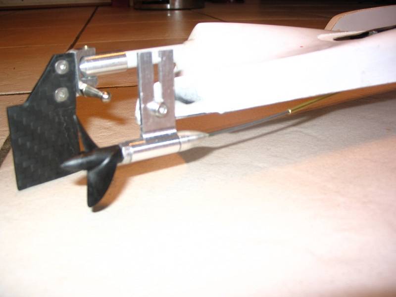

Easy rider's Avatar
Joined: Mar 2003
Posts: 752
From: Belgium - Europe, BELGIUM
Default RE: how to make a wire drive?
Picture :
Old 07-19-2007 | 05:00 PM
Joined: Sep 2003
Posts: 97
From: st joseph, BARBADOS
Wow, many thanks Easy
I've been reading about these things for a couple of days and still didn't understand!
I made a mock-up where the stuffing tube actually bent with the wire. Surprisingly that didn't bind that much .. just about slightly more than my solid shaft.
I see the light.
Now I have to decide if I want to do my bend in the hull or after the transom. If I do it internally my drive angle will be fixed at 0 degrees. If I go external I'll need to strengthen my rudder stand-off to act as a strut bracket.
Do Mono's really need positive strut angle (prop face pointing to the sky)? I'd initially planned on a fixed set up.
Actually an external bend might not be possible on a 15" mono without setting the prop way back .....
Conversley an internal set up might leak a sieve.
Old 07-19-2007 | 05:09 PM
Easy rider's Avatar
Joined: Mar 2003
Posts: 752
I don't understand why you want to bend it ? I don't bend the tube at all. The tube in the boat is in straight line with the motor shaft. And the tube part that exits the hull is also straight. The wire will bend good enough outside of the tube. There is no need to use a very long tube. If the tube exits the hull for about 3" it's good.
I see , you probably mounted the motor horizontally right ? You should mount the motor facing down in a straight line with the bras prop tube. This causes no drag whatsoever. The prop turns like a Swiss watch.
Old 07-19-2007 | 05:36 PM
Joined: Sep 2003
Posts: 97
No I don't want to bend the stuffing tube .. now that I know better
My motor was set up for solid shaft so it points directly to the keel at the transom
The problem I face is that if I exit at the transom, run 3'' of exposed wire then connect to a shaft, my prop is now 4+ " aft of the hull ... that’s way far back on a 15" boat .. or is it?
If I do the bend internally, I'd expose the wire for @2" before meeting the drive shaft at the transom ... problem there is even I telescope to some thin tubing where the wire enters the shaft, there won't be a lot of thin tubing to stop the water entering.
