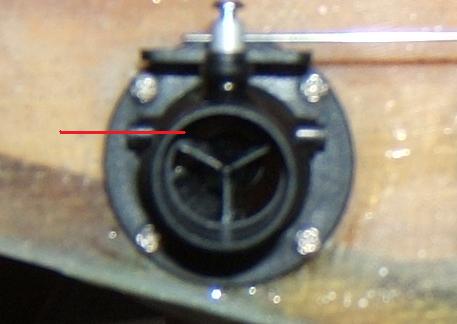

oh the outrunner... that was easy, just drilled three holes in the jet drive mount where I wanted the screws in, made the holes the same size as the screws and just screwed them directly in, had enuff bite.
This was done in the boat so the holes were off, used a 20cm long flexible drill bit.
Your using a 6600? Geez a bit overboard? If these drives are similar to the kehrer drives, the jet would run on 15000-20000 loaded. I'm now going to use a 3200rpm/kv 25 amp (the red motor in the pics) at 7.4v, I bought another 11.1 to replace the lipo I messed just to see if I can get the boat to run at that speed without the porpoising.

ok this is hard to explain first you know where the reverse flap mounts to the nossil you drill the center of the pin in to the pump just in front of the impeller . drill on the red line you can do this on eather side
#46
Joined: Aug 2007
Posts: 1,173
From: Waterloo,
ON, CANADA
Yea I got it after looking at your other photos... does the bucket work if you do this? I would assume not. So really these weren't designed for cooling right? But work just as well?
#47
Joined: Jan 2007
Posts: 1,760
From: PORTLAND, TN
you can still use the reverse youll need to press in a pease of brass in the hole you drill to move the tubeing i plain on doing this just havent and i dont intend on useing it anyway . ill see what size bit i used tomarrow . yes its not inteded to be used as cooling but it scurts out a stream 4-5 " long after going threw the motor coil . and 6-8" just in and out
