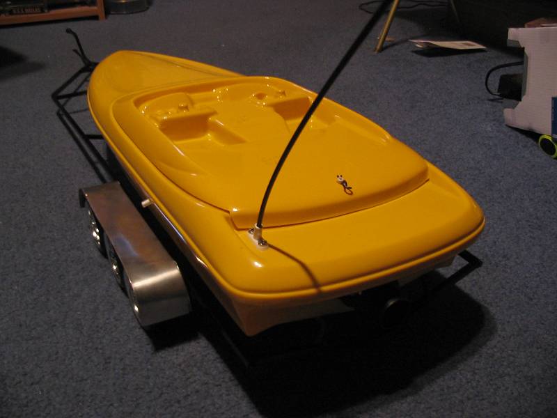

to start, heres my boat, I'm going to make a much larger post tonight with new good quality videos.

Joccee I was hoping you'd add yours, always liked that boat. Yeah, who'd have thought it would be me [sm=tongue_smile.gif]I figured a thread should be started, individual builds threads are great, but we should have a place to chat and bring it all together so all the new comers can see all the boats.
some more info
mines a villain IV hull
700sc motor
Jeti Navy 600 esc
Graupner 29mm jet drive pro2
16 IB 3600 cells
aluminum armored hull

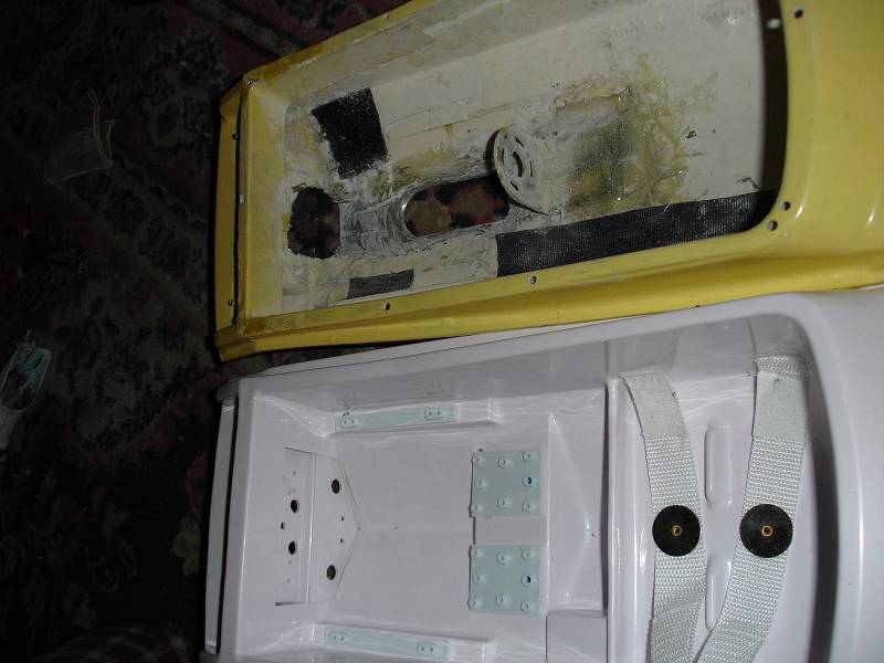

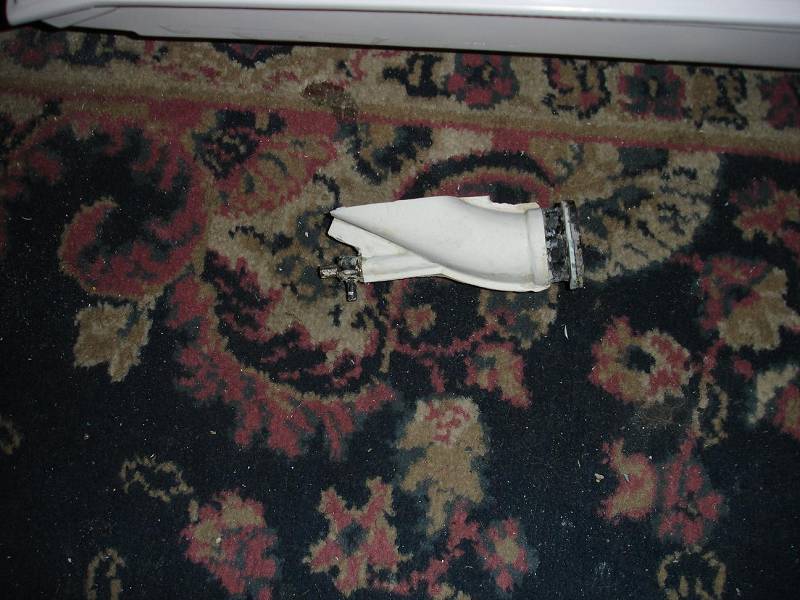

You wont see the jet villain ever again like it is, I'm taking the cutting wheel to it tonight. Making what will be the Jet-villain II.....to quote myself.
ORIGINAL: Quicksilver
ok, this is hard to explain, but I decided a compromise between what I want and the way the poll went. First it's getting the jet drive, however it will be removable and be able to be replaced with surface drive hardware within 20 minutes or so.
It's really tough to explain in words, but the jet isnt going in like the other, I'm going to install the jet unit, with the back of the intake at the transom. So effectively it will be moved aft 2 inches. Most of the unit will protrude out the back. Then I'm going to lube the drive duct inside the hull and glass the whole back, glassing right over the drive, what this will do is, create a tunnel in the hull, so if I pull the drive out from underneath the boat will still be watertight, this gives me the ability to still use a surface drive when I want.
I'm going to fabricate most of the surface drive hardware from aluminum, but may buy a speedmaster strut. That probably made no sense at all, so I'll have to explain with pictures as I build. Kind of excited, but it's going to be a lot of work, especially since I really want to do this right once and not have a frankenboat.
