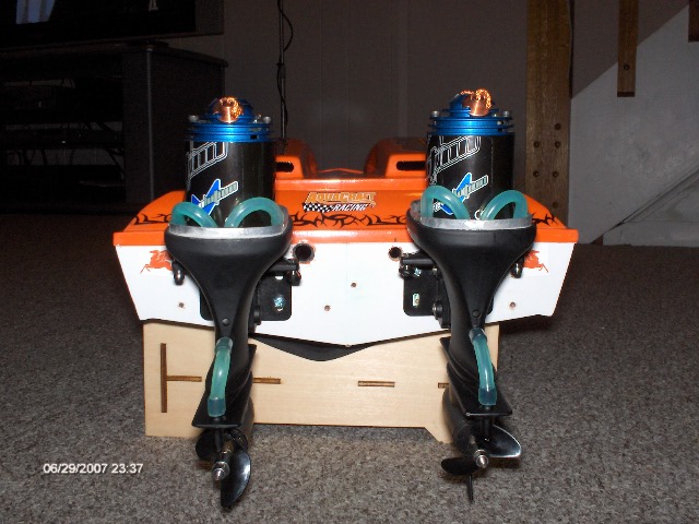

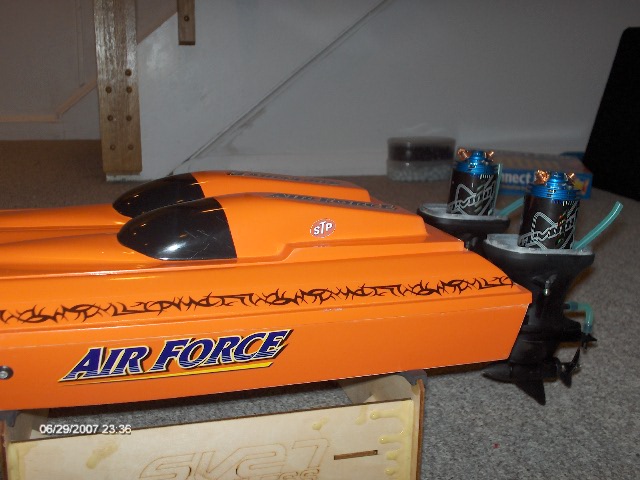

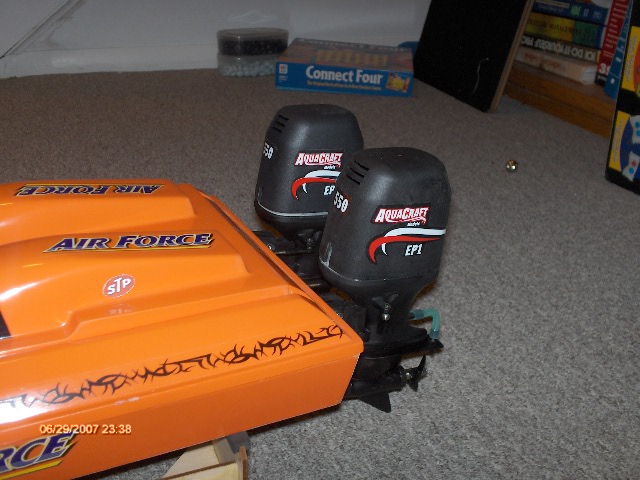

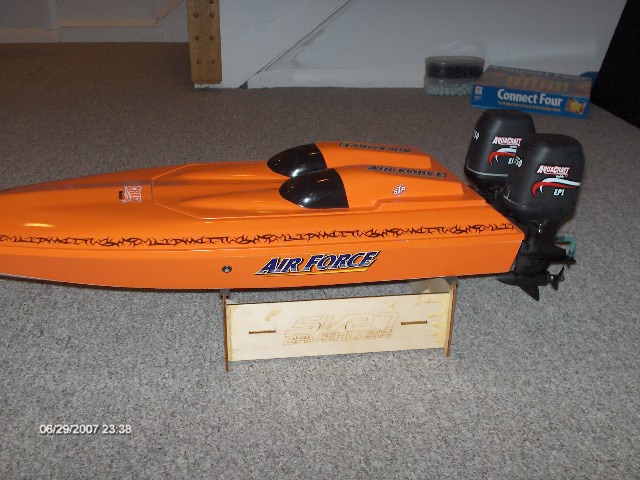

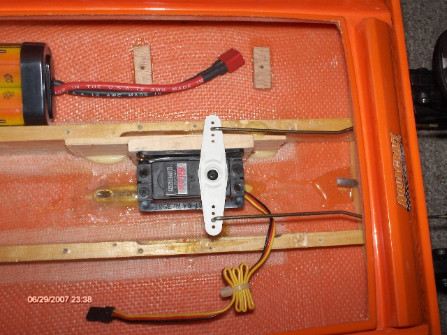

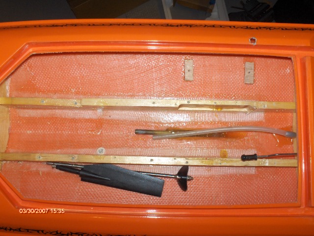

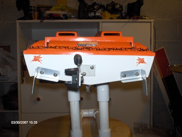

This is my Nitro Hammer to Dual electric outboard conversion. Sorry, the Nitro motor was not in the boat when I bought it. But the servo is mounted near where the nitro motor was.
100 pounds to me, means a very heavy boat. Disregarding that I would recommend, a Feigao 10L, 80A ESC, on 8 cells.
Place everything so that the batteries will allow you any adjustment for CofG. Your CofG should be around 27-33% from the rear of the transom as a starting point. Move your batteries to get with in this range. Usually these offshore eBay boats are built in electric and nitro versions. You can check out the electric version as far as placement goes.
