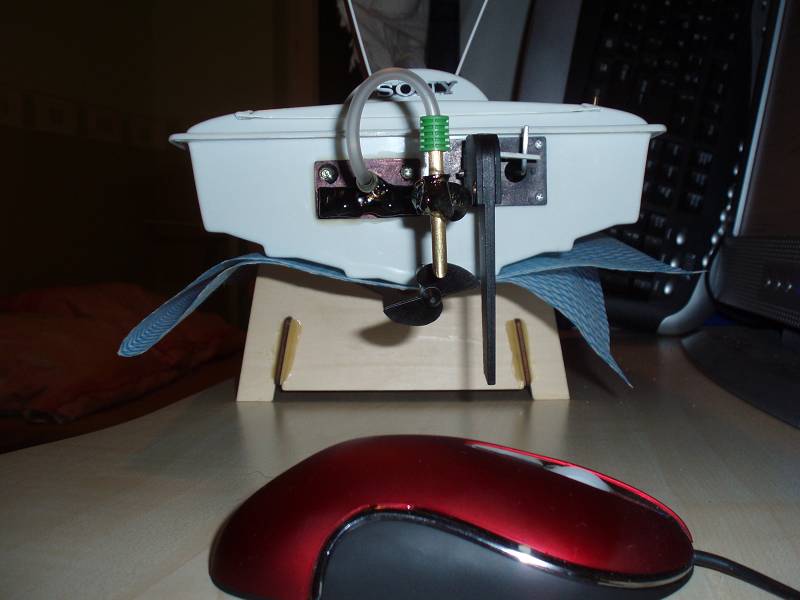

Drill a hole below the water line. The distance between a hole and water surface should be equal to the prop diameter. That means that if the boat doesn't run, the edges of prop touch the water surface.
My boat may be lighter or heavier than yours, this should NOT play any difference in where the prop shaft transom hole is placed!
On my old 24†and 27†mono, the prop shaft holes center was placed about 1/8 to 3/16†above the bottom of the vee. On my 46†mono, the prop shaft hole is place a little higher than ¼†above the bottom of the vee.
The edge of the prop touches the surface? So if I increase the number of cells used, drop in prop diameter, the hole must be higher up on the transom. You are going to end up with a hull that will not plane!
Also, you will only have the radius of the prop above the prop shaft center line.

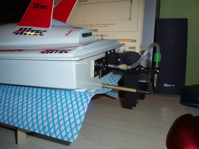

The rated voltage on the motors are industrial ratings specifying the voltage in which provides the best life and performance. The lower this voltage rating is, the higher the KV. A lot of these motors are not made specific to R/C and used in several industrial applications.
I have ran several 700 8.4v motors on 12 up to 14 cells for years. They run a long time on this voltage. Key point is, it isn’t voltage that burns up motors, it is current. This is controlled solely by the prop or load placed on a motor.
Graupner 700 8.4v motor has a kv of 1750 and will spin up to a loaded 20 000RPM on 12 cells. This is a pretty common setup for LSH and LSO racing.
ORIGINAL: peterpella
When boat is running only falf of prop should work in the water. So, how to determine where to put the prop shaft when is not running, during assembly, to get such effect? I know how to do it, does Ryan too? Any theoretical opinions? Maybe some mathematics?
I found that if the prop shaft exits the boat a little higher such as 1/8†clearance for 22-30†mono’s from the bottom of the vee to the bottom of the prop shaft, much better handling and performance are expected.

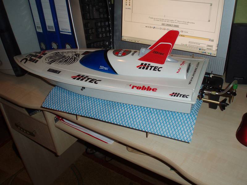

Peterpella I don't know how mutch experience you have, but ryan just kicked your ass quite hard. Please be patient to learn that way something more.
I have almost zero experience with brushed motors but my opinion was = ryan.
Besides why your boats shaft exits hull so high? when it will go on plane your prop will push air...
