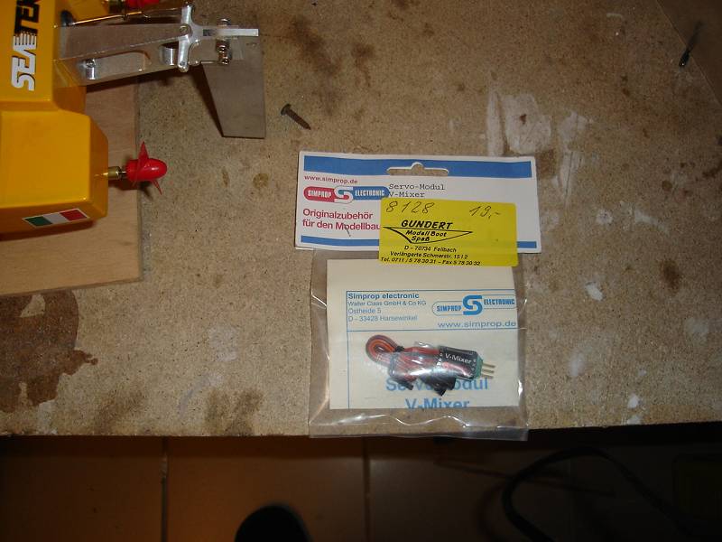

I recently bought a MHZ micro-iceberg on ebay, with all the hardware less motors and escs included. Amongst the things included were a servo-y lead extension (which i assume is for both ESCs) to go into the receiver. Also with the stuff was a simprop v-mixer. I've seen similar stuff advertised elsewhere "for use with dual-drive boats", but not sure whether adding this mixer will help or not. Finally my ESCs and motors for the Micro-Iceberg are here and so far hooked them up using the y-leads (not tried it in the water)....What will the channel mixer do? how do i hook it up? basically it's got 2 female sockets and 2 male plugs (jr brown, red and yellow type)...any ideas? anyone?

the V mixer will be weird. i believe it is meant for V tail planes.
any way when you drive straight both power the both motor. as soon as you turn it will drop speed int he one motor as well as turn your rudder
i think that is how it should work

Gee thanks. On the packaging it says it's a servo mixer, but i assumed this wouldn't apply here since i only have one servo. Now the wiring's gonna be a matter of trial and error, but we'll see...In any case, props still aren't here, and the ones i've gott are these plastic jokes by robbe, don't even feel like getting the boat wet cos i'm 95% sure they won't perform as proper props should...(k series graupner for the trial fit, then perhaps something more substantial....

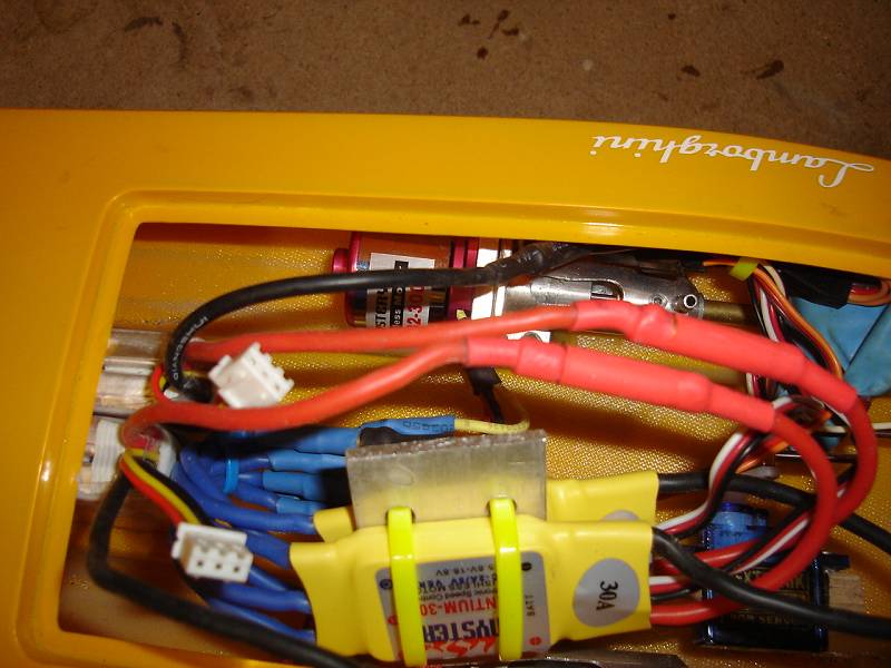

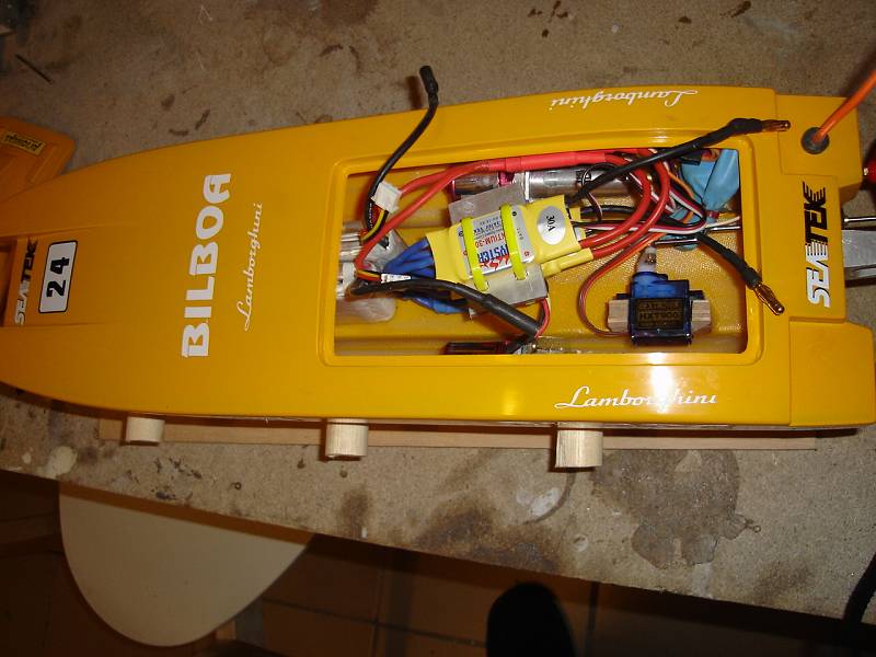

If not i'll hook up the mixer. If i understand the instructions correctly both ESCS feed into it, then one of its leads feeds into the receiver and the other one hooks onto the servo. It's a weird build for me, as i'm hardly following anything i learnt on my other projects - never run outrunners, never run twin drives, certainly not without cooling....and never had so many shiny new parts in one boat
In any case the micro-niceberg (is what i'm calling it until the first time she hits the water and things start going wrong) now weighs 760 grams with the lipos.
Hardware and electrics details are as follows:
2 x 2mm gundert wire drives with m4 stubs running in 4mm tubes and 2mm bushings at the ends
2 x 2mm turned alu motor mounts and motor aligners (with lube pipes) from gundert
1 x 110mm CNC alu rudder (from gundert)
2 x 33mm counter-rotating props (graupner k series are all i found at the lhs) - will try the robbe plastic 35mm with less pitch - but not really trusting them
2 x mystery 30A brushless escs
2 x mystery 3000kv outrunners (about 50 grams each)
2 x solid alu couplers
1 x hxt micro-servo
2 x 2s 1300mAh 20c lipos (loong max)

ps- v-mixer not necessary. Ran great with y leads...
