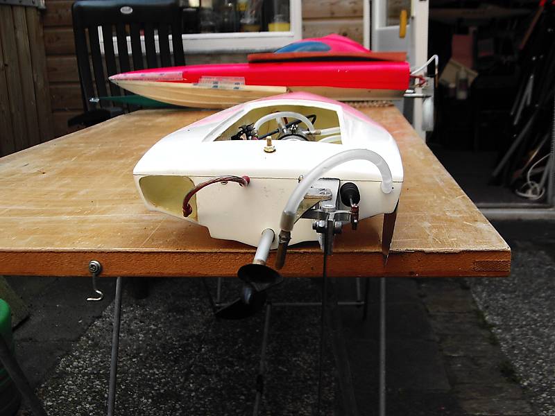

ORIGINAL: Steve441
What about the water pick-up for cooling ESC an motor - Is the flush hull mounted pick-up better than rudder pick-up?
Hi Steve,
Both a rudder pickup and the 'flush' mounted one have a certain amount of drag, as has anything sticking out from under the hull.
If you have a temperature sensitive set-up (on the edge, so to speak), the rudder pickup is my favourite, as it ensures flow through the system at all times, exept when you flip the boat.
A truly flush mounted pick-up, would be a brass or aluminum pipe facing forward as a pick-up and a second one facing towards the transom as outlet, both sanded flush with the hull.
This is a pressureless system that has virtually no drag and generates flow at all times.
I use a spray pick-up on my fast electrics, where the pick-up sits in the propspray in the upper right quadrant, seen from the rear.
The propspray has an average pressure of 2 Bar, so there's always flow and very, very littte drag.
Take your pick...
The faster your set-up, the less drag you'll want, to avoid handling issues when approaching the hull limit.
Regards, Jan.

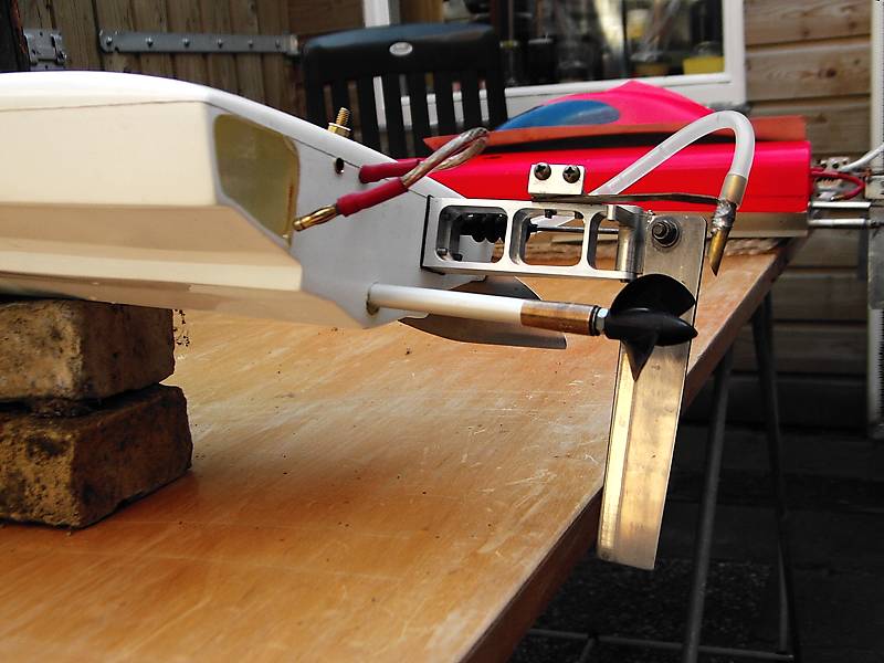

Thanks Jan - Spray Pick-up is for me - Looks like it will get a great flow of water - Do I have to customize such a part ? - I will check Off-Shore Electrics and such. As for a stinger outdrive or strut - I won't be racing this boat - but I want it nice and fast with the best steering capibilities - Our lake is nice and calm in the bay but there are a couple of rafts and docks so handleing is important - I shall do my homework and am learnig lots and always welcome advice - Steve
Old 06-20-2008 | 12:51 PM
Joined: Jan 2004
Posts: 2,451
From: Sneek, NETHERLANDS
Default RE: New Hull - Hardware Advice Please
Most likely,
I made mine out of brass strip with a piece of 4mm brass tubing, angled in the correct position.
I made a cardboard template first.
The pick-up can also be a simple bent brass tube like the one in the picture, it all depends on how far it has to extend from the transom without flexing under the pressure from the spray.
My appologies for the poor quality of some pics, it's hard to see the pick-up in some, but the pics were not shot with a pick-up in mind...
Hope you get the idea.
Regards, Jan.
