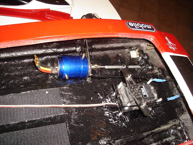

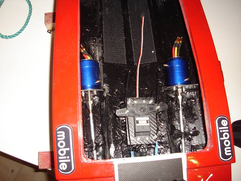

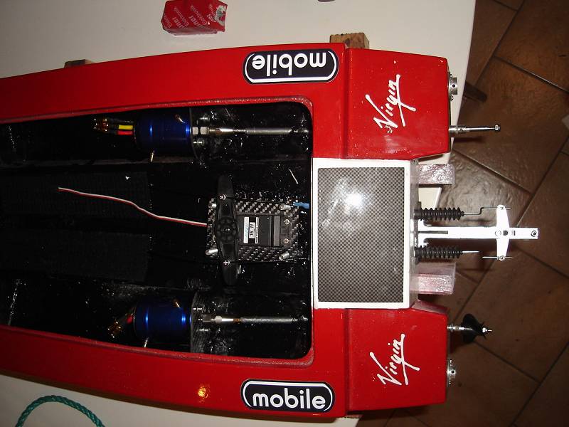

worked on the cat this weekend. Fabricated the motor mounts, epoxied them in. Resprayed the canopy. Mounted a new rudder, because I needed the old one for the cyclone mono (i had borrowed it for the trial fit). Installed the servo. cut the flexcables and epoxied the stuffing tubes in. I'm a bit worried about the drives i made. They still have a little play in them. I'm going to epoxy the hoops onto the outdrive for strenth. Maybe add chopped cf roving to the mix. Here are the pics.
#47
Joined: Feb 2003
Posts: 388
From: Europe, HUNGARY
Very nice Stokes!</p>
They KB's look nice with those water jackets. Hope they perform well. Have you changed their bearings? I heard somewhere someonw did it as a preventive action. Are you using Graupner carbon props? What diameter?
Could you make a close-up pic of the water pick up on the bottom?</p>
