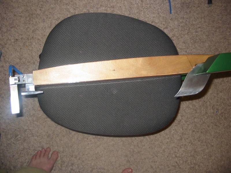

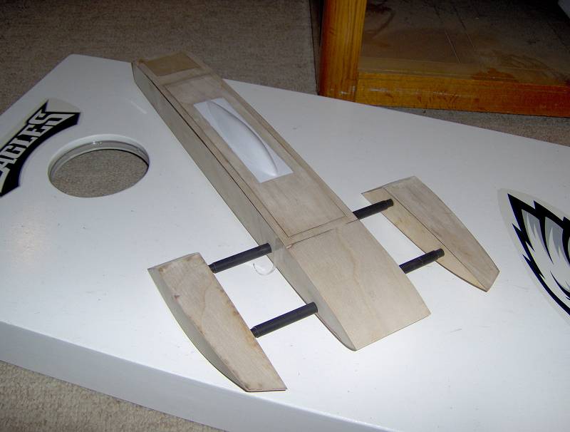

Some of the hardware on.[img][/img]

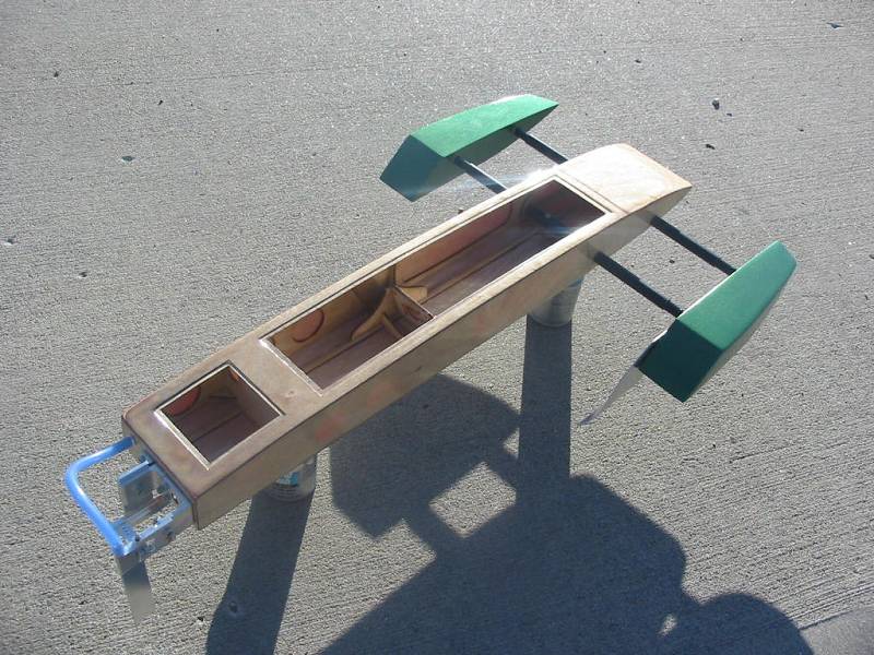

I wish you luck with your 7xl power setup...hopefully it will live a long time without the esc going up in smoke. If I were you, I would use the new MarinePower lipo's with 6.5 bullet connectors for added insurance.
BTW thats a cool color Green. What type of paint did you use?

The color is real car paint put in cans it is a toyota color i have the paint code but not sure what the name is.Ita a yellow green metalic color.

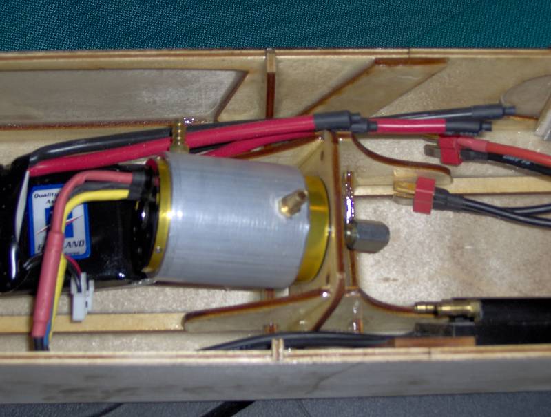

one more pic.[img][/img]

jake DW, your boat looks fantastic!!!! nice work man.

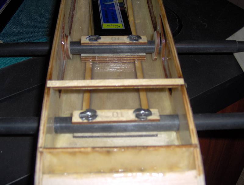

Hey JakeDW!
You have made some great progress and looks good too!
I have only done a bit more due to being busy at work. I used some t-nuts in the booms instead of the aircraft nuts because it sits just a hair lower than the nuts.
Here are a few pics for you to check out anyhow...

Looking good Hotwater thoes are blind nuts.

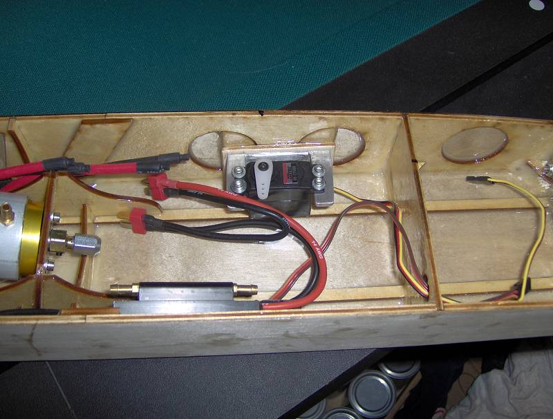

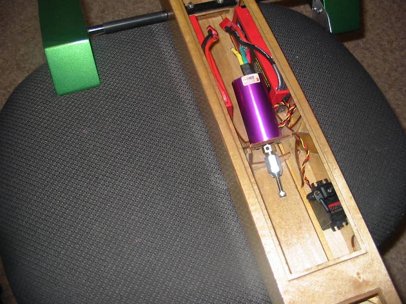

Messing around with placement ideas what do you think of the hardcase lipos on the sides?These are 28c 5000 SMC lipo.

Looks cool to me Jake! I think I am going along the same route that detox took. I like the way that he can move the lipos to change the CG easily.

Jake it looks like it would work. Where about is your C of G on it with that setup. I would suspect it would be right about in the center of the motor. that is a good spot for it.

The CG is about the end of the motor but the stuffing tube,flex cable prop,and esc are not on the rigger yet so it will put more weight in the back to bring the cg back further moving the bats forward makes a huge difrence in 1 1/2 inches I can move them should be no problem changing the cg.

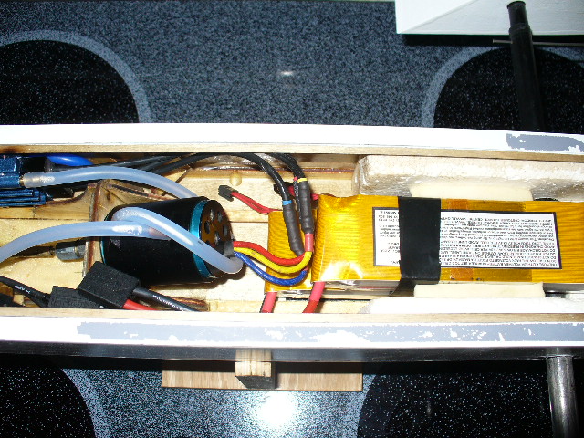

It is very important to test fit everything before ordering batteries.

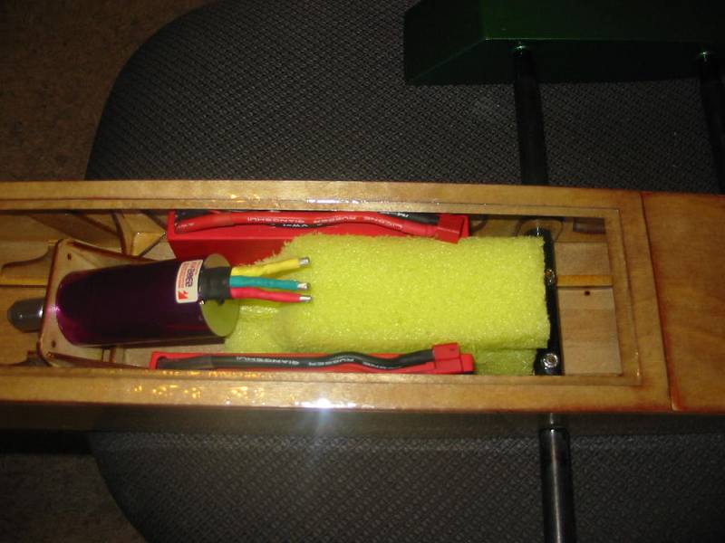

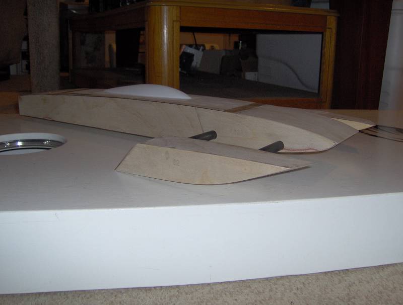

When I get done with the pool noodles it will conform to the lipos with no need for straping.[img][/img]

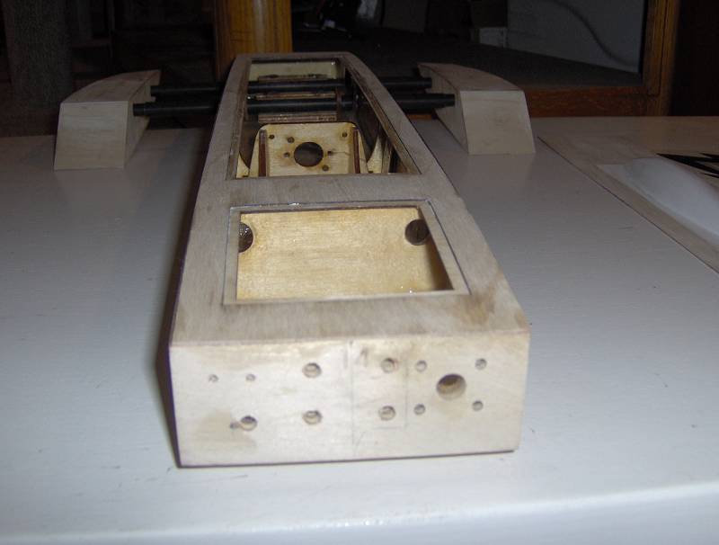

All hardware has been stripped and now ready to seal...Finally!!

What will you be using to seal wood before paint? I used Z POXY finishing resin applied with 1" foam brush then sanding between coats (total three coats on sponsons and just one coat on hull). I block sanded sponsons between coats and paint is smooth as glass. The hull did not turn out as smooth because of just one coat and minor sanding.
