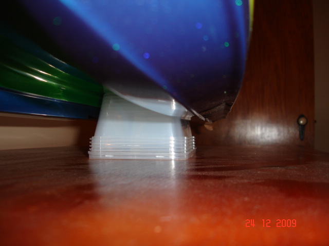

My friend, FSR racer , told me that he have tested sanding of bottom plane. He got up to 2 km/h plus on his FSR-15 with sanded bottom plane by a 240 grade sandpaper .
So polishing may get worse result.
For experiment try to move two pieces of glass with a water between them.

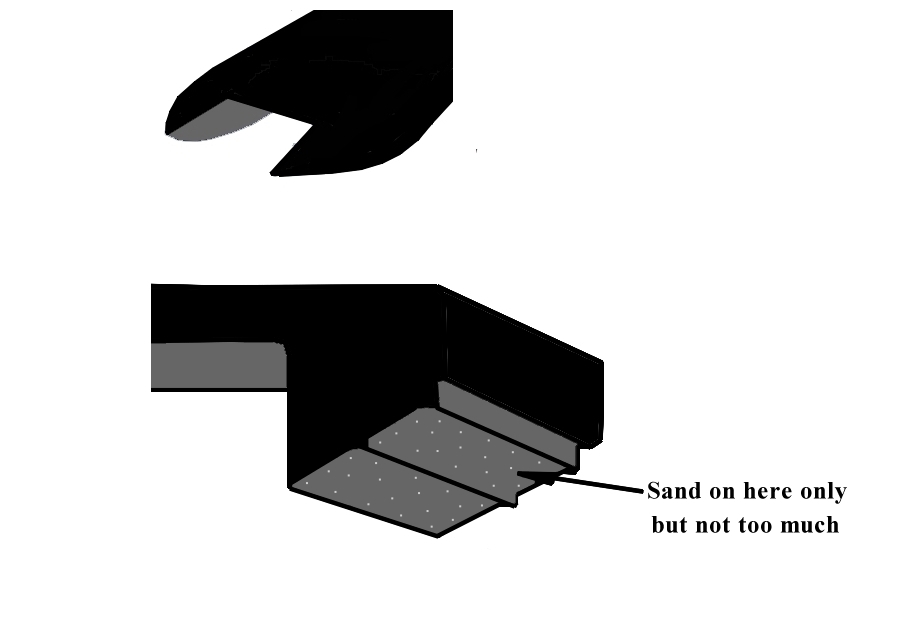

good, because a matt/ sanded paint is far easier to maintain than a shiny underside, especially if you have to repair a damaged hull, in fact; i'll do the whole underside in matt grey primer and cover the sponsons with epoxy/ fine sand, i'll redo my illustation and take a look at it right now. it looks great, even better than white, i've always liked ``Battleship`` grey anyway
i've used epoxy and sand before, it produces a rock hard finish, in fact; once it's on it's virtually impossible to strip off , this tells me that i'd better be very careful, it might be best to mix the sand into the epoxy and not too much of it either; and carefully paint it on.
because sprinkiling sand onto a wet surface wont work, its density will be far too much, just like a sheet of rough sand paper, it needs to be more like a grain of sand every 5 mm or so

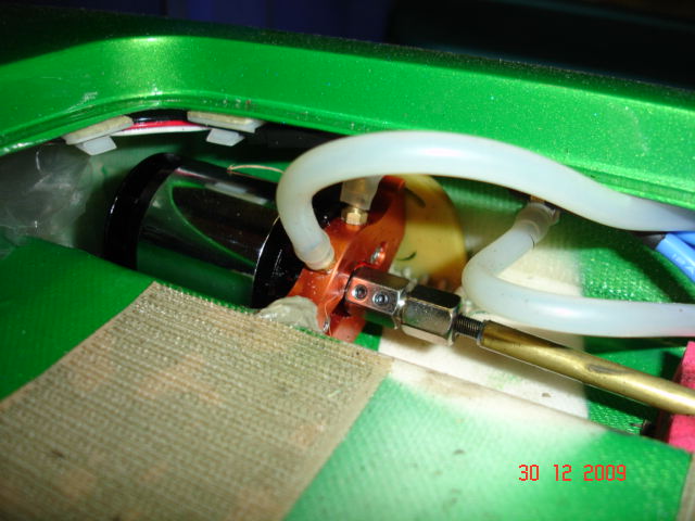

Motor`s water-cooled cans (not finished) 36 mm inner and 40mm outer diameters.
Motor`s mount plates

So guys, need advice about motors mount. Do you like the place of mount? I want to have much space for CG adjustment by the batteries. The batteries will be placed in the bottom of sponsons.
Old 12-24-2009 | 03:52 PM
  #91
Joined: Feb 2009
Posts: 96
From: Genemuiden, HI, NETHERLANDS
Default RE: 32' cat twin powered
You CAN'T determine the position of the motors without all the stuff that needs to be in the hull !
Put everything in the hull at about the right places.
make sure you can move the lipo's to change the CG.
The space left is meant to be for the motors.

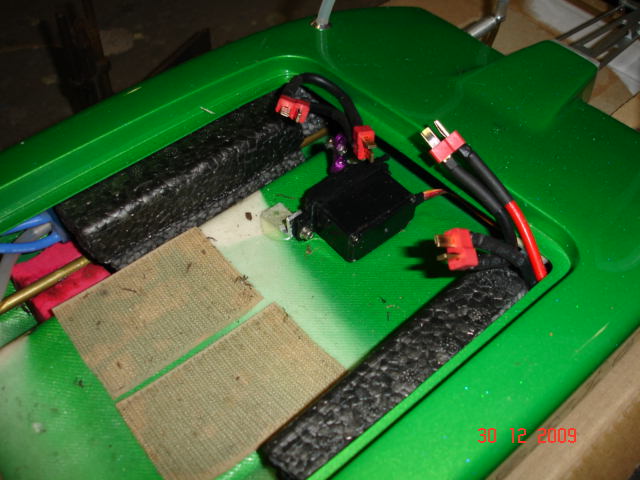

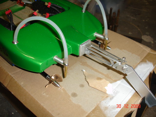

Hi
Good attitude of cat! Congratulations!
Could you show me some details of the interior? servo placement and mount.
What is the setup, weight?
I think the outrunners are to hot.

From: Kiev, UKRAINE
ORIGINAL: Gerwin Brommer
It is too easy make placement having all necessary stuff. But I haven`t battery now. No reason to buy them in winter.
I will buy them in spring from fresh lot.
And Li-Po can be 4S or 5S. So in this case I placed motors as closer as possible to transom. The left space for batteries.

The weight is 3.45kilos It has twin hb3650 hobbymate outrunners on 100a flyermate esc and 8x2300 a123 per motor. 4mm flex shafts with modded x442 l&r props. I have only ran the boat 4 times and i`m a bit unsure of it but it does handle very well I think. Need to learn much more.

ORIGINAL: gen3v8
Nice carbon/kevlar composite. Should i strengthen mine?
Thank you for the fotos. I should think out about vertical servo mount. I want wired pushrods.
It is 160 g/m2 carbon-kevlar on a Larit-285 epoxy. I didn`t want to make reinforcement because it sould be maked on a molding stage but one man persuade me to do it. And he was right. The hull now is hard no twists. It is additional reinforcement of gluing of bottom and top part of hull. Kevlar is leyed up to entrance of deck. Scratch surface well before gluing.
