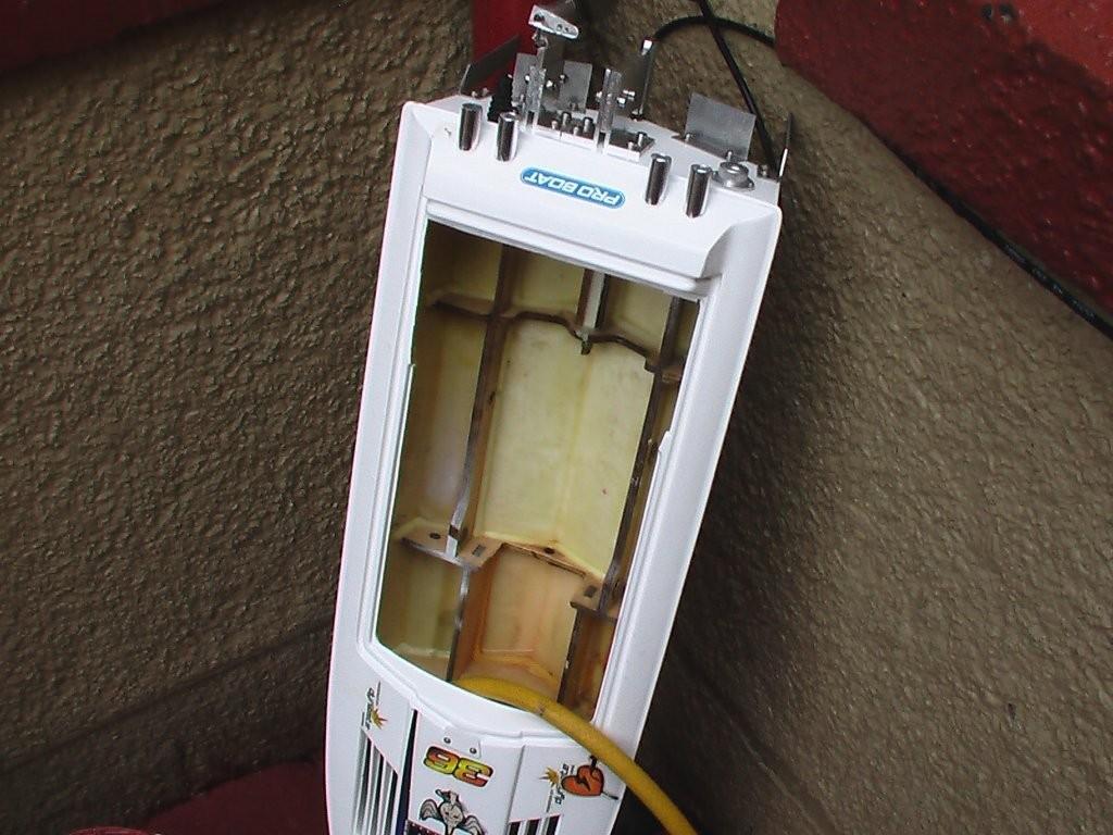

day off work today so got stuck in.
Stripped all the inards out and degeased the inside,what a mess!!
Ground a larger area where the lipos will sit after checking cog with all the stuff placed inside,i went for a rough 30% from transom???
I intend to strengthen the hull floor with a good layer of slow drying epoxy where the motor mount will sit,it is very thin..
Plenty of vent holes to fill too.

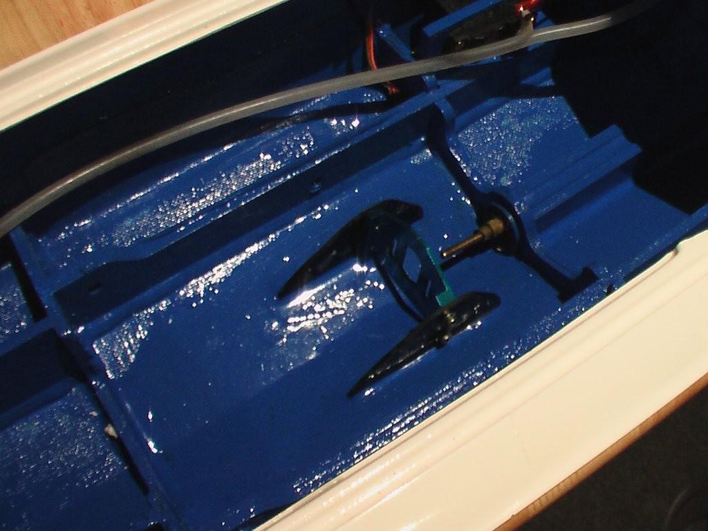

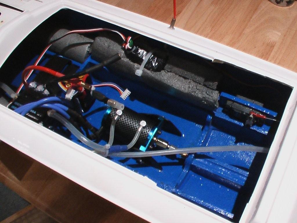

Managed to get a bit more done.
Fitted the Etti motor mount after reinforcing the mount area with some slow setting epoxy,very slow drying,its the supposidly 30 minute stuff from Hobbyking,more like 24hrs,nice and strong though..
Painted the inside with some car engine enamal,quick drying and fuel and water proof,looks a bit neater and easier to see if water is entering the hull.I try to do all my hulls with it.One coat is sufficient.
The original Shockwave flex is a .187 flex with a .187 stub shaft,my motor coupler is a .150 collet and i have a few spare 150 flex,187 stubshaft,so i fitted a 150 flex stuffing tube inside the old shockwave 187 stuffing tube,it fits great.
Filled in all the deck holes with some 5 minute epoxy and shoved some wet paper mache down the rear 'exhaust' stainless tubes and then filled with some slow drying epoxy.
Also i cut the radio box out of the hull,not needed with FE tape,i crafted a servo holder from the old radio box and glued it in place.
Fitted the motor 4mm connectors onto the esc and fitted some 5.5mm for the power leads.
Cant go much further until i test the empty hull in the bath tomorrow to check for water leaks.
Plus programmed the Seaking 180 esc.These escs dont seem to like a cutoff limit for lipos,cutting of at the wrong voltage.
I always program them for 'no cutoff',and they seem to work well.Its obvious when volts are starting to drop a bit when we run our boats and then bring them in slowly.
I am also going to angle the turn fins as i've read thats the way to go for these hulls.
Also going to trim the rudder down a bit in height.

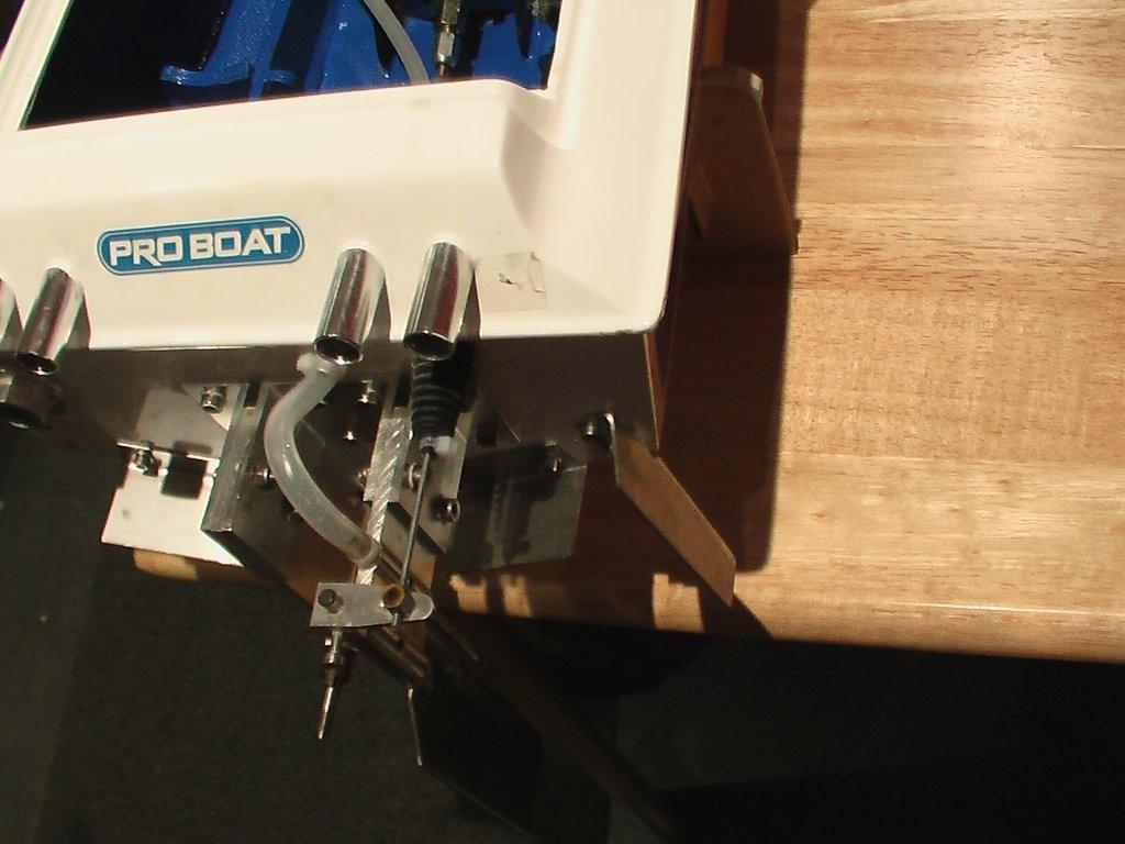

Update.the boat took a ton of water up the original flexshaft tube,i kinda thought it would.maybe as much as 1.1/2 pints!!on an eight min.run.Amazingly the Turnigy ESC and servo still work..they were completely submerged.
basically the motor is sat too low and just drips in fast.
Ripped the motor and mount out,a bit of heat from a small gas blow torch melted the epoxy easily.
i plan on mounting the motor towards the front on top of the cross member stringers and then the 2 lipo packs on the side of the hull.
i need a longer flex shaft which will take a few days.
Also i now have a spare 2000kv 80mm medusa motor from another boat(long story) which i will fit instead of the 2300kv 70mm medusa,which ran ok but a lower KV will be more torque and longer run times on the same 4S 10000mah packs.
I will post some more pics when i get the flex shaft in.

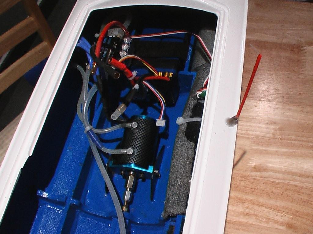

Changed the motor for a 80mm 2000kv Medusa motor and mounted it higher this time.It needed a longer flex shaft.
Fitted the 2 lipo packs in the centre this time,which were easier to fix down.
Ran well this afto with a detongued X645 prop.
After 6 mins the packs only took 3250mah! which is an average draw of only 35amps.
It has gone a bit noisy which i think is resonace from the Shockwave strut.I will have to source some better bearings for the 3/16 stubshaft.
last run of the day was about 12 mins.Lipos/motor come back barely warm.
Bit of video with jack,my son,racing a Dr Psycho mono2 boat again on 4S lipo.
Not one drop of water inside the hull[8D]
