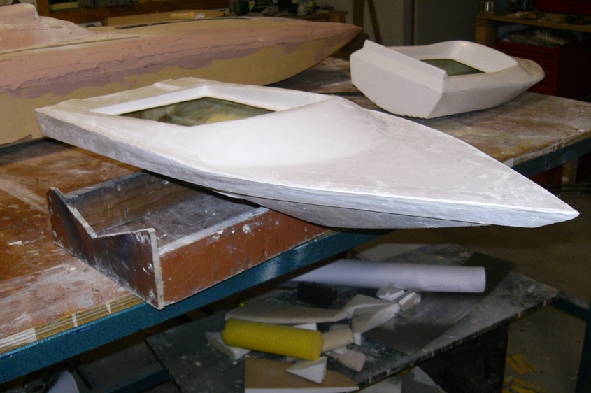

Hi all, i am curious, why isn't there much out there of actual scale monohull boats with outboard motors?
I know there has been a few avid builders out there that have dabbled on this thought, i would be for sure interested on hearing from them and seeing a few photos.
I am building a 1/6 scale version of a 1650 Bullet hull ski boat with the intention on putting a brushless outboard on it, i am just keen to hear from any othere that have done this before with any success.
Cheers
Cheers

Yep will be cool, just seems like it was an idea rc boaters had back in the 90's, and not necessarily an ide of the 2000's ???? everyone seems hellbent on building tunnels.
I will be posting pics of my build here as it progresses.

Thanks guy's, as i expected, i had seen one outboard on a mono a while ago and as you said it had the cog in the wrong place.
I was trying to correct this by making the hull 860mm long , it seems a little excessive for a brushless outboard but it may also help to reduce the weight i need in the nose, i have also added a flat area near the transom going up nearly 2/3 the length of the hull to create a ride pad.
I am also going to experiment with power trim???/ I know this has also been tried in the past but it all can help.
Just wondering on where it will be best for the COG , 35% , 30% ??????
Cheers
Cheers

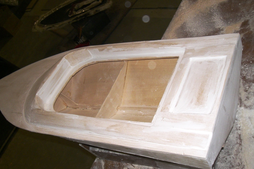

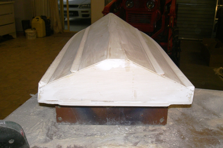

I have now finished laying up the mold, will be hopefully laying up the first hull within a few days. Will post the build here as it progresses.
EP1's hey? from my understanding that they didn't have too strong gears and will not cope with large amounts of power??? I will be using a Hyper leg, ul-1 motor on 3-4s. just pity there isn't a strong scale outboard out there.
The problem i see with the lack of outboard mono's is that no one out there seems to be building a dedicated outboard hull? correct me if i'm wrong.

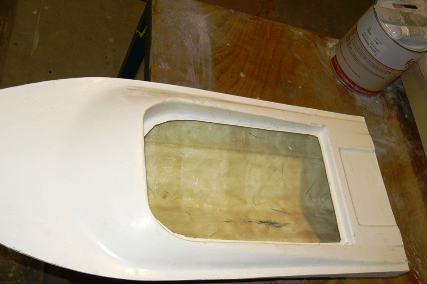

Hi all , just a little update, managed to get the first hull out of the mold, should have spent more time on the polishing of the mold as the hull really didn't want to come out , but alot of persuation and out it came. Tried Latex molds first but didn't seem to want to play the game so went back to the glass molds....Man i am sick of sanding /polishing....
Hoping to have it on the water very soon, thinking on puting remote trim on it too???

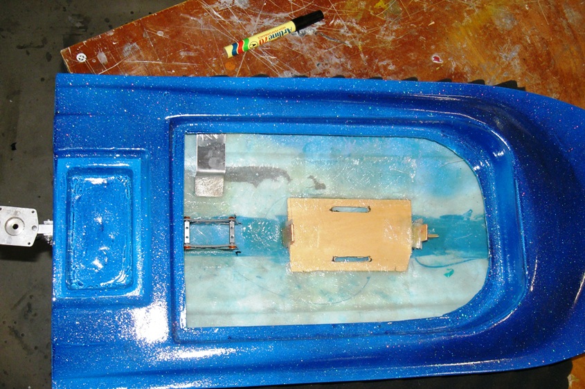

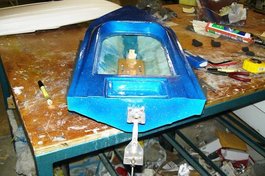

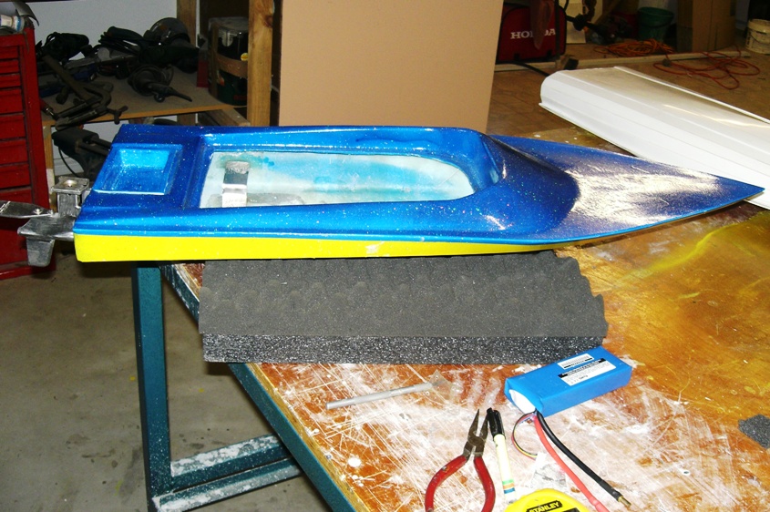

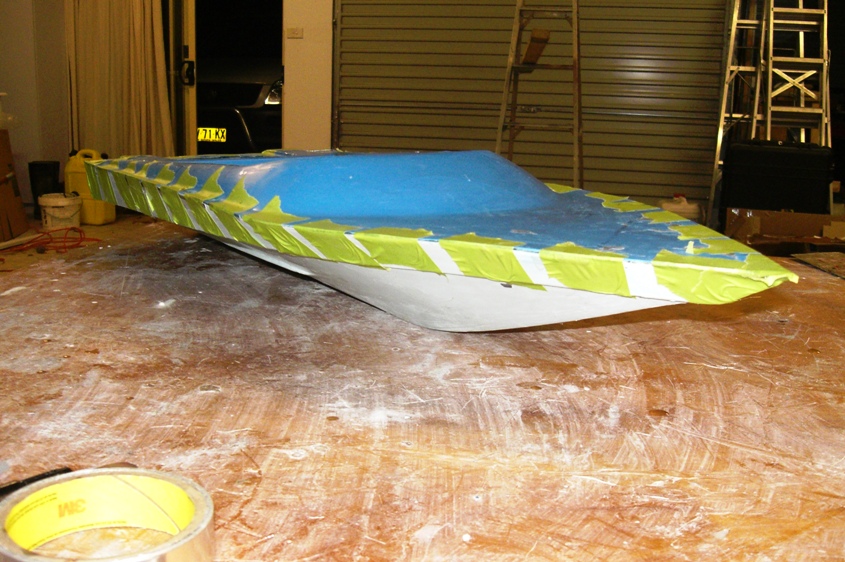

Hello all, well hull is painted and just starting to fit out the hull. may even see the water within the next week ????

Thanks, only have to plumb in the servo for steering then that's it, am thinking on using the third channel on the radio for trim too ? has anyone got any pictures on this setup?
Cheers Mick

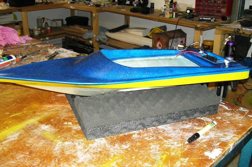

Hi , just thought i'd add a update, another hull on the way, this one is for someone else but has got me keen to revisit this idea and see if i can get it going better.
Cheers Mick

Hi JC, boat ran well, running it with a 3200kv on 3s was about the right amount of power, first run out i may not have had the leg setup right and when it got to about 30-35mph the wind just was too much and flipped it, tamed it down a little and ran very well considering, didn't seem to have toomany bad habbits.
Unfortunately no vids, and had sold the original boat so i could get onto another build, now am going to try again and get some footage for everyone.
Mick

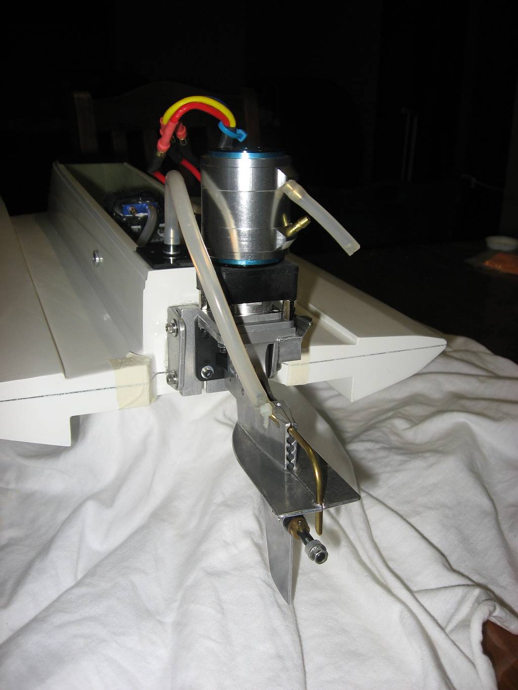

Here are a couple of pics of my outboard.
Makes me want to do an outboard mono now
. Anyway got a few projects that I need to finish first before doing the OB mono....There is a guy on Ebay that sells nice semi-scale hull perfect for that type of project. He is based in Australia.

Nice outboard, is that a K &B leg there ? I have only 2 Brushless outboard Tunnels and honestly i'm not a absolute fanatic but anything RC Boating is way too cool !
I have another tunnel project i'm working on at the moment , and i can honestly say you will not have seen anything like it before..... still in the molding process but i will expose it soon.
