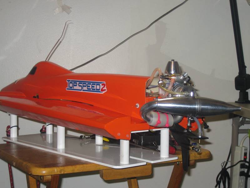

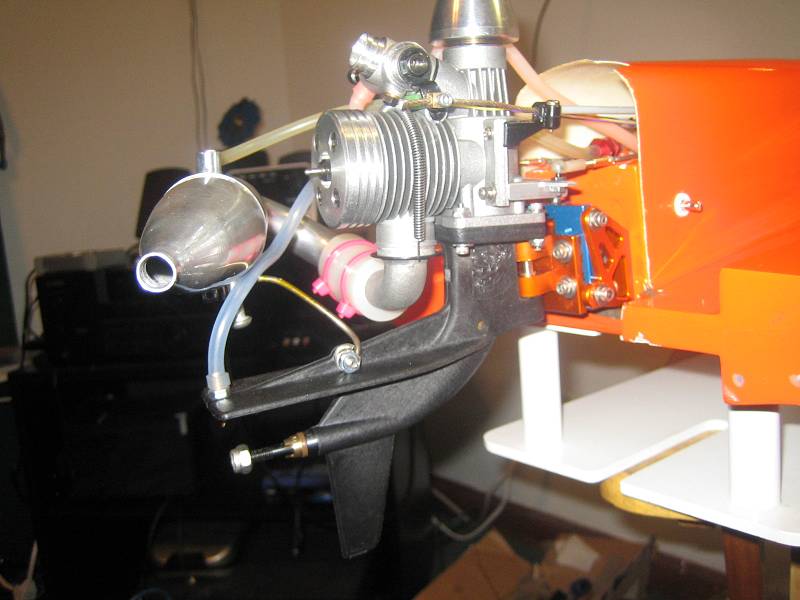

here we go!! the set-up i'm been longin' for..rossi powerhead and tuned pipe, irwin lower CF, hi-jack motor mount...break-in tomorrow planning to extend my lunch break at work so i can run this in the local park pond,,ppsstt! don't tell anybody.[sm=lol.gif]..i can't wait the weekend...the OS xm will be the stock B tunnel....

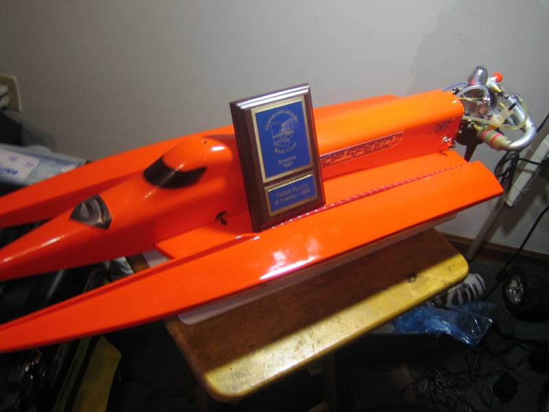

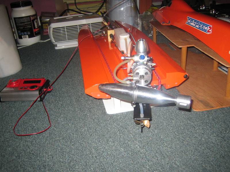

i'm so much carried away of happiness[sm=biggrin.gif][sm=biggrin.gif],,just got my very very first award plaques in boat racing since i started this year...3rd place in 3.5 and 2nd place in 7.5 tunnel...u guys up north of ohio rocks!!!
