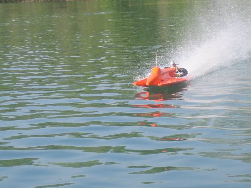

hey guys, how's ur ts2 goin?,,i'm still tweakin' and lookin' for the sweet spot coz porpoise and hooking still my problem, it's really time consuming but i enjoyed it, kinda challenging...i'm trying to analyze why ts2 porpoise and hook so much, maybe because the bottom of the spoonson is so flat particularly in the front half, instead of a little round or curvy... with flat front bottom spoonson, the bow will dig as soon as the boat slows down during turning and causes hooking, maybe with the rounded or curvy front bottom spoonson it will prevent the bow to dig because of its bouyancy that will keep the boat in a positive angle of attack.
btw, took some shot in action still gaining speed so far clock it 45mph and most of the run is 39-43 mph..

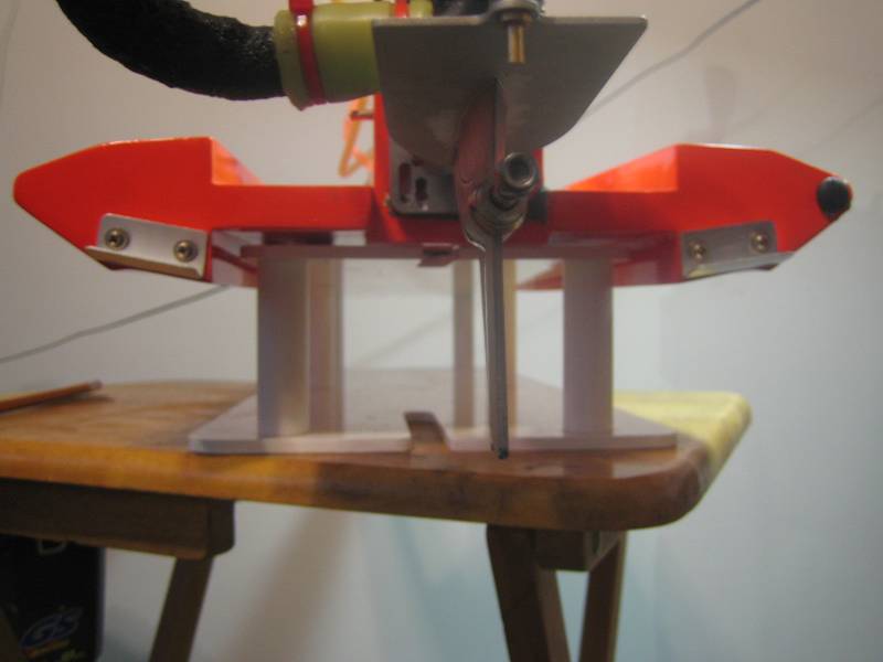

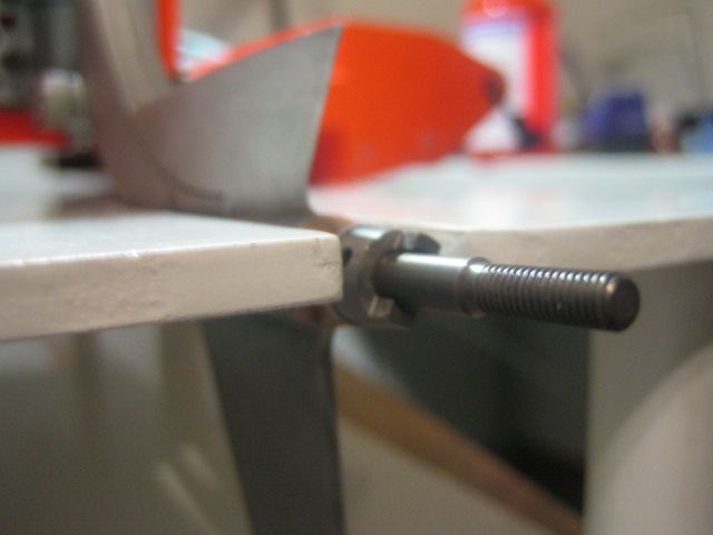

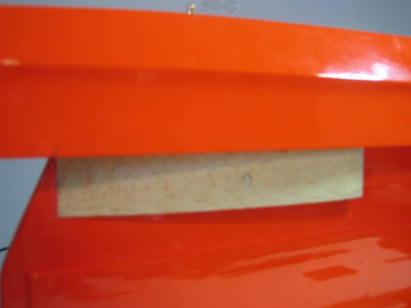

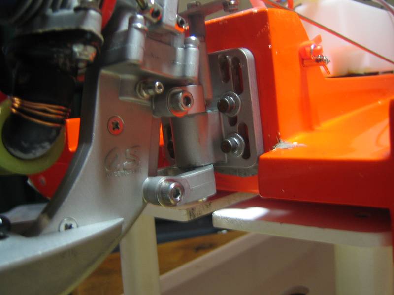

just messing around with my ts2 and decided to put trim tab, might help cure the bouncing/hooking, although it's against the rule but just to give a try, can't wait for saturday to come for the test..

spent the whole pm tweakin ts2, tried 2 different kind of trim tab and maintained the CG in 9.5 but for my observation there is no significant change, bouncing and hooking still there, so i took it off, moved cg to 8 in, remove all the wts. in the front and placed it just rear of fuel tank, 7.5 oz wt., to my surprise ts2 went much better the good thing is boat was able to make turns in higher speed with mild hooking occassionaly but since i tried pushing a little bit hard new problem arised a spin-out occured now[:-] but it's all right coz i'll gonna mess the prop ht. next...

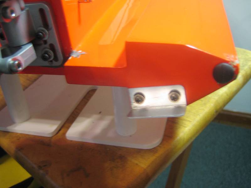

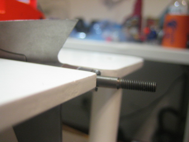

Anybody have some picture about a TS" with recovery pad? I would like to know How can I install these recovery?
Old 07-04-2006 | 08:31 AM
  #47
Joined: Aug 2005
Posts: 2,544
From: greendale, IN
Default RE: TS2 POST IT HERE...

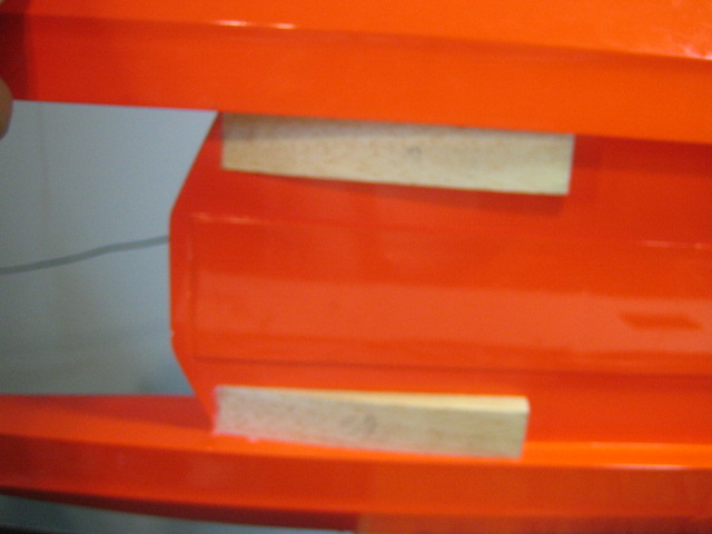

ORIGINAL: CARLOS LUIS
here's my recovery pads....
engine dropped more, prop angle measured 2-3 degrees, getting ready for test hope will make more improvement..

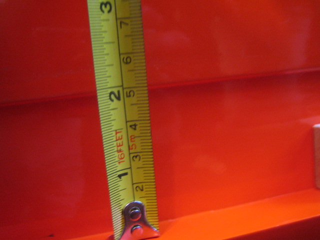

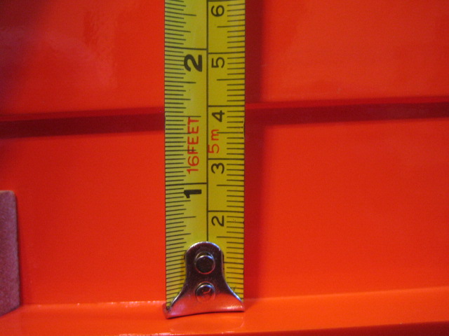

JD,
favor please look the measurement i'd noticed, the portside is wider than starboard by about 8mm, is this supposed to be like this?
thanks

Old 07-04-2006 | 10:25 AM
  #49
Joined: May 2006
Posts: 1,356
From: Lakewood, WA
The engine is offset to the right.
JD

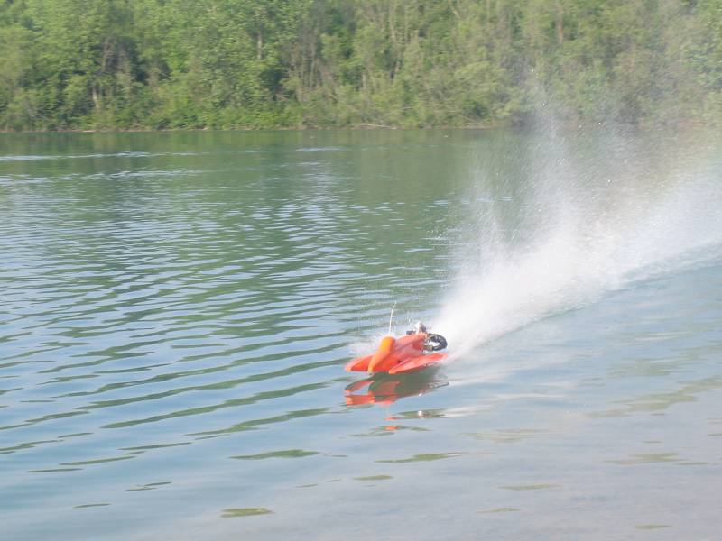

ORIGINAL: Jerry Dunlap
JD
Thanks Jerry, i'm still learning more about tunnels....
btw, my work on the ts2 last night was compensated, tested today, boat ran great, i thought since i dropped the engine i'll be getting problem to plane it but no problem bye bye bouncing and hooking in hi speed...so, no weights on the boat now, i even reverse the engine mount to be able to lower the engine, prop angled 2-3 degrees,.... now it's time to work for speed looking for 50+mph.
