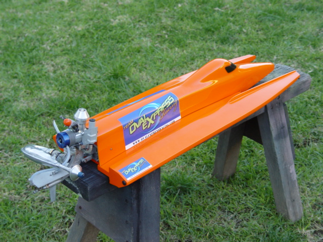

ozbryan
Join Date: Mar 2005
Location: sydney, AUSTRALIA
Posts: 181
Default RE: TS2 POST IT HERE...
ORIGINAL: ozbryan
Heres my ts2 with cmb green head on it
Just got another ts2 for my PER OS full mod motor
will be changing the paint work soon
heres my TS2 with the OER OS
