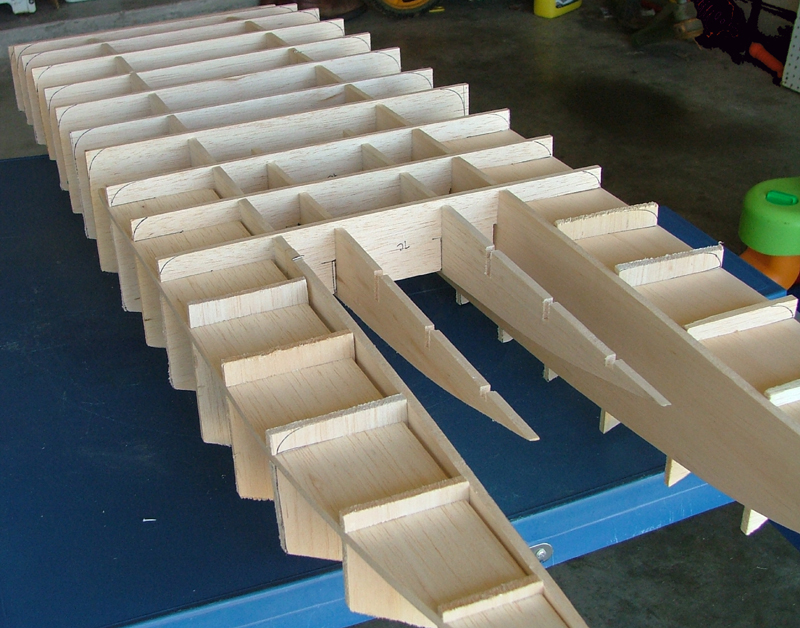

Hey Torquer,
If the hull is 55" long how far apart are you going to make the formers and are you going to have and spars in it? Im thinking of biulding one and yours looks great so I thought I could get some help from you.

Hi flyinJ: The formers are every 3 inches. The sides of the tunnel will be the main support for the formers. I'd be willing to help any way I can... I'm by no means an expert boat builder but I'll pass on what I can...
Byron: I got most of the main structure cut and picked up some epoxy today to seal it all up. Hopfully I'll get to mess with it some more this weekend...

thanks so what are you making the formers out of and skin?

The main structure is made out of 1/4" balsa. The engine bay will be boxed with 1/4" ply stringers. The skin is 1/32 ply and will be toped with glass...
Everthing is being test fit. Next the engine bay needs to be opened up...

looks good

About the only thing new to report is fitting and measuring the formers…making sure everything lines up square and fits perfectly. The next plan of attack is beefing up the rear section of the hull then open up the center of the hull to accommodate the engine, fuel tank, electronics and so on… Once that’s done, then it’s on to sealing the wood and putting together the superstructure.
I’m also waiting for the strut and rudder to arrive so that I can make sure that there won’t be any unforeseen problems with fit.
