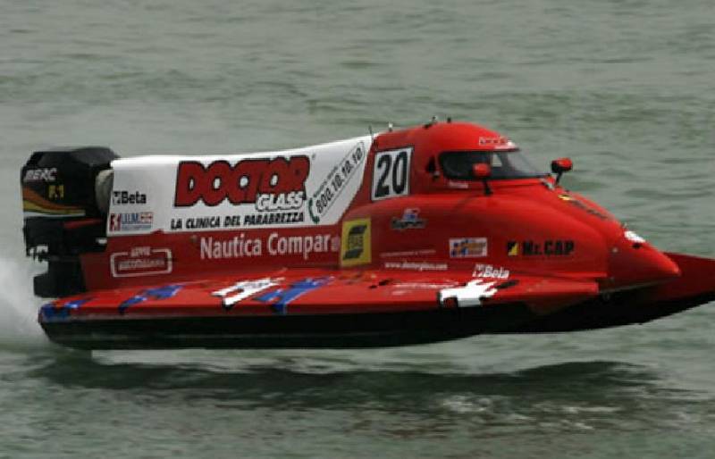

Here's a photo that is hard to find. This is the inside of a prop box of a current F1 Tunnelboat team. Save it to your desktop and zoom in with your mouse. Look at all the special shapes just one of these props carry. Study the leading edges all the way around, and also study the last outermost area of the face (handprint size area) - You will see some cupping and some rake changes, and also study the kick-out lips.
