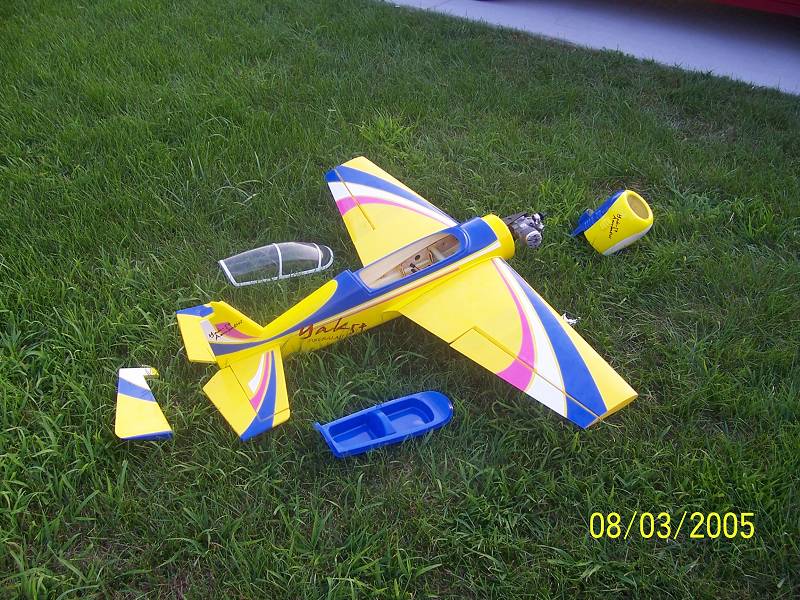

Hey everyone, I just started building my new Ultra-RC yak 54 .40-.50 size. This is the first one I found in this size range. It is an awesome fiberglass fuselage. Its the first ARF i've had that needed NO HEAT GUN or IRON work at all on the covering, what little there is anyways. The landing gear are very strong and Nice Carbon Fiber, not sure if its real, but good enough to fool someone who knows probablly. The paint on the fiberglass( or gel coat ) is excellent. I've seen a few other post on this plane, some good some bad, but I am truly amazed at what you get for $159 bucks! Here's some pictures. I want this thread to be a QA on this plane and also on some setup changes I'm doing. If anyone knows alot about rigging up pull-pull stuff with split elevators, SPEAK UP. I'd like ot go with that instead of the split pushrod way they show. It already has a good pull-pull system on the Rudder, so I want to go all out but need some advice so as to keep the split elevator pull-pull as light or !LIGHTER! than the split pushrod stuff.

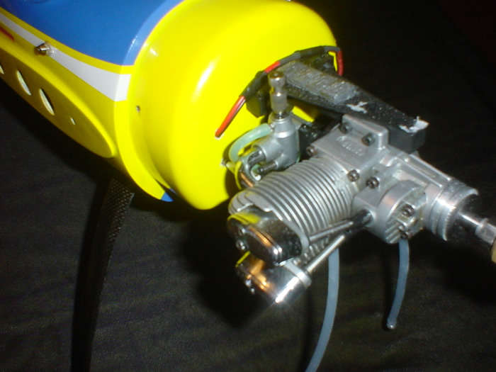

Saito .72
I put on a thunder tiger .61 pro and that helped with the balance issue. Also, did you set the wings incidence with a meter, or did you just predrill the dimples on the fuselage side and go with that?

What do you mean by be careful with the 5645's? too much servo shouldn't hurt anything as long as there isn't any binding right?
Right, high torque/hi speed servos are fine, just be careful how you use them. I hope your using a good digital radio. When it's all ready to go we'll go over the numbers and if you do just what my settings are ... you'll be peachy keen.
