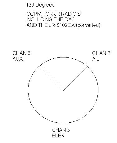

Hello all,
Hope you are doing good today. As you can see from my subject line, I am having problems programming my Spektrum DX6 for my 450XL CDE. I found a website that shows you how to program the TX for a 450 SE. However, due to the placement of the servos and stuff, I don't think that will help me at all. Is there anyone out there that is using the DX6 with a 450 CDE? If so, I can sure use some help.

actually the setup is nearly the same for the CDE and the SE. The 120 degree swash is the same and so is the mixing. The CDE just uses links and arms to get to the servos that are mounted on the forward servo tray. You have to determine which servos are AIL, ELE and AUX(pitch) refer to the picture below to see which plugs in where on your receiver. Keep in mind that the first plug on the dx6 is for a battery and or binding and as such it is not number 1. I like to think of it as number 0. AIL is number 2, ELE is number 3 and AUX is number 6.

I will look at the numbers for the SE and see how they work for me. I appreciate the rather quick reply. I am hoping to get the thing airborne soon. I will let you know how things turn out.
