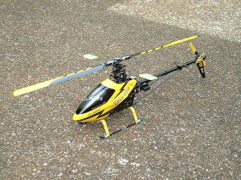

During my first hover with my TREX 500, I noticed a slight tail wag while hovering. Throttle curve is 0, 55, 85, 95, 100. 13Tpinion, 401 gyro with 9254 tail servo. I have a DX6i tx and AR6200 rx. Gyro rate set at 70 on the tx. Any advice?? Thanks!

What menu are you using for your gyro gain? (GYRO SENSE or GEAR ENDPOINTS)
A common cause of tail wag is too high of a gain....you can try to back it down some and see if that helps.

Like Skarn said,
gain probably too high. Go into gyro menu & lower gain until tail wags stops, raise it one click if it wags back it off one & that should be fine. I have a GT500 on mine with the Align DS520 works great !

If that doesn't do it, check the belt tension.

Also check the slop in your tail grips. You might need to do some tweaking on them if there is a large amount of slop back there..
Make sure you are not running in subtrim in your rudder. I have heard that this can cause some issues as well. Also make sure that you are using the gyro tape that came with it, or get some for your 401. I tried double sided tape and it was a nightmare.

There is nothing wrong with using subtrim on rudder to get the servo arm at 90.
You should not use any trim, regular or subtrim to counter drifting however with a 401.

I have exactly the same setup and have the gyro settings of 63.5 and it is PURRRRRFECT.
