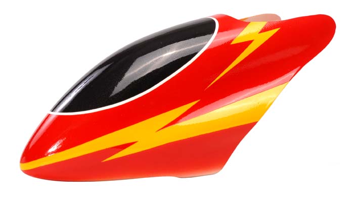

I also have the EXI 450, and just so happened to order another one on Saturday. You're going to be pleasantly surprise. It flys just as good as my trex 450 sa. the tail is weak the spot. and the horizontal and vertical fins really suck. but other than that its an awesome 450 for the money.
i also got the red lightning canopy to match with my trex500.
