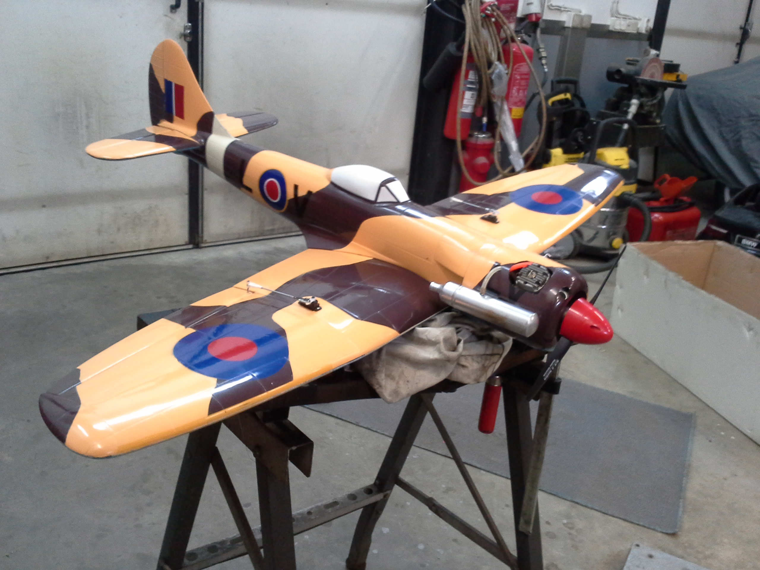

I use my aircombat planes os fx .25 engines and my best little bit tuned runs apc 9x5 15%nitro 18%oil synt/castor 16000rpm.
