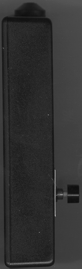

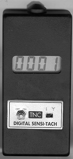

Now here are the things that I do not like about the TNC Tachometer. As you read these please remember these are my personal preference.
1. There is a small button on the right side of the tach to switch to the High resolution (10 rpm resloution mode).
The button on mine had to be depressed more than one time most of the time. The button is small and was uncomfortable on my finger to depress it. The button was also crooked. see photo. I was curious as to why it was crooked so I removed it and you can see why in one of the photos.
My second dislike of the TNC Tachometer.
2. The off/on switch is a slide switch. If a person forgets to turn the switch off it will eventually run the battery down.
Note: The battery is not an alkiline. I upgraded the battery while I had the unit apart.
I replaced the slide switch with a push button switch. Now all I must do is make sure that I do not stack something on top of the tach and turn the switch on and run the battery down.
Many of you will say that I have voided the warranty by making these changes. And yes I am aware of that however why should I use a device that does not fit my needs. Besides I am an Electronic Technician and can make these changes without fear of damaging the Tach. The switch on the left is the off/on switch.
I will post some photos of the tach with the push button switch tomorrow.
Here are the photos with the push button added. Plus a side view.
Go flying and have a good time.
Lee

Lee, will of course, answer for himself ---- however, if you zoom in on the picture of the case (backside) you can read SKYBORN ---- so it is one of the new ones, not made personally by Tony.
I too have one, without the button problem so my guess is that it was a problem in assembly not of design. As for the on off switch, I happen to like the slide type switch as you do not have to "hang on" to anything but the tach while taking a reading. I would class this as "personal preference" ------in my case, I used the original Heath Kit Thumb Tach (same on/off set up) for years so I am used to the requirement of switching off.
Lee, many thanks for the "review" and pictures, saves me from disassembling mine.

I have included a photo of the tach from the side showing the push button from from the side.
Lee
