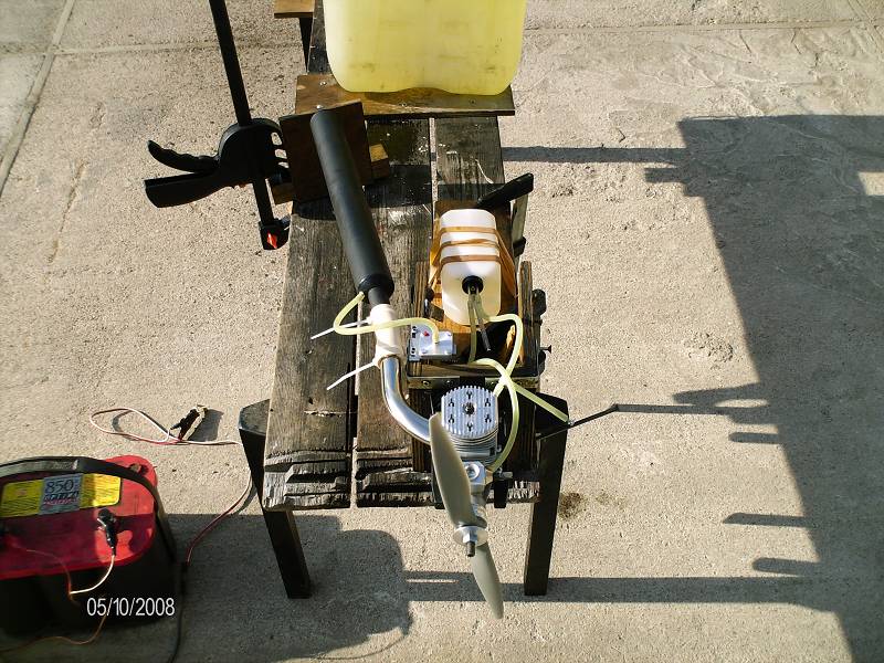

NIK Your assuming that the computer prop calculator is 100% accurate- which it is not, and no engine manufacturer max RPM was ever hit by the recommended prop. In case you were to put a very light load or overly small prop on that engine it is warning you to limit RPM to 16,000 so it won't break a con rod or loose a bearing. More and more prop recommendations are done for noise levels and not the most power or speed.
pipe lenght from exhaust flange to reflector plate 450mm
fuel 15% mobil glycoule30 3% castor and NO nitro
apc 13x6 13600
apc 13x8 12300
apc 12x10 11600
apc 13.5x12.5 9600
apc 13.5x13.3 9400
