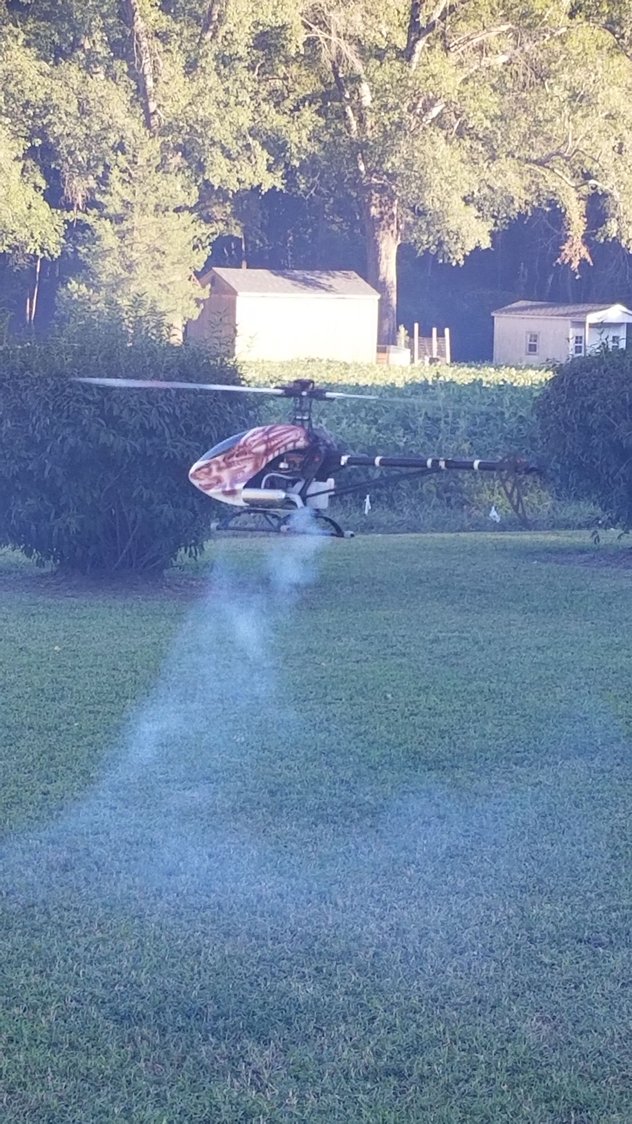

no clue, I'd fly that 50 as is after I got my bearings right. seriously. I know u want everything perfect, I can tell by the picture how serious you are.. but, BRO. . . I'd have it in the air and go from there

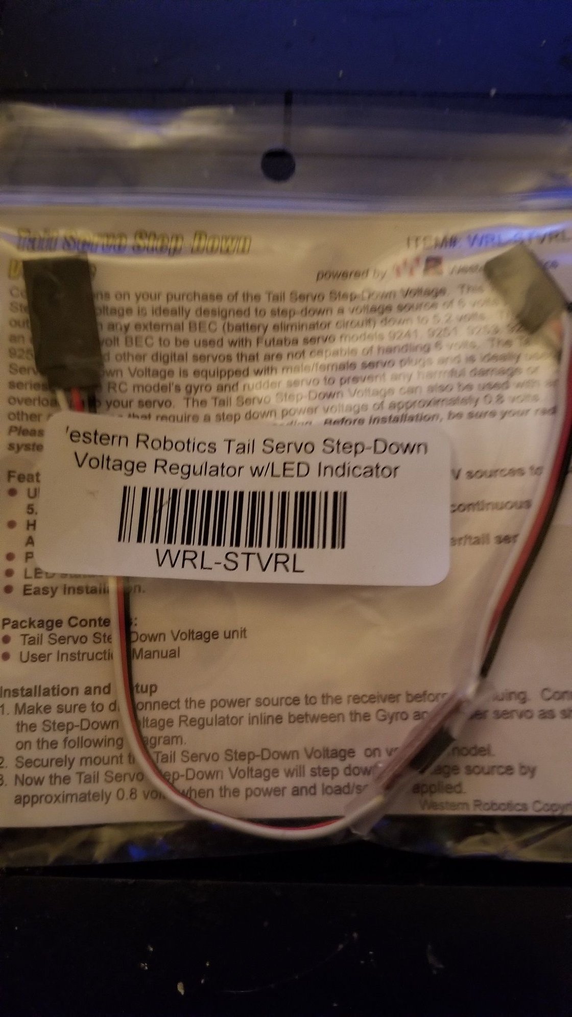

You're correct for the battery that come with the BSR. The battery that your align voltage regulator requires is a Lipo. 7.4V 2 Cell battery. I don't think 11.1 volts would be good for either the voltage regulator or your servos and am positive it will burn them up.(at least, positive I wouldn't try it). Also, check the 401 gyro. I'm pretty sure it requires 4.8 volts not 6V now that I'm thinking about it.
So the deal here is the Align voltage regulator with your bird enables to use a 7.4V lipo and regulates the voltage to 6 volts. Which is good for all of your servos including your specific rudder servo. in my applications that I use the align regulator I use even another regulator that regulates 6 volt to 4.8 volt that powers my gyro and rudder servo as my rudder servo is a futaba s9254 and requires 4.8 volts. Certainly time to use the brakes here and figure this piece out.
When I looked up the stats. on your rudder servo, it works on 4.8 volts as well as 6v.. I've studied your picture and cant tell if you've got another regulator in line to your gyro/rudder servo?
all of this has really got me wondering why someone would use a rudder servo that is designed to work on 6v for maximum performance and a gyro that requires 4.8v?
6v-4.8v step down

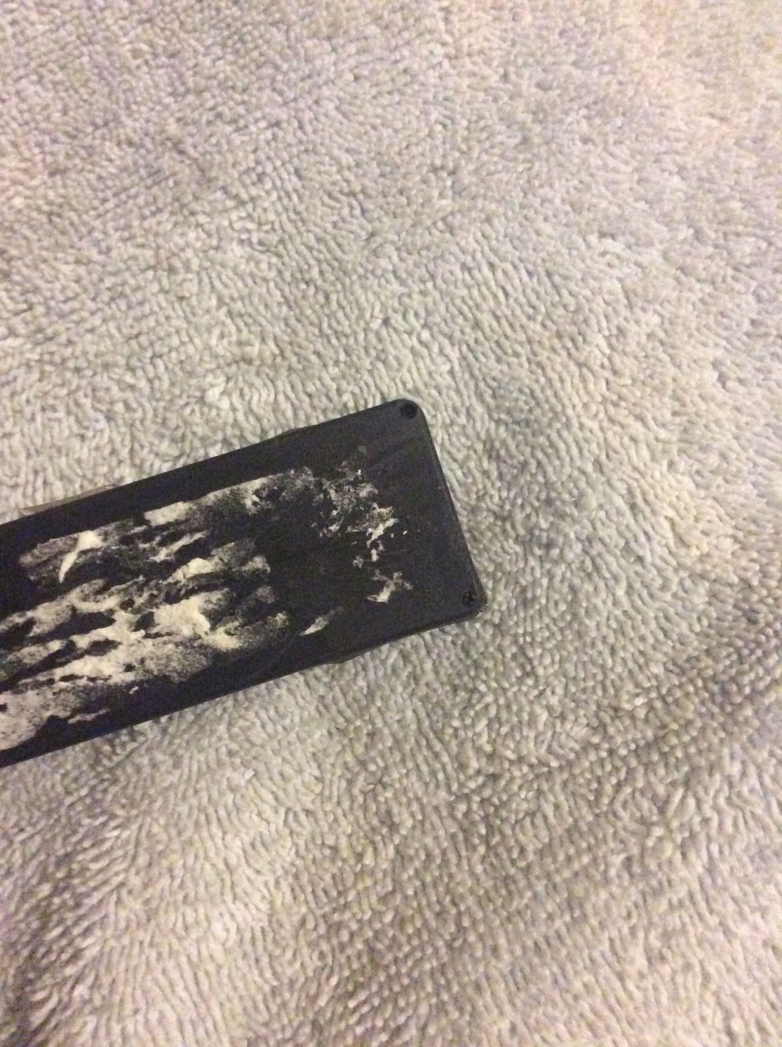

What is this?
Old 10-31-2021 | 08:28 AM
  #46
Thunder man's Avatar
Joined: Sep 2021
Posts: 121
Received 16 Likes on 16 Posts
From: Canada, Ontario
That part is just a connector for the servo to the gyro if I'm not mistaking

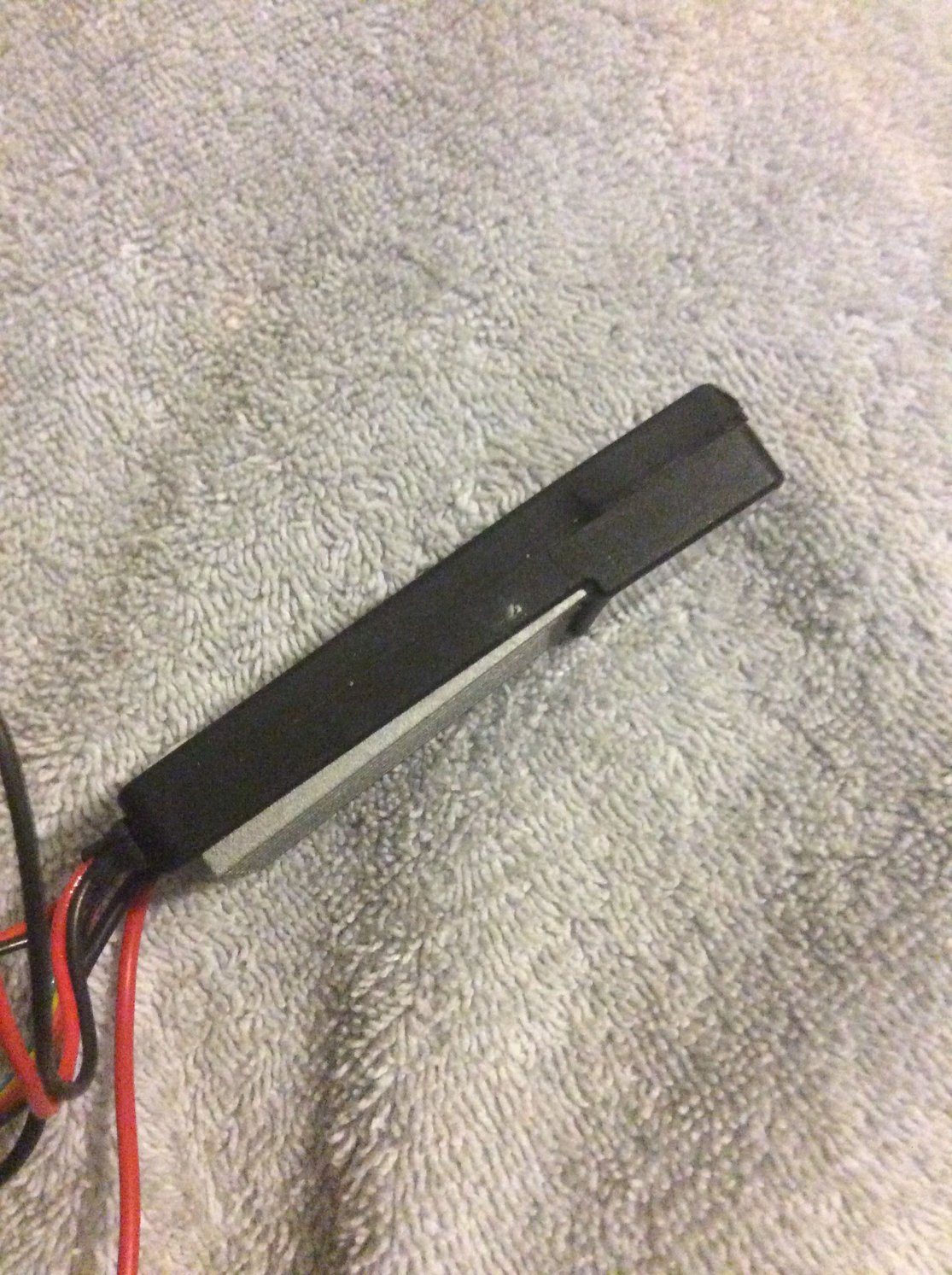

What would be a good battery and regulator?
Also, should I be concerned since my voltage regulator is bent forward, it was like this when I got the heli
sorry to say at this point but think we or you need to search the 401 gyro with the align regulator. I'm thinking and have looked, I plug my gyro up to the rx and don't need the regulator until I get to my servo. Your servo however is good for 6v .. So if it were me I'd keep that setup. HOWEVER PLEASE use a 7.4v 2s LiPo for your Align regulator like the one I posted earlier in the thread. I posted it b/c it was one that had the right connector for the Align VR. and I'm using it no problem. However the original battery had way more juice but still 7.4 volts. Feel free to find a better battery but for God's sake use a 7.4v

Default Back in Business
I hope you don't need new
Okay I checked my wiring. I've my 401 gyro plugged into the receiver. apparently no extra step down is needed from there. the only additional step down is running to my rudder servo. Your servo does NOT need this. just make sure you use the 7.4 2s battery to your Align. Sorry for freaking out. Just don't want you to burn any of your electronics..
