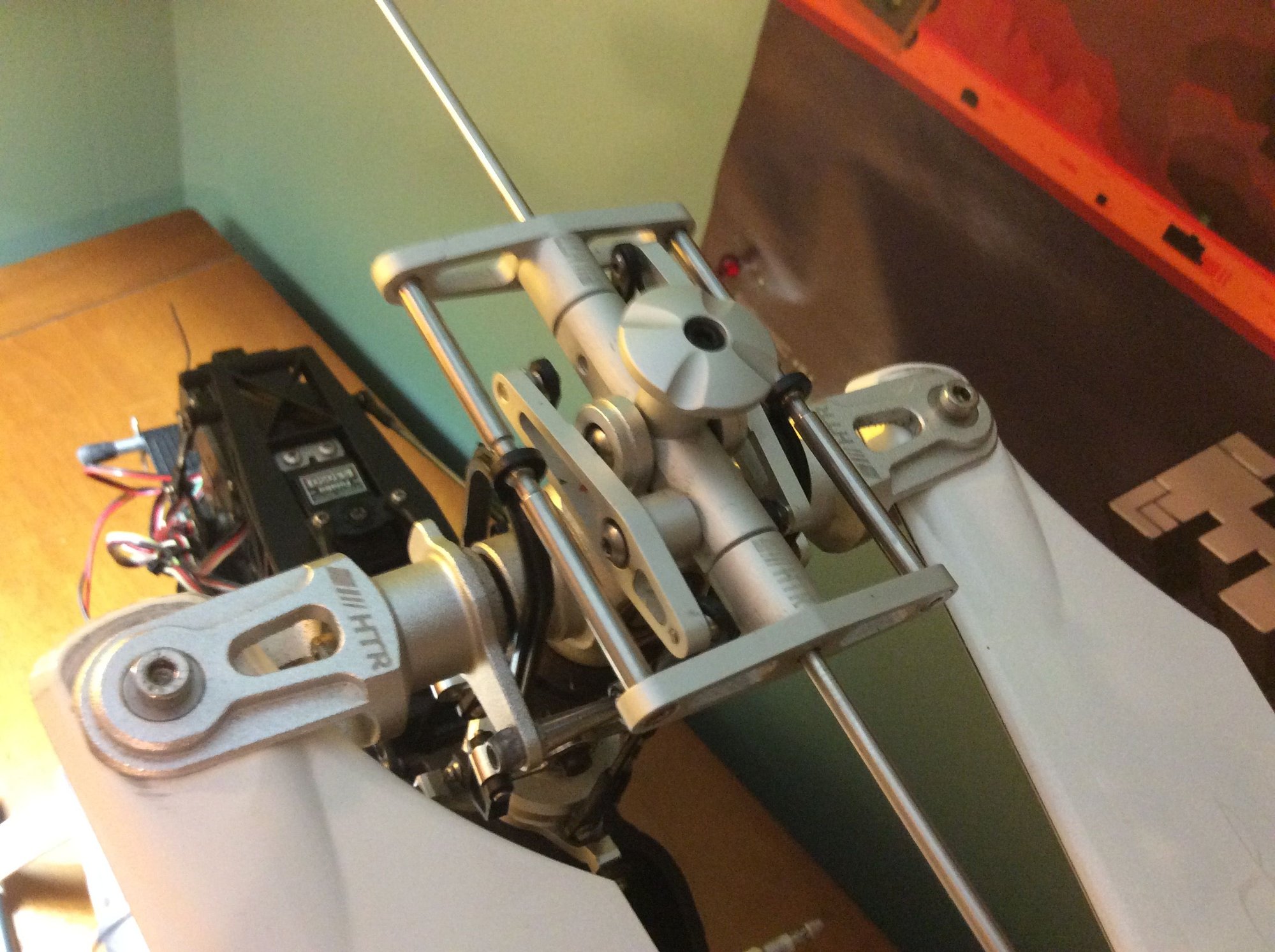

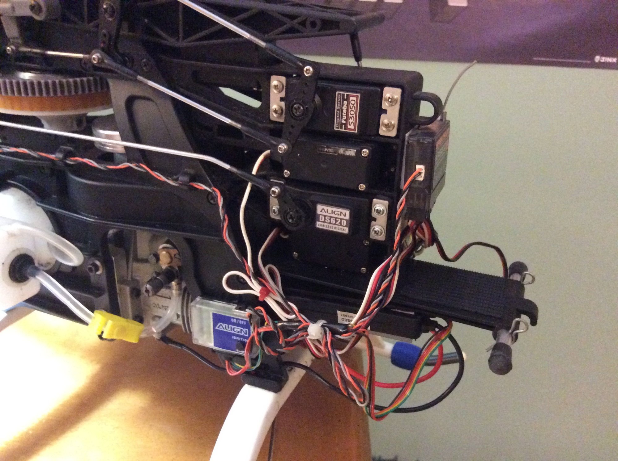

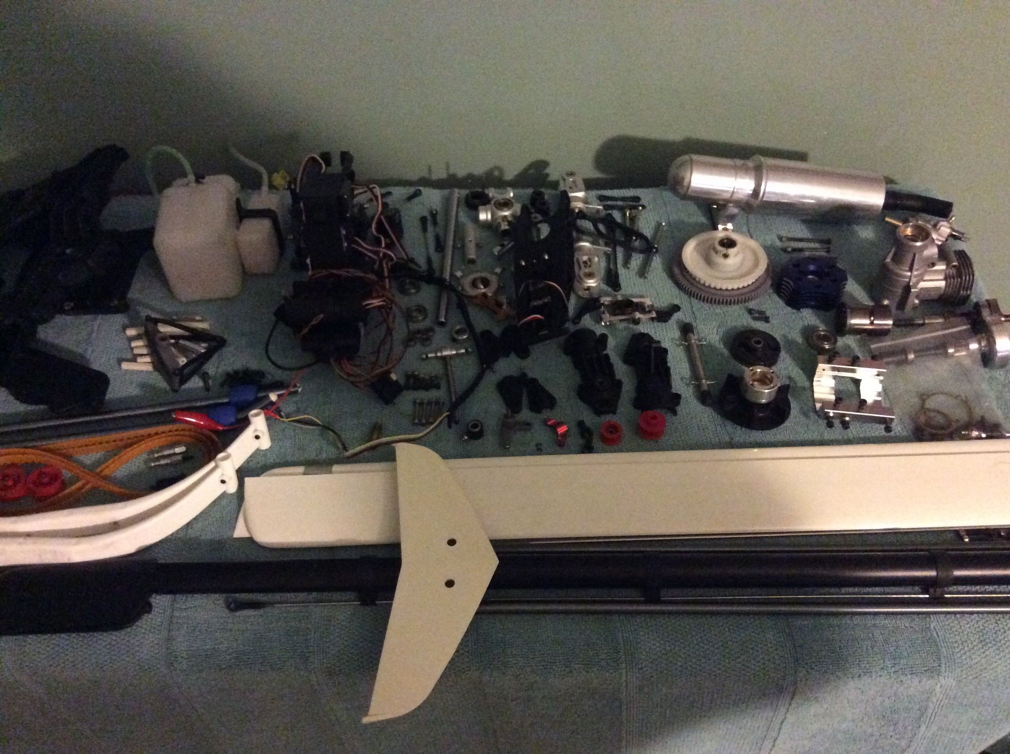

I got a raptor 50 not too long ago, and I'm in the prosses of rebuilding it, I'm new to large scale helis and nitro as well.
If anybody can give me a few tips, and things to be concerned about, I would appreciate it.
Here are photos of the raptor 50 before I dissembled it.
One more thing, how can I know if I have a titan, my blades measured 640mm, but I don't know if the tail boom is a titan model.

From: henderson, NC
my guess it's a raptor 50. the titan had an aluminum head with SE on it. there would have been no need in the owner to change the head to the one on it currently. Even if it's the titan boom, that wouldn't mean it was a titan. Honestly when my titans crash I'm going to change them over to a 50 size boom b/c parts are easier to find IE belt.
One more thing a titan boom is what they call titanium in color. Also the canopy stand offs for a titan are both screwed in top and bottom. unless it was changed, the top canopy pictured has push on stand offs and the bottom is clipped on in the center. typical of a raptor 30/50. Also a titan kit, the rudder servo is moved to the back of the frame, front part of the boom not in the front servo tray.
Good luck with it! welcome to the party!!

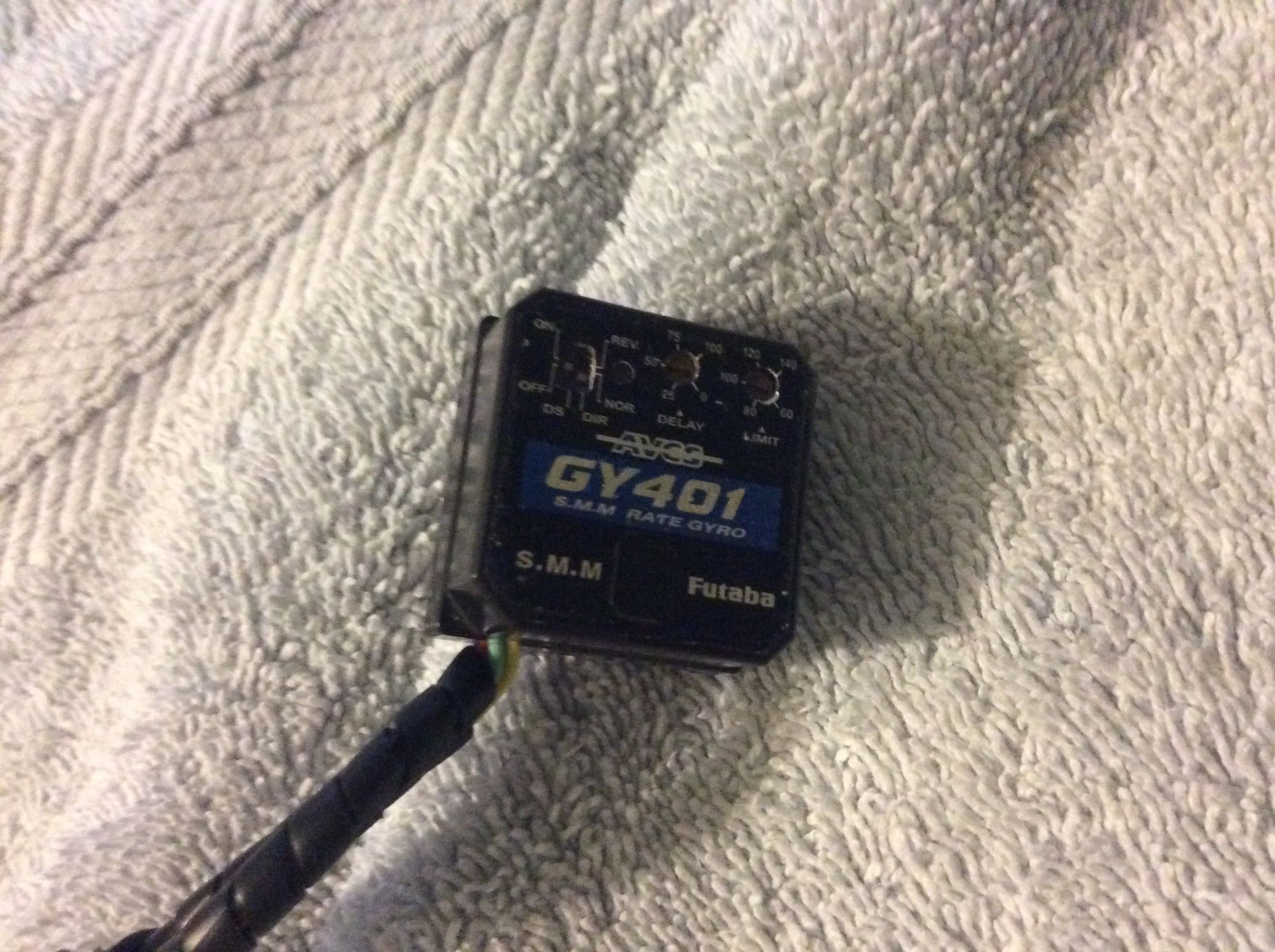

you're very welcome. I'm most interested in the gyro. I can't see it pictured.

I can send a photo of the gyro later in the day.

Since I'm new to this scale, what do you think of the servos? are they good models?

no way taking too much time. I'm so happy to see you getting a raptor back flying! I'm sure the servos will be just fine. I've no experience with the DS620 but did look it up. the speed should do just fine as long as you have it hooked to 6 volts. (Most futaba rudder servos require 4.8 volts and would need a voltage regulator on top of the align regulator. I'm telling you that incase you change the rudder servo to be aware of the volts required). your futaba s3050 are okay at 6 volts. and are great digital servos. The throttle servo doesn't need to be special and will 100% do the trick! Long story short, I think your servo set-up is good.

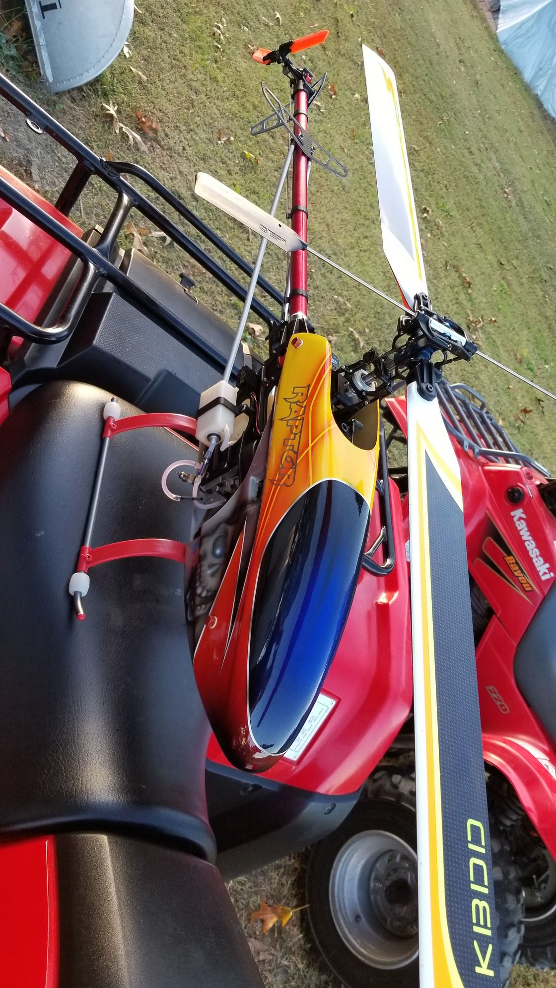

damn thing wont let me upload a picture I just run 2 tanks from my raptor 50 and wanted to show ya.

my 50

omg, thank you so much. glad to have found ya. that's your exact helicopter except you've better servos for they cyclic. I'd love to help ya' rebuild yours to your specs. AND OMG Bru. if you could hover a blade SR, you can master fly your raptor. I started the same way 10 years ago, trashed the SR several times.

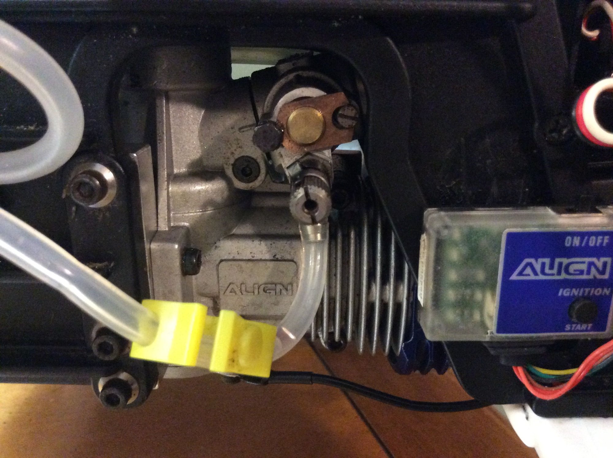

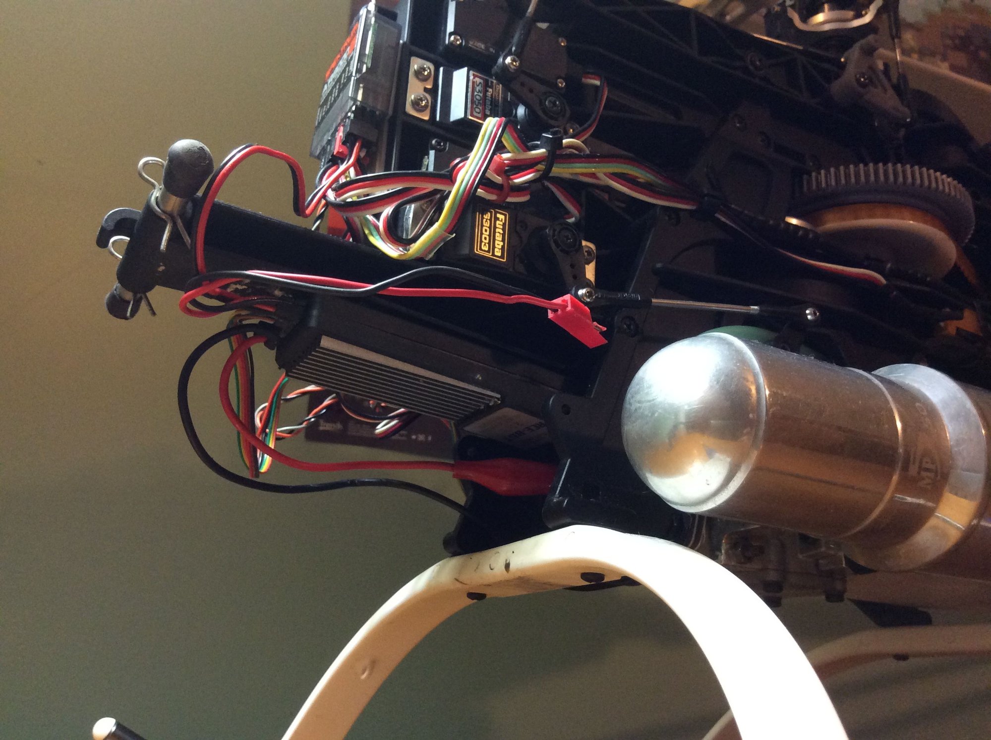

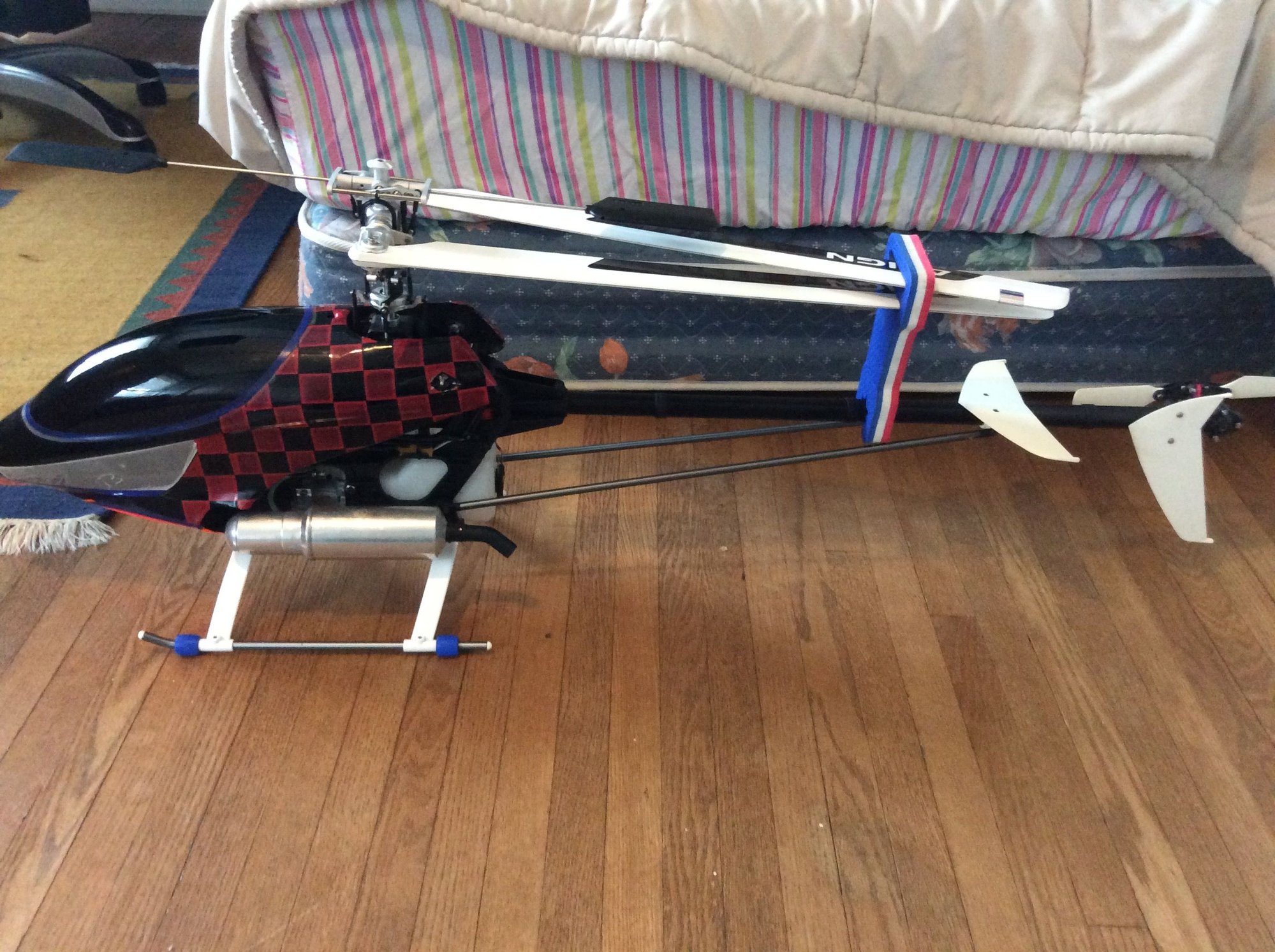

Here is the photos of my heli now.
flydawg (10-24-2021)
Old 10-24-2021 | 02:32 PM
flydawg's Avatar
Joined: Dec 2011
Posts: 64
Received 12 Likes on 12 Posts
From: henderson, NC
OMG, I love it! you've even took your engine apart! you've definitely got a 50 frame. I was hoping you had a 401 gyro. state of the art for that year helicopter. You're in great shape
I run all my helicopters with a futuba TX/RX airplanes I do spektrum. I don't know what TX you'll be using but assume that you've got a spektrum RX be using a dx for your TX . the Programming is going to be critical for a good flying helicopter. as far as blade pitch curve and throttle pitch curve. Also the gyro will be programmed in the TX. I've never used a pitch gage, just calipers. well built machines for sure. Mechanically you're sound. the link rods to the blades I measure and get identical with in .001 in my opinion better than pitch gage.
If you need any parts that you can't find, let me know. I've 2 SE titans, a r 50 and 3 r 30's. plenty of parts but also have a good feeler out for where you can buy parts. Feeling blessed to be able to be a part of your reconstruction.

I want my heli to fly like new and look new. I'm taking everything slowly, and working on one thing at a time, this project may last a few months.
I'm new to things like thread locker and other equipment, soon I'll build up my tools over time.
I had to put the engine in the oven to get the shaft out, and used a plastic peace to get the sleeve out.
