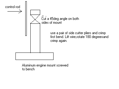

Default z-bend jig
Here's what I came up with dealing with z-bends. Takes a couple of tries to get used to it but it works
