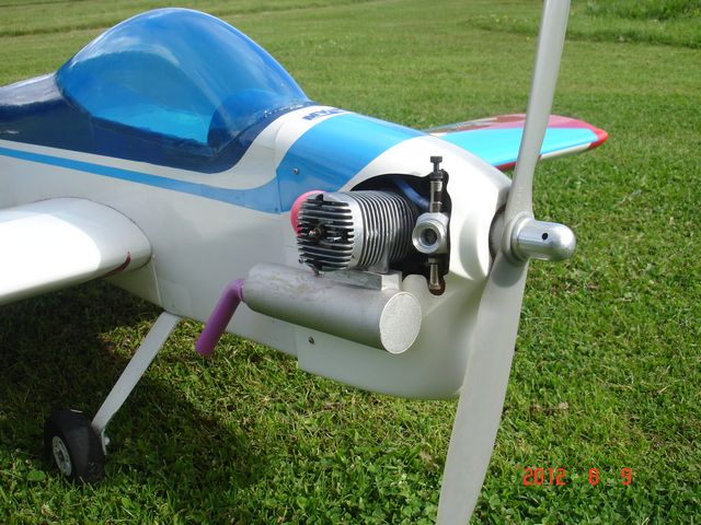

Default RE: Canopy tinting question
Hi!
I have used Tamiya colours for decades. There are many colours to choose from. smoke ,blue ,red and orange, sprayed on the inside of canopies.
Workes great.
