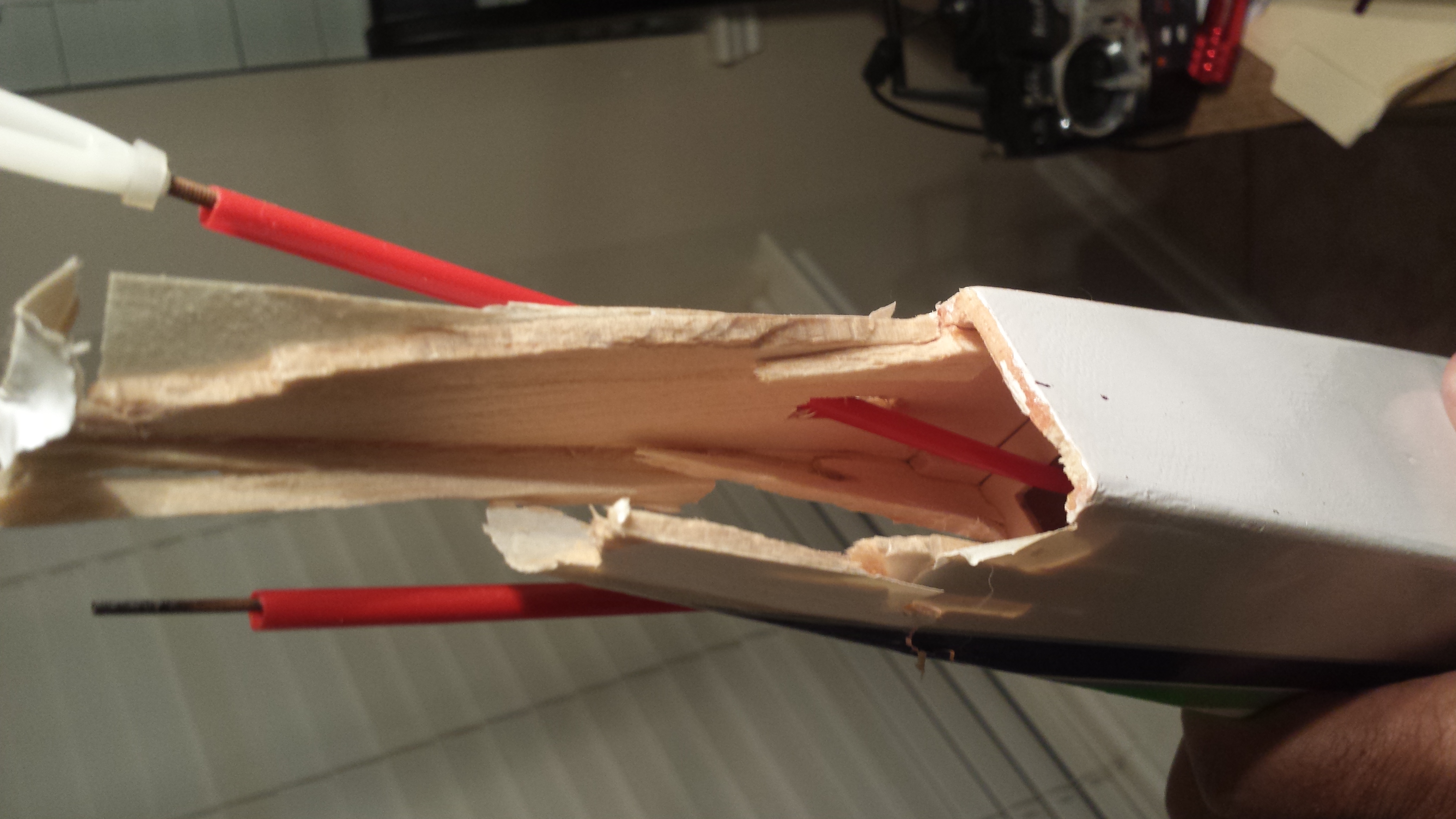

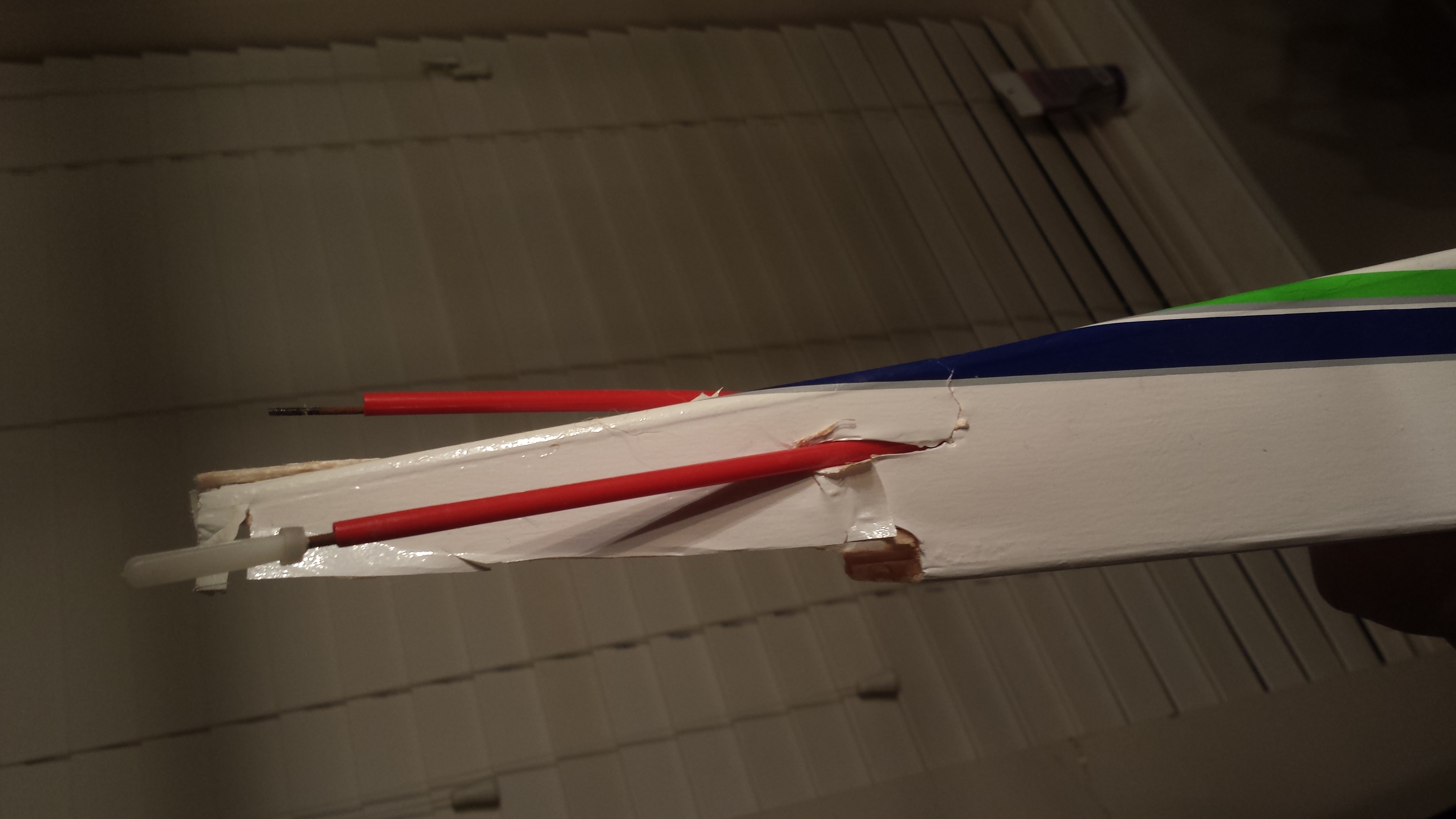

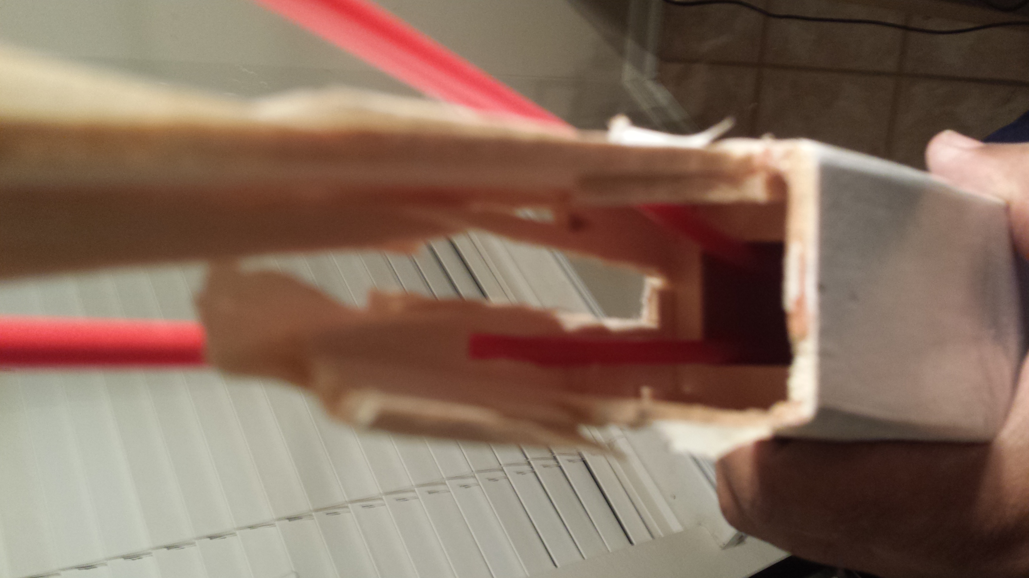

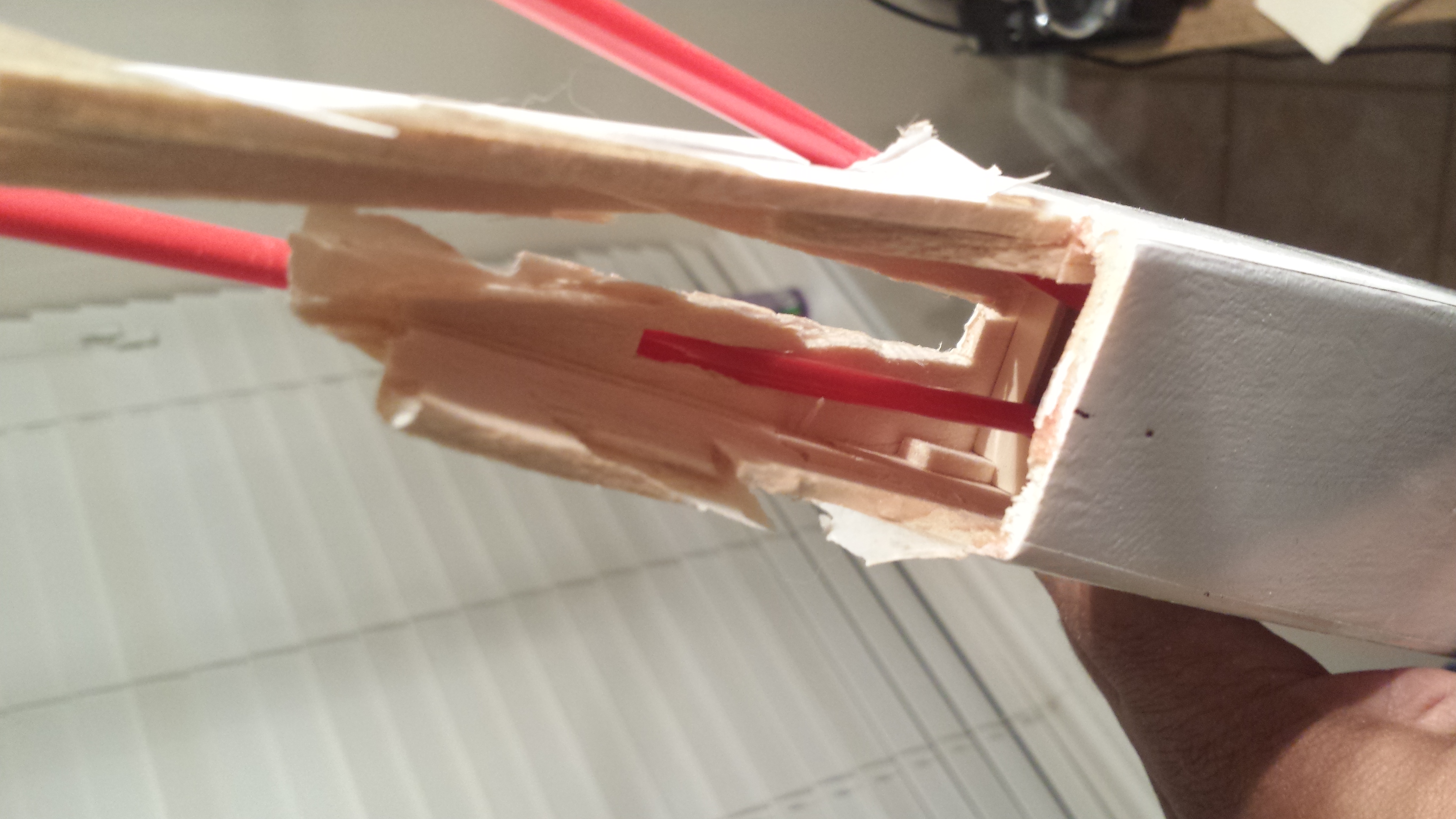

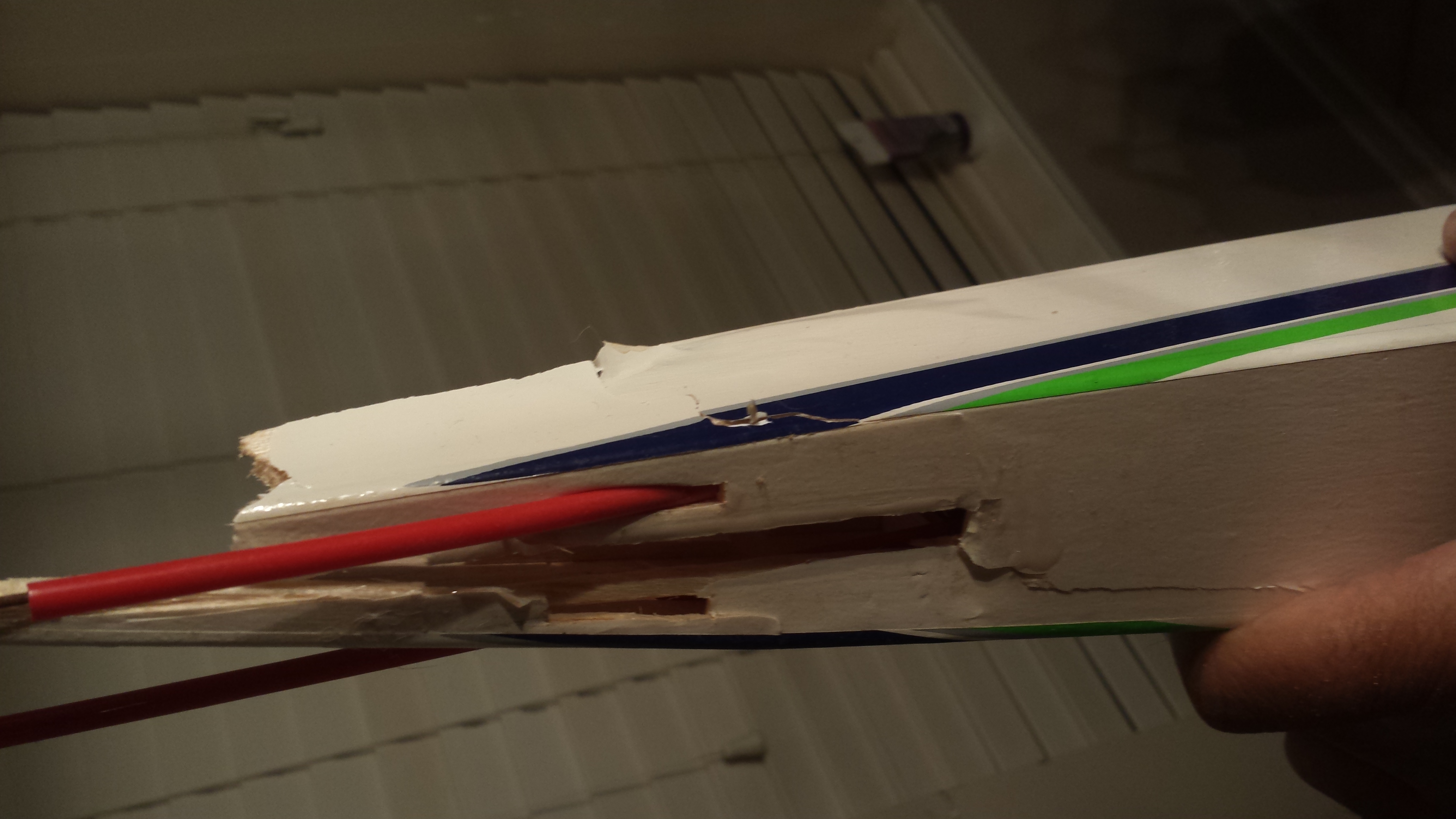

More in-depth pics of the damage. I just have to get some triangle blocks (or make some) to finish working on it.

I am using tri-cycle landing gear so it is on the nose heavy side. It gave you options for a tail dragger or tri-cycle gear. I chose tri-cycle gear. (Don't remember why, probably had something to do with my trainers.)
I have some spare wood. I am going to try to make some extra pieces to use as braces.

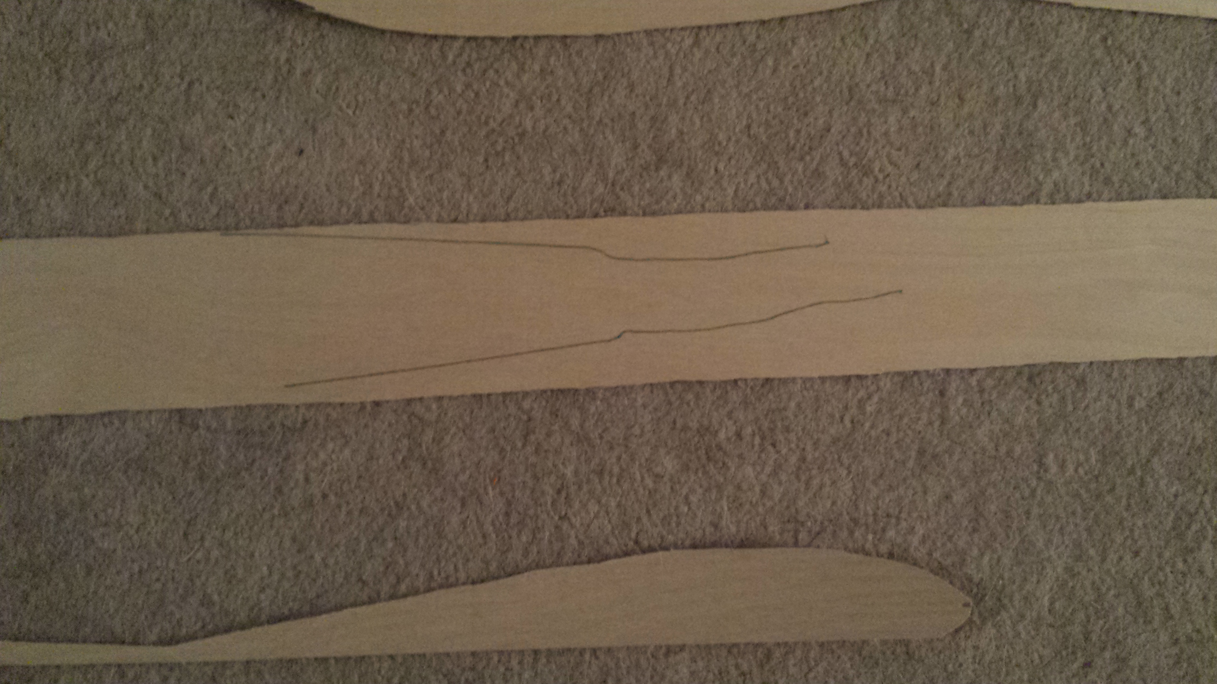

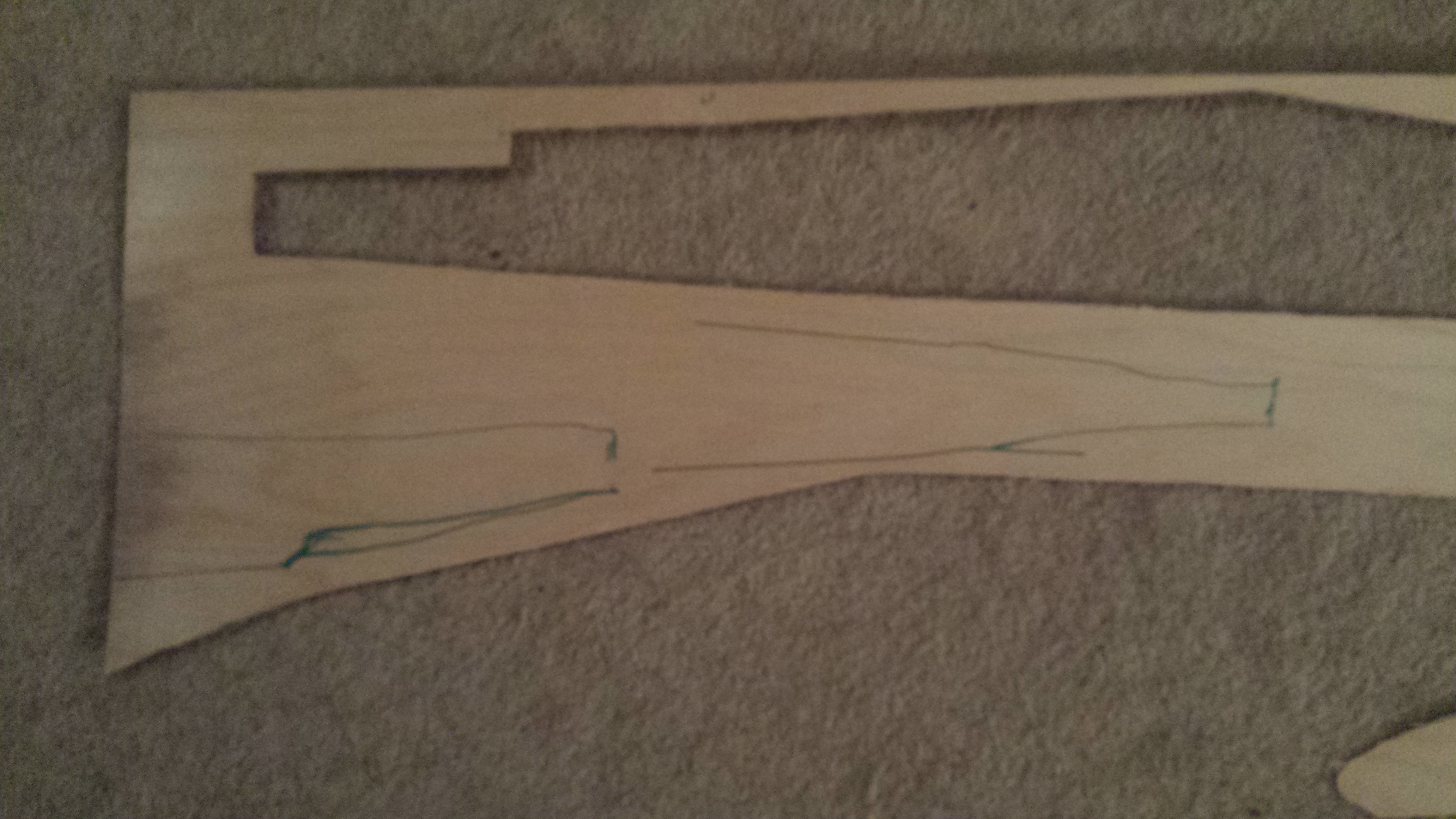

I found some extra stock I had for making fuse boxes. I made rough outlines of the areas needing to be replaced.

I had one of those H9 sticks many years ago and it virtually fell apart from the poor factory glue job. I would not rebuild what is broken because of the way it is broken. It's gonna fly bad. With the tail completely off I think your best bet is to rebuild the whole fuse using the broken parts as guides for the wing saddle and stab/tail locations. This is the simplest way to get a true and strong flying plane….plus you can jazz up the Hanger 9 color scheme.

Originally Posted by djsqueeze
flyinwalenda
On the right side with the most damage, I would cut that out back to the first former/bulkhead and replace it with a new piece of balsa. If you can;t repair the other side replace it too. Cut some plates out of light-ply if you have or use some square stock to reinforce the joints of the new pieces up against the former on the inside. You will get it . Just take your time ,think about it a few times, measure twice,cut once, etc...

flyinwalenda. I plan to cut the whole rear portion up to the bulkhead and replace it with some lite-ply. I will use square stock, same as shown in the pics, to reinforce the joints. I do plan on taking my time. This is my 1st rebuild and I want to do it right. I am in no rush. I have other planes to fly.
