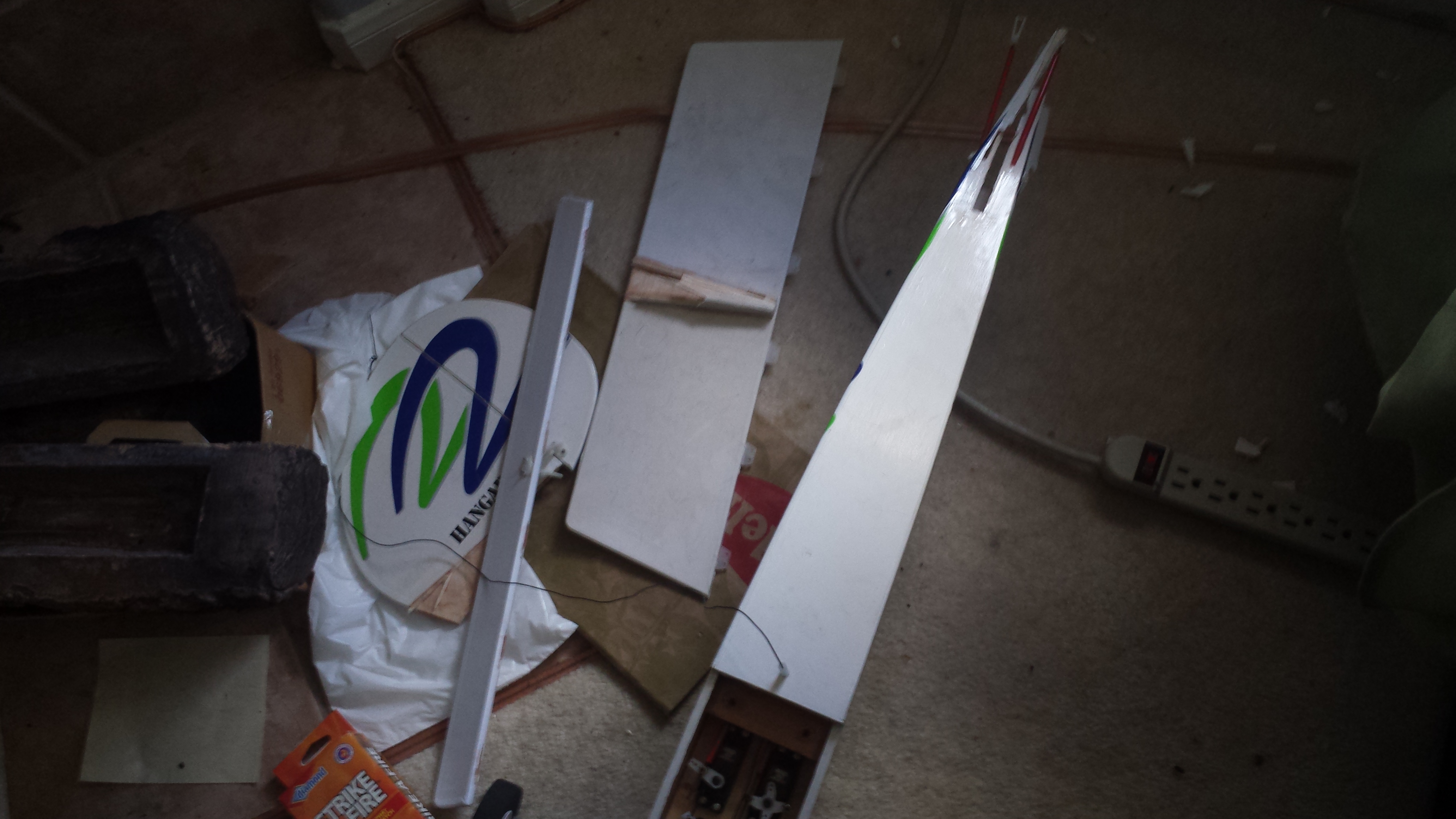

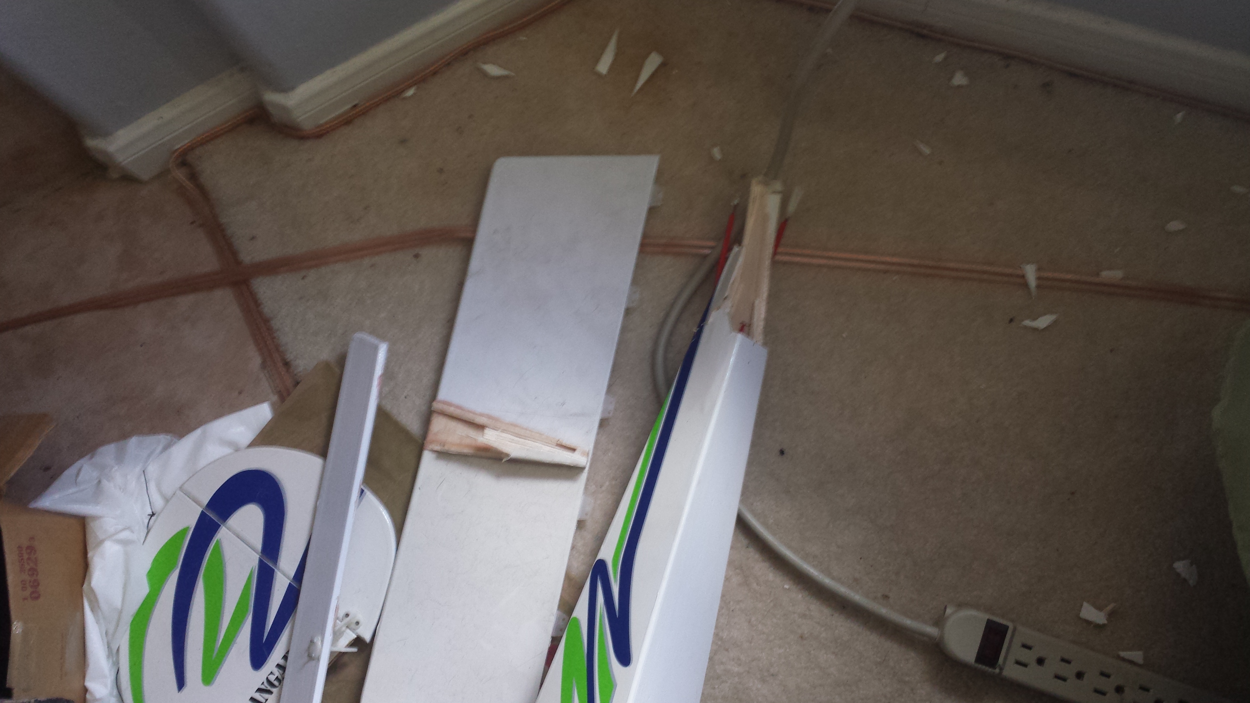

I built this .60 size Stik. I left it on the floor out of the way. On the day I came home to fly it I found it in the condition shown in the pics. My dog, I think she was trying to get at a cat thru the window (stupid as it seems), apparently jumped on it. So, I am trying to decide if I should buy a new plane or try to rebuild this one. It is really my desire to rebuild and fly this one since I never got to fly it. I know it can be rebuilt, so I am looking for guidance. Any assistance or ideas on rebuiliding given will be much appreciated.

Looking at your pictures I would say that the damage was not really all that bad. I would rebuild.

You'll get that fixed in a couple of hours.

I would rebuild it. Doesn't look like the hinges were even glued in.

Well first thing that Super Stick was discontinued two years ago and you will have a hard time finding parts for it. Shame as it was one of many great flying Stiks discontinued by Horizon.
The second thing as mentioned by the others, it's not bad. The horiz stab looks like a clean break. The vertical stab may have the lower part broken off inside the horiz stab but again that's not bad. First glue the horiz stab back in place on the fuse keeping it properly aligned and level to the fuse. Then glue the vertical stab back in place right onto the broken part in the horiz stab again keeping it plumb.
Then get some triangle stock in a width that will extend up the vertical stab past the break and across the horiz stab and cut two pieces long enough span the vert stab length . You can cover the exposed pieces in ultra/mono-coat then glue the pieces in place or just glue them in and paint them white, You can also cut two additional pieces and install them below the horiz stab to the fuse. These pieces will reinforce the stabs. Then install the elevator surface with new hinges.
Done !

No, 52larry52. I am going to take everyone's advice and rebuild. Thank you guys for the advice, esp. you, flyinwalenda
for the instructions (which is what I was also looking for). I will post more pics as I go step by step.

You need to make it strong but try not to go overboard with a lot of epoxy making it really tail heavy. Try and use CA where you can and epoxy the triangle stock on. I don't remember how these came out of the box (tail, nose heavy or neutral) but you can always move the battery forward to compensate or put on a bigger engine!
Oh and if there are rough spots, pot holes.divots, in the balsa after repair get a small container of lightweight spackling compound , fill in the dents and sand smooth . Then you can cover the sins with a piece of coating or paint it.

, I got the joke. And for all who say it is a repair vs a rebuild, you are probably correct. I am working on it now. Taking off the glue and wood on the vert. stab 1st., then I will clean up the horiz stab and put together some triangle stock in prepping to glue the horiz stab. in the morning.

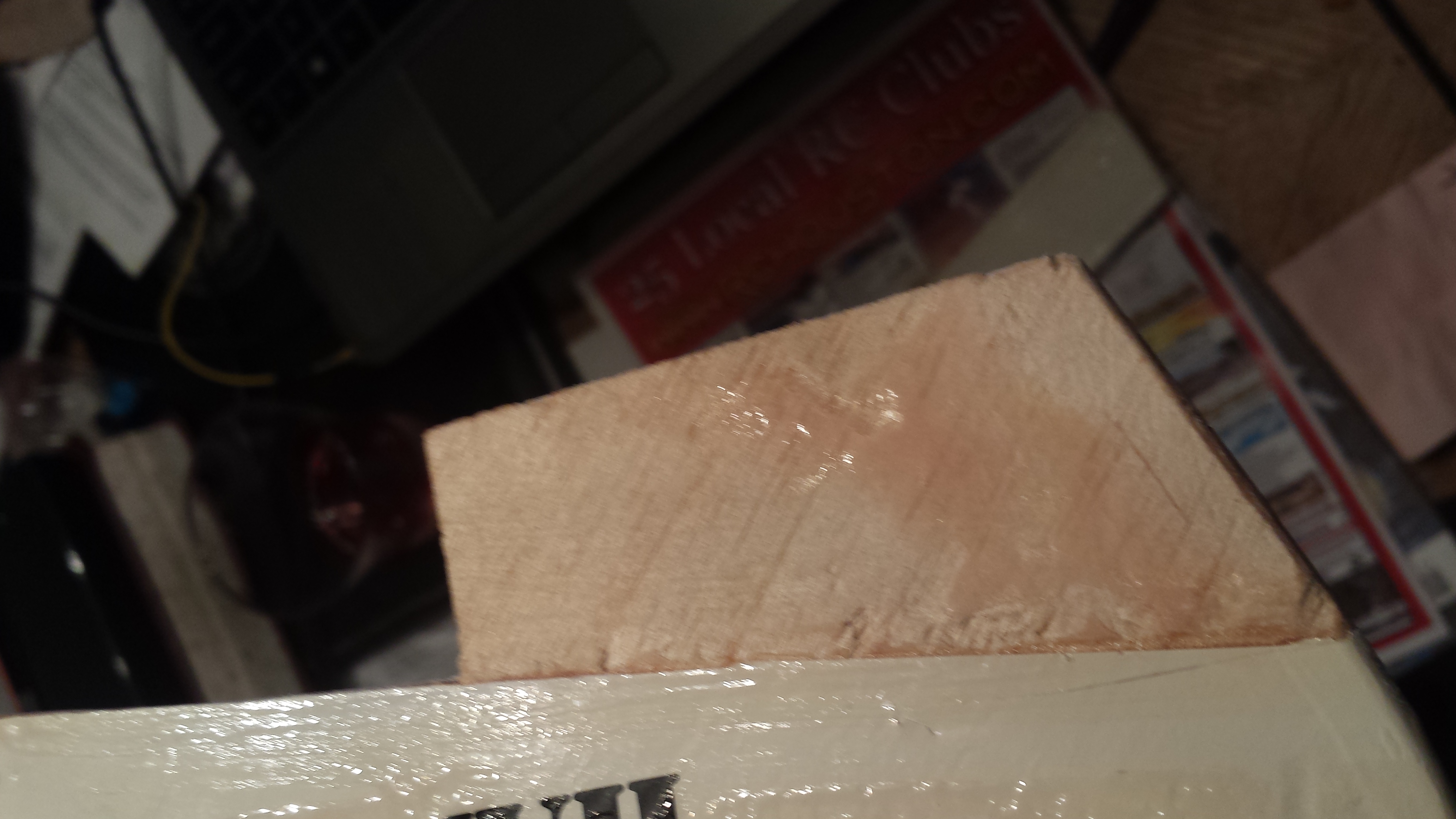

Used 60C grit to remove the excess glue from the vertical stab. Found it was a clean break on the elevator because the hinges were only glued on one side.
