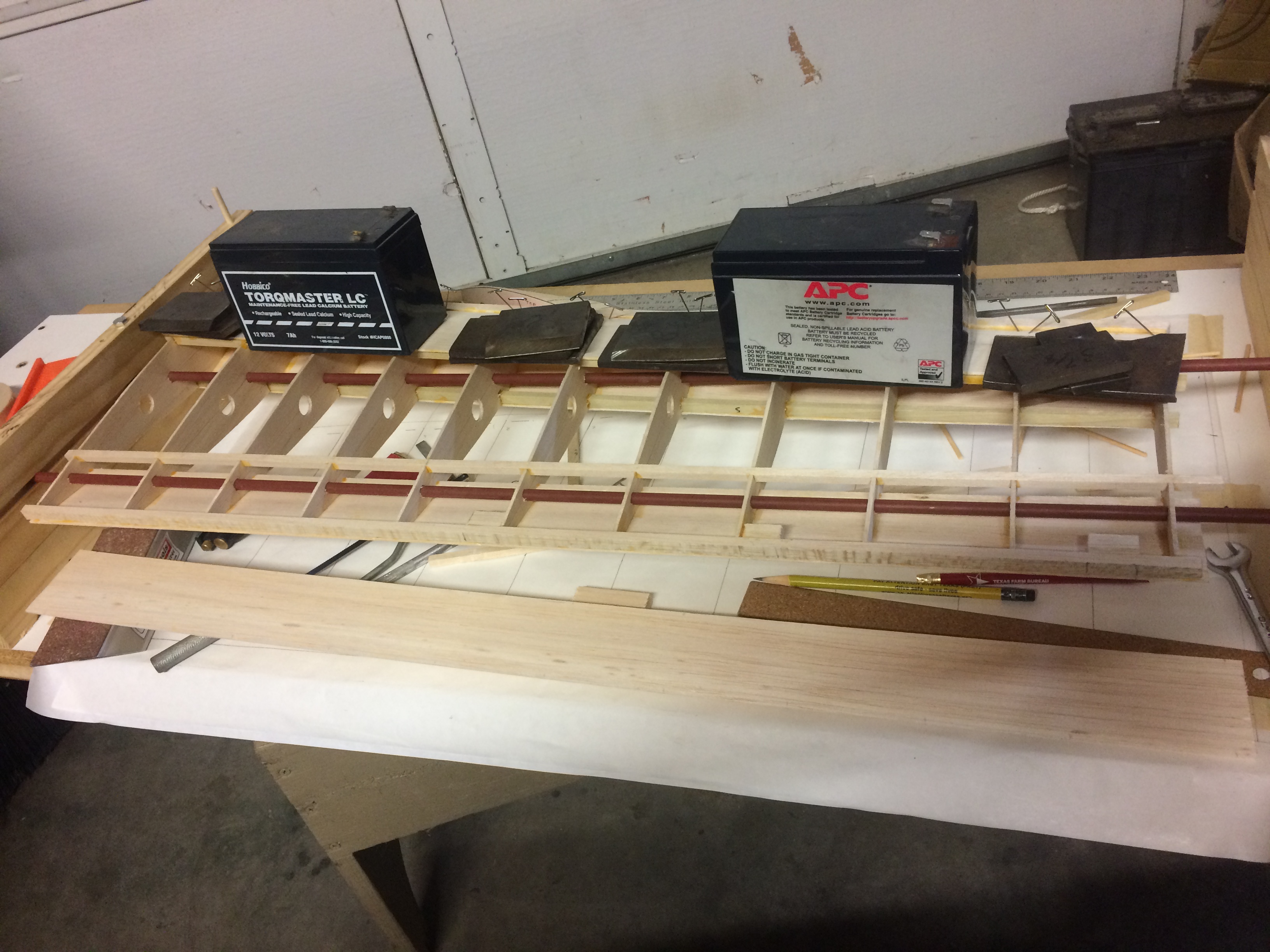

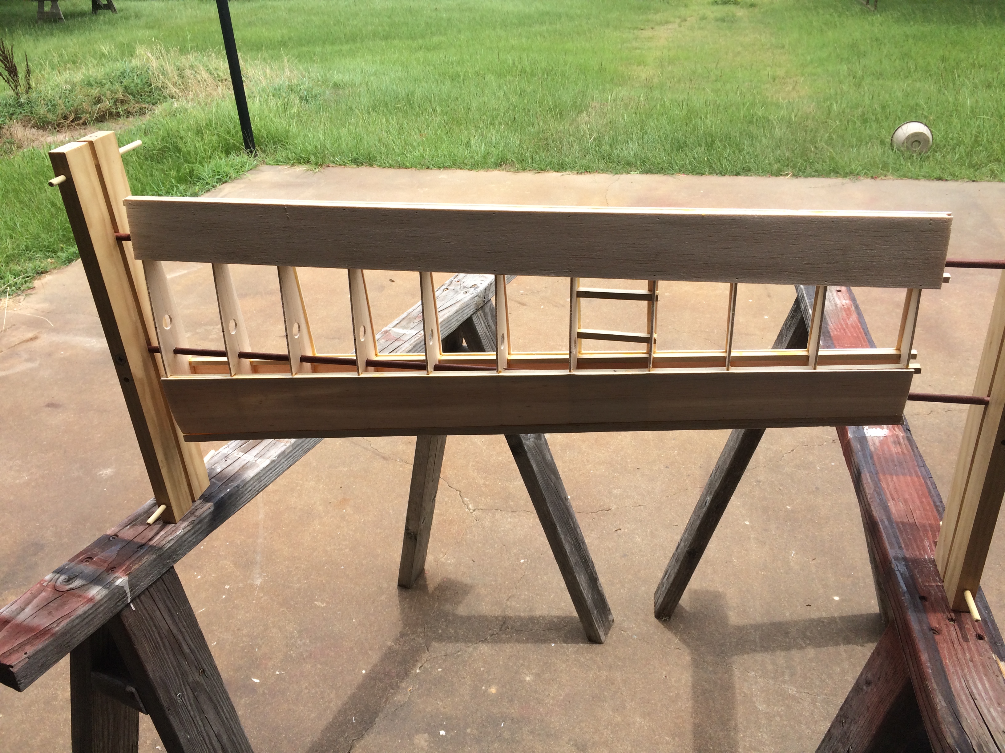

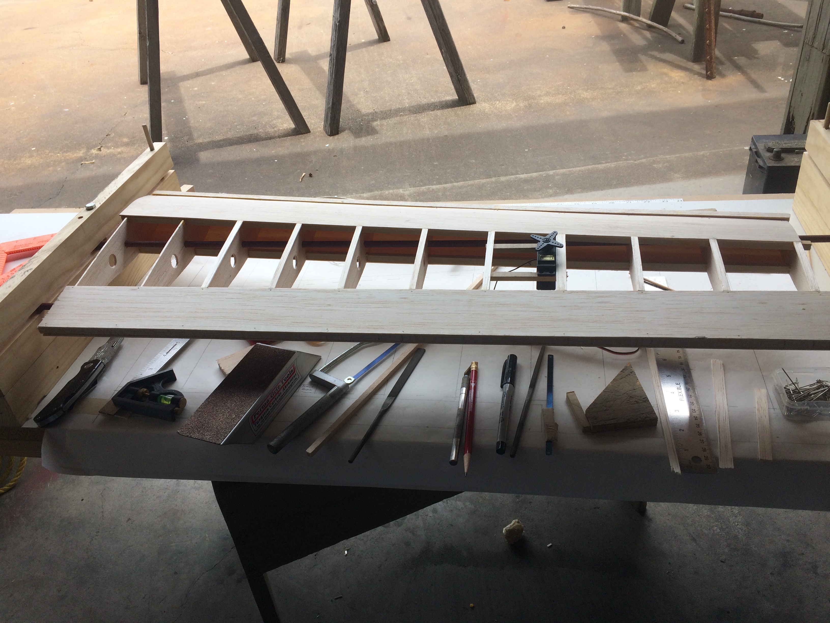

Old 07-04-2016 | 06:24 PM
ETpilot's Avatar
Joined: Jun 2014
Posts: 1,203
Received 26 Likes on 24 Posts
From: East Texas
Well my first wing panel is almost done. I'm really liking this wing jig. I like that it sits high off the plans. No wax paper needed. No glue dropped on plans. After the wing frame is assembled, I can keep tools, supplies and what not under the wing assembly. If needed, I can pick the jig table up and rest it against a wall out of the way. Easy to flip the wing over to work on the opposite side. I can even pull the jig from the table and rest it on sawhorses for additional work. I use my welding clamps so the jig does not tip over. BTW, this is a tapered wing with a LE sweep. So far it looks pretty true.
I have the the jig table resting on a small work stool. I sit on a mechanic's seat and work my way around the assembly. So overall a good decision to build this jig. I haven't found anything major that may need changing.
