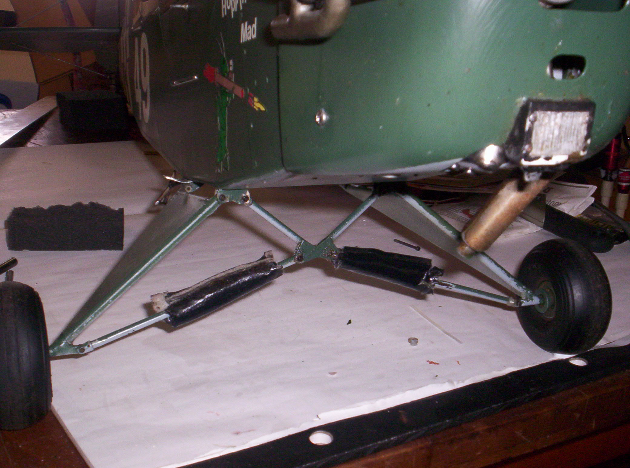

I picked up a set of these for my 1/5 Sig Cub and really have no idea what is the best way to install them.
Need some help before I make a mess of it.

Robart's site has this sketch, which may help. These are somewhat complex (at least if they're the same as the quarter-scale set).
http://cdn.shopify.com/s/files/1/033...s/689.pdf?4066
Old 02-17-2017 | 11:06 PM
Joined: Jul 2003
Posts: 5,587
Received 28 Likes on 25 Posts
From: newton, NC

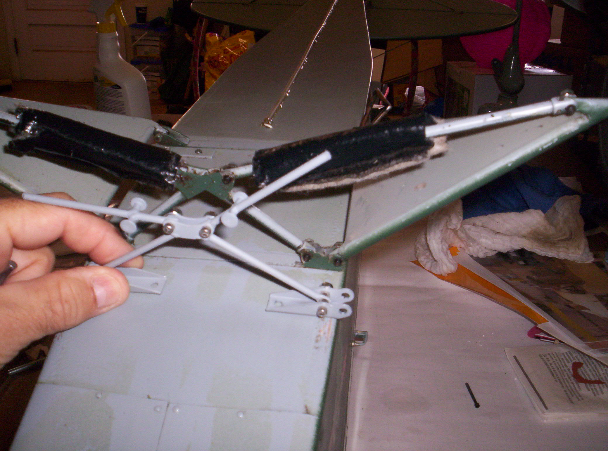

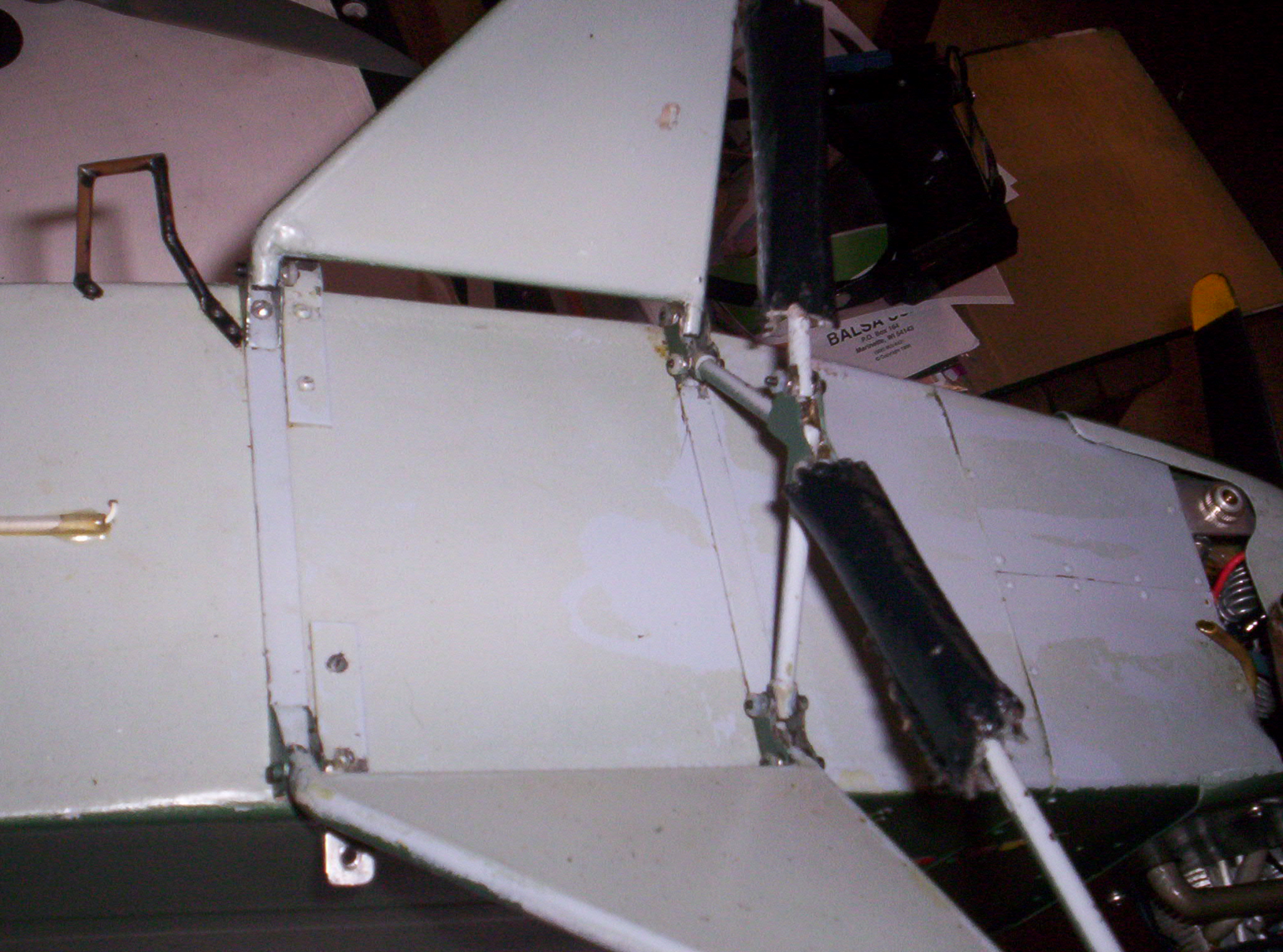

Here's a couple of pictures that may help. The mounted gear on this 1/5 scale Sig Cub is a Wallace scale gear, the Robart mounts the same way. I recommend putting a couple of basswood crossmembers inside the fuselage to screw the gear into, it will hold much better than balsa. The picture showing me holding a second set of gear struts is the Wallace gear mounted, and I am holding the Robart gear.
