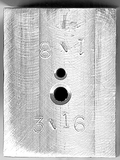

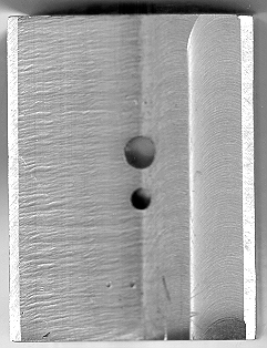

Here is what I use as a drill guide for The Robart hinge points.
I made one of these for a friend who on shi first try drilled ll hinge holes in 14 min. and they were all dead center.
I wish you the best of luck
Lee
