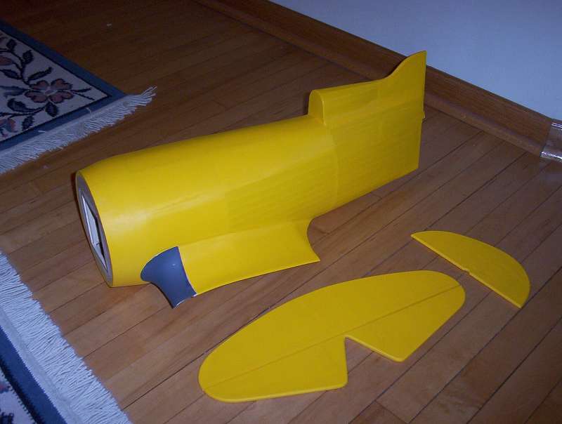

I built the fillets the same as Zpat, all out of balsa. There are two 1/32" thick ply sheet bases that get glued to the wing contour forms located inside the fuse. These extend out both sides of the fuse. There are then 3 formers that get glued to the top of the ply sheet, on each side. The location is important and is shown on the plan. The wing should be attached to the fuse with a piece of wax paper between them when making the fillets. When gluing the formers in place, make sure they cause the 1/32" ply base to conform and lay flat against the wing. The plan should also show a 1/32" ply strip that gets glued to each side of the fuse, following the tops of the formers. Starting at the front, there are 3 balsa sheets that get glued against the ply strip at the top of the fillet, follows the contour of the formers down, and then gets glued to the end of the 1/32" ply sheet base. These 3 pieces butt against each other over the center of the formers. You will have to wet the outside of the balsa sheet to keep them from cracking as they follow the contour of the formers. Take your time on this to get a good fit. Some balsa filler and sanding will complete the fillets.
I will be gluing the ABS plastic pieces about 1/4" overlap on top of the front of the fillet. The covering will then butt up against the plastic.

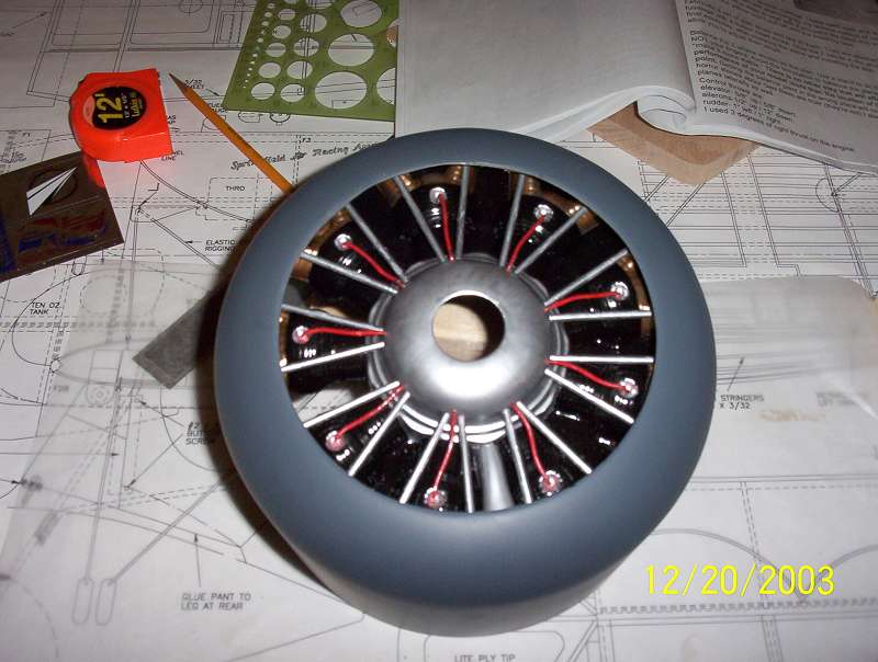

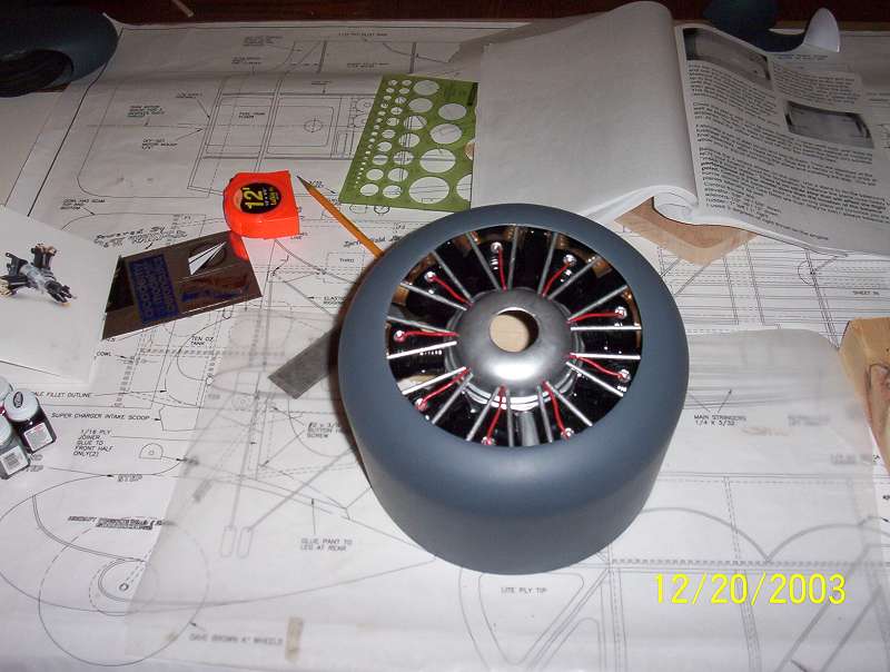

I still haven't mounted my engine under the cowl yet, but I think the muffler should fit without having to cut any relief for it. I'll let you know. Have you thought about putting a pitts muffler on your engine? That may make it fit within the cowl.

The idea is to have less area in the front opening for air going into the cowl and more area in the rear of the cowl where the air flows out. I believe the ratio is 1 to 3. This keeps the air flowing through the cowl and around the engine for cooling. I actually have 2 cutouts in the dummy radial, which will line up with the 2 heads of my 4 stroke engine.

I've started covering this week with Solartex and I love it. This is the first time I've used it and it's great. It goes around curves smooth and wrinkle free. Great Stuff! Does anyone have any advise for keeping seams glued together. Do I need to apply CA to keep them permanent? Ive used my trim iron and they appear to be well sealed. I'm just concerned about their permanence over time.

The covering has been coming along. I've been working on the tailworks and the fuse. The hardest part was covering the tops of the wing fillets. I like the Solartex alot for working around curves.
