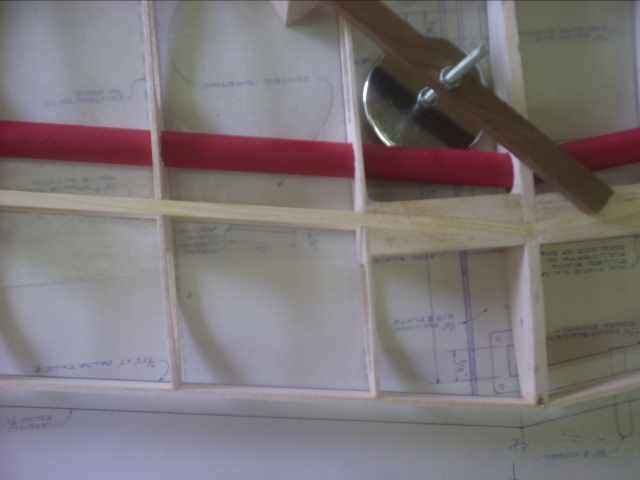

I have a couple of pictures I pulled from one of the threads here, and I thought they were yours. This shows an alternate clamping method.
Do you have any trouble with rust on your building surface?
Are you using cold rolled steel plate or galvanized?
I priced out a piece of 16 gage (aprox .062 thick) cold rolled steel plate, 3' X 5' for $37.00. This would go well on top of a piece of 1/2" plate glass that I use to build on. I planed to tack glue the steel plate using 3M77. The other side of the plate has a piece of SheetRock tack glued to it. Not much fun flipping it over.

OldRookie - No, those aren't my pics - I saw them in a thread too, but don't remember which one. The plate I'm building on now is the Great Planes board. It's galvanized steel 18" x 48". It's good up to about a .40 size plane. It doesn't rust.
My plan in the very near future is to go check out the local metals guy's shop and see what he has. He said the steel plate he has will rust. My shop is not climate controlled and I live in Florida, so that will be a problem. My scroll saw table rusts, but I keep it waxed and it's not much of a problem. I expect I can put a few good coats of car wax on a steel building board and not have rust problems there either.
I have a 1/2" glass bench top as well. I plan to get an 8' x 2' sheet of steel to build on. I'm not sure what I'll buy yet. I'll have to go see what the guy has and decide then.
The main point I was trying to make is that sheets of steel are not nearly as expensive as I expected. $37 is nothing for a decent building board.

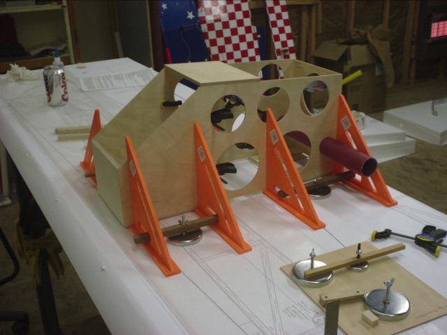

Old 02-28-2004 | 05:20 PM
My Feedback: (8)
Posts: 326
From: Winchester, VA
Default RE: Build with magnets (instead of pins)
Here's a photo of my building table. Under that piece of ply is a sheet of steel when I build with magnets. On the larger planes (1/3) I use brad nails into ply. Works better and easier than pins, it would take to many magnets to hold down these larger parts. So when Im building a big one I build on ply and for the 120/150 size and smaller I use magnets. There are a few other photos of my shop under "tips and techniques- lets see your shop" http://www.rcuniverse.com/forum/m_13...mpage_3/tm.htm
2 Piece
