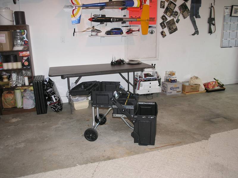

This thread seems to be a bit stagnant so i'm going to revive it !! I just purchased what I think can be the ultimate "Field Box From Hell" Picked it up at Rona for $79.00 usd. A bit expensive but in this hobby were not afraid to throw around a little cash now and again. I will be posting updates on my progress, should be complete in a few weeks. I plan on putting my fuel jugs and battery in the bottom (4 jugs fit perfectly) mounting my power panel and charging panel in the front. I also plan to make a brace for the top lid to support a flip up mounting system for fusleages when mounting wings. Here is a link to the Stanley site for more info.
http://www.stanleytools.com/default....e+Work+Station
The demonstration video shows how it works.
ID:	893863   Click image for larger version

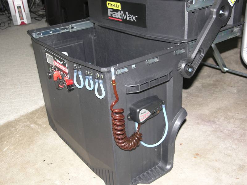

First part complete !!
here is a pic of my power panel mounted to the front

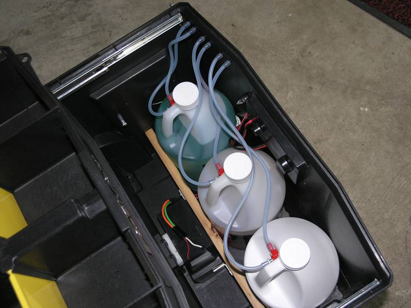

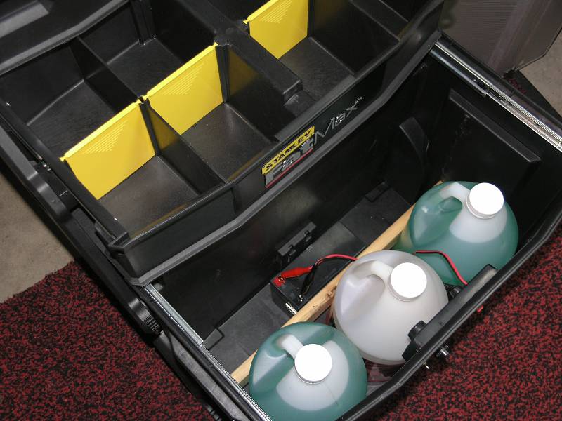

a couple pics of the fuel jugs in place and the 12 volt battery.

I may be a bit of an old poop, but I would worry about keeping a lot of fuel next to a battery. At least I would make sure the compartment is well ventilated.
Old 03-11-2008 | 10:33 PM
  #535
RC-Captain's Avatar
Posts: 2,981
From: RCHill, NJ
Default RE: THE FIELD BOX FROM HELL! aka The Ultimate Field box!
it doesn'thurt to be to careful , but I am trying to determine the difference from his battery sitting where it is sitting and the fuel tank in a gasser sitting on the CG next to the servos ?
CAP.
PS I would say ventilaton would be a must

I will be putting vents in the bottom compartment, and the alligator clips are temporary. I will be soldering the connections and covering with shrink wrap to prevent accidental arcing. Safety first !! any ideas how I can plumb the fuel lines ? I was going to try to get away with one electric pump and some sort of 3 way valve to select the fuel type (all nitro)
Old 03-12-2008 | 07:50 PM

ORIGINAL: RC-Captain
CAP.
Since you asked, these are my thoughts:
A lead acid cell produces hydrogen when charged, which can explode if ignited. NiCd and NiMH do not.
A lead acid cell can produce a lot of current if shorted. The wiring might get hot enough to melt a jug and ignite the fuel.
Several gallons of fuel is a lot of fuel.
Field boxes are usually stored inside the house with fuel in the jugs.
Still, with a little care it should be no problem.

My electric pump will be mounted on the oustside of the box, (pic later on) as I was cleaning the pump I realized something that RC-Captain just pointed out. Electric motors arc on the brushes as they run, my fuel pump was coated with raw fuel on the inside of the pump case because of a small leak at the shaft yet it has never ignited. Does this mean the vapours from nitro fuel are not flamable ?
Old 03-13-2008 | 09:25 PM

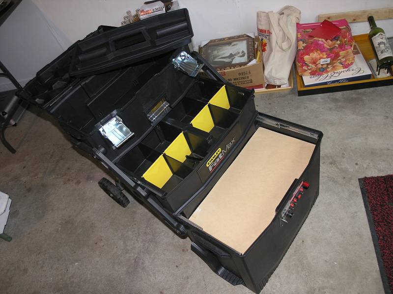

I cut a pc of mdf to fit over the jugs, great place for props and wing tubes. It pulls out easily for access to the lower area.
ID:	902812   Click image for larger version
Old 03-13-2008 | 10:45 PM
  #542
RC-Captain's Avatar
Posts: 2,981
From: RCHill, NJ
I would not advise on glow fuel being non flammable, but because you are normally fueling outside where there is enough ventilation (moving air flow), I believe thats why you have not had any incidents. Please just be careful and consult the manufactures of the fuel if needed.
CAP

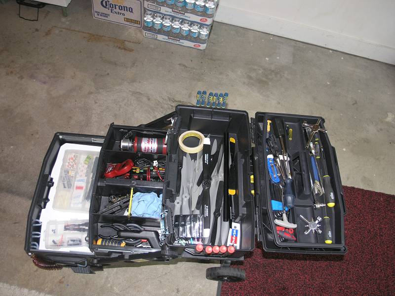

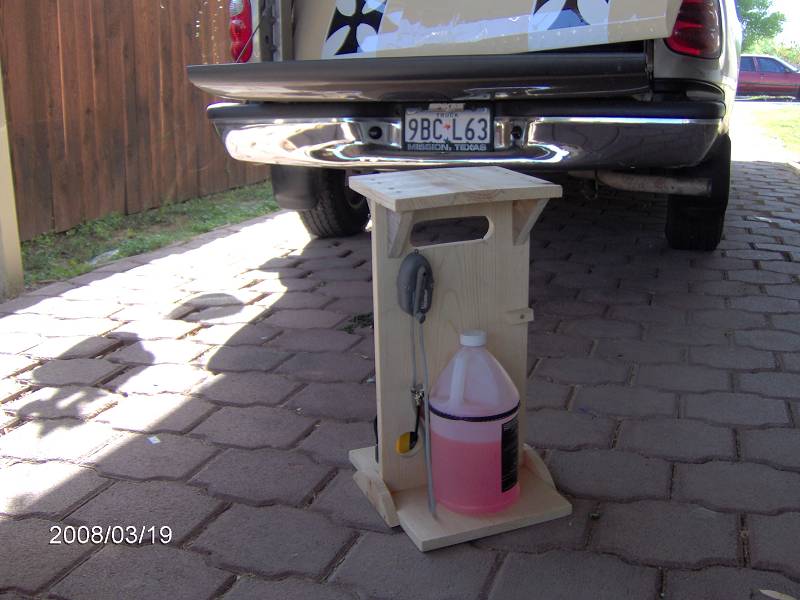

I don't have use for many tools on the line.Simple stuff.
ID:	908274   Click image for larger version
Old 03-19-2008 | 10:50 PM
  #545
Joined: Sep 2003
Posts: 521
From: Mission, TX

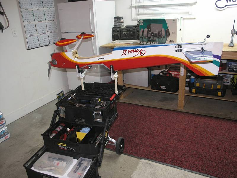

The file was too large to post the best part.
Hey Guys,
Been awhile since I last posted. I have done a bit more work on the box. The fuel pump and lines are in place and hooked up. The looping lines in the front of the box are for each of the 3 fuel jugs. one outlet is the pick up and the other is the vent line. All i have to do is disconnect one side of the loop then hook up the intake line on the pump, works great !!
Also I and going to section off the battery and vent it from the rear, just in case.
ID:	915095   Click image for larger version
