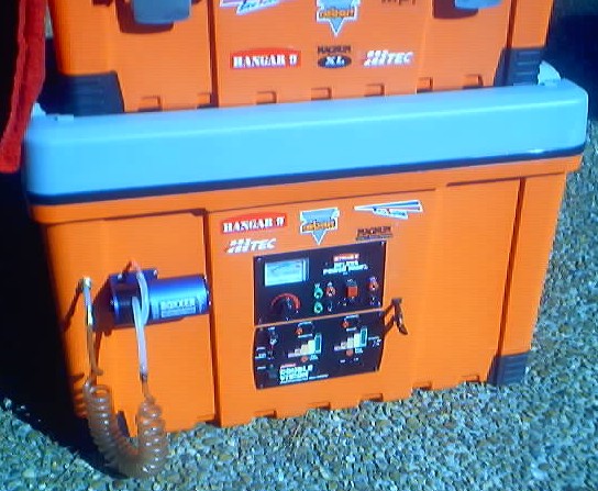

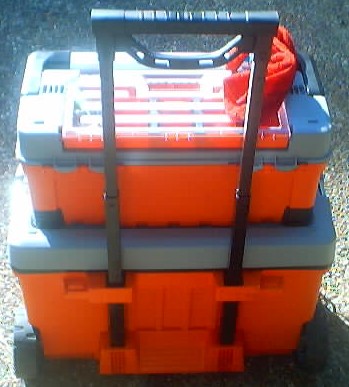

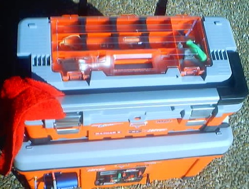

Here is the field box converted from a blackand decker tool kit called firestorm
ID:	305555   Click image for larger version
ID:	305556   Click image for larger version
ID:	305557   Click image for larger version
ID:	305558   Click image for larger version

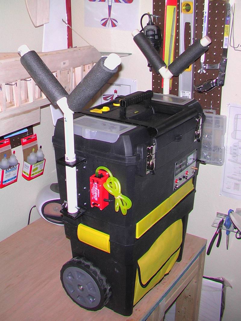

Default RE: THE FIELD BOX FROM HELL! aka The Ultimate Field box!

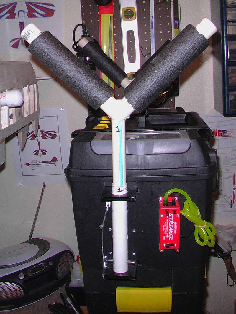

Mine is finally finished, here are some pics.
Two 50 ounce Dubro fuel tanks plumbed together, Kavan gear drive electric fuel pump, Hobbico 12v field battery and Accu-Glow MkII power panel.
ID:	306204   Click image for larger version
ID:	306205   Click image for larger version
ID:	306206   Click image for larger version
Old 08-07-2005 | 08:50 PM
  #480
horace315's Avatar
My Feedback: (15)
Joined: Sep 2003
Posts: 715
From: va beach, VA
i found them at ace hardware,they list for 44 though http://www.acehardware.com/product/i...ductId=1340672
Old 08-07-2005 | 09:15 PM
  #481
horace315's Avatar
My Feedback: (15)
Joined: Sep 2003
Posts: 715
From: va beach, VA
please Dont name this box,the way things are going now days b&d will call them field boxes and start chargin 150.00 for them shhhhhhhhhhhhhhh..........i did mine this way two years ago when they first started selling these boxes at home depot.........happy flying.

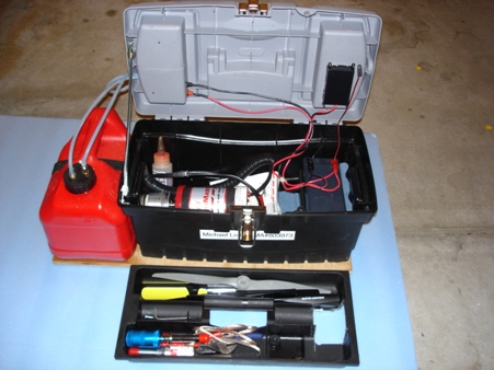

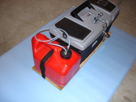

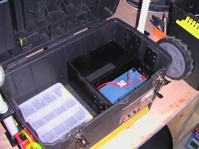

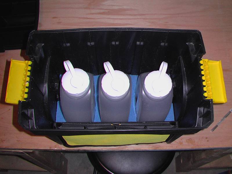

I know this thread is a bit old, but it inspired me to build my own ultimate field box and now it's nearing completion. I purchased the Wal-Mart/Stanley brand rolling toolbox on sale for $19.95. The construction was pretty straight forward except for the custom made PVC "Y" connectors. Turns out the they don't make Y's that small so I had to modify (that's my name ) two 90 degree elbows and secure them to with thick CA and #8 screws.
I'm building a Super Skybolt with smoke, so I needed a field box to pump/carry smoke oil and glow fuel as well. This was solved using an OR switch from Radio Shack to toggle between the smoke and glow pumps. The fuel jugs are the same 64oz Rubbermaid juice containers that everyone else is using in this post: one is for smoke, one is for 2 stroke fuel, and the last is for reserve 2-stroke/4 stroke fuel. All that remains is to run the plumbing from the fuel jugs to the pumps and make a lid for the battery conpartment.
Thanks for the inspiration!
Mods
And now the pics:
ID:	408475   Click image for larger version
ID:	408476   Click image for larger version
ID:	408477   Click image for larger version
ID:	408478   Click image for larger version
ID:	408479   Click image for larger version

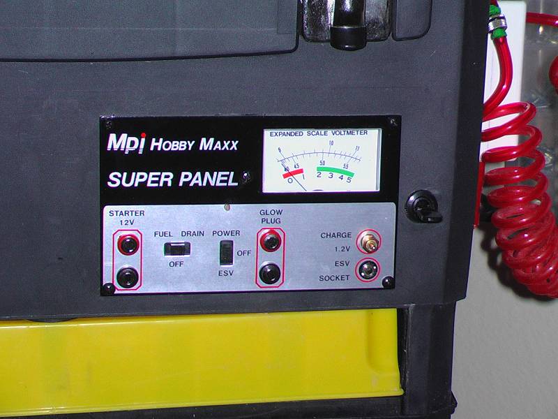

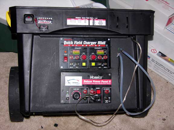

I have the same tool box that I turned into my field box. Im basicly using the whole top part to tote my transmitter and starter and my tools on the removable tray.. As you can see i made a master switch which turns everything off and on. When i first built the fieldbox i noticed it was a pain to pull around in grass since it had like no ground clearance. So upon studying the orginal design how how the wheels were attached, i noticed i could just pull the whole wheel off. I pulled both wheels off and reversed how they fit in the slot. It then raised the box about another inch or so. Since the wheels were sitting higher i had to put some small "legs" in front which is screwed into the bottom.
Had lots of troulbe with the hobbico fuel pumps so i went to the junk yard and stole a windshield washer pump off an old 80's volvo. Which is also a geard pump like the pumps at the LHS so i can put fuel in and suck the fuel back out of the plane.

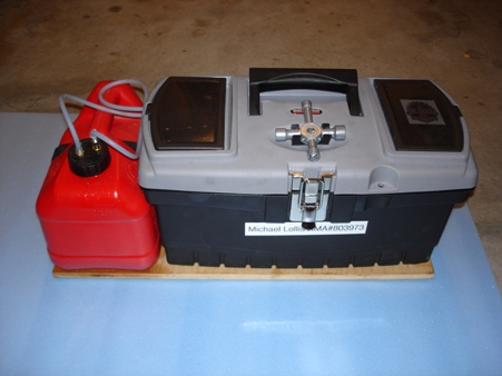

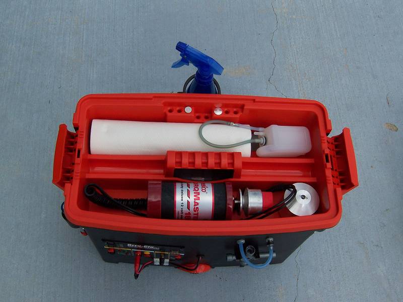

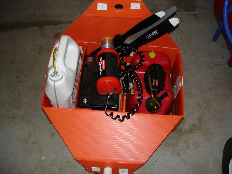

Here is my contribution. More on the smaller size, but with the same idea in mind, converting a tool box into a flight box. Fuel pump in one side and a micro power panel in the other.
Later,
Omaha

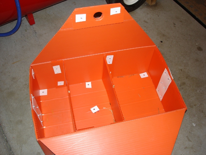

Since I'm a S.P.A.D. guy, I couldn't leave out my Gasser flight box made out of coroplast.
Later,
Omaha
